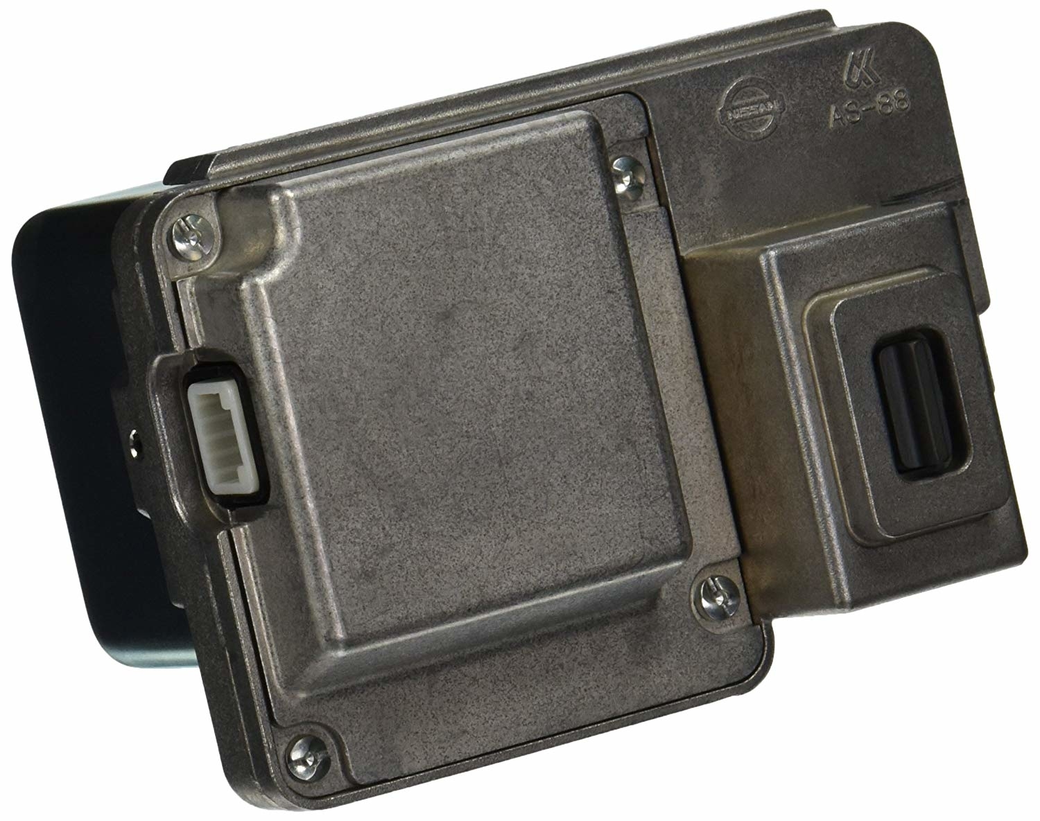

I'm trying to find the ignition switch module for my car but unable to find it. Would it be part of the BCM?

The module is behind the dash, it contains the key slot the intelligent key is inserted into. That module talks to the instrument cluster and the BCM on the data bus. No activity when the button is pushed, with the security light flashing means the system does not recognize the transponder in the key.
The system works using the module to send out a signal pulse from the module. That pulse is enough to "power" the transponder chip in the key and it returns a signal the module receives and it then compares that information with the stored key information. If the items match the system is commanded to start. If the information is not correct, either through an incorrect key or the signal not working you get the flashing security light.

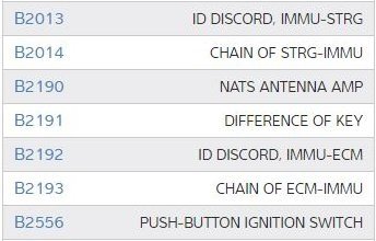

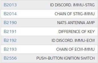

The first thing to do would be to use a dealer level scan tool to query the immobilizer for any stored codes such as the ones listed in the table attached. Then proceed from there. I would not even start taking thins apart without testing, that module is close to $600.00 so testing first could save a lot of money if it turned out to be a wiring issue or something else.
