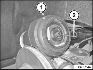

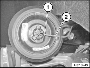

Remove rear wheel
Pic 1

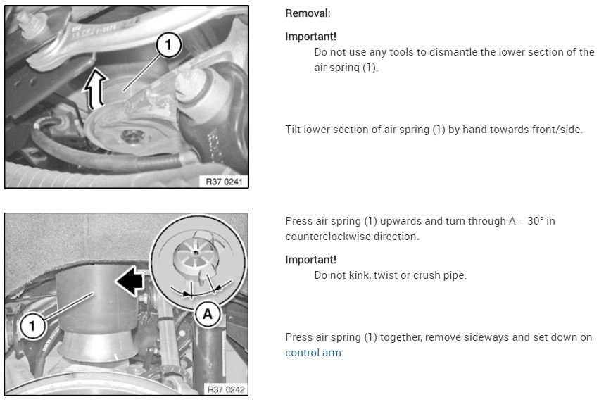

Removal:
Important!
Do not use any tools to dismantle the lower section of the air spring (1).
Tilt lower section of air spring (1) by hand towards front/side.

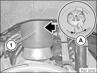

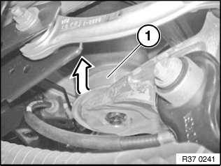

Pic 2
Press air spring (1) upwards and turn through A = 30° in counterclockwise direction.
Important!
Do not kink, twist or crush pipe.
Press air spring (1) together, remove sideways and set down on control arm.

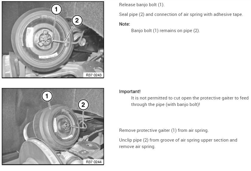

pic 3
Release banjo bolt (1).
Seal pipe (2) and connection of air spring with adhesive tape.
Note:
Banjo bolt (1) remains on pipe (2).

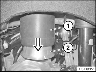

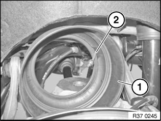

Pic 4
Important!
It is not permitted to cut open the protective gaiter to feed through the pipe (with banjo bolt)!
Remove protective gaiter (1) from air spring.
Unclip pipe (2) from groove of air spring upper section and remove air spring.

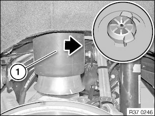

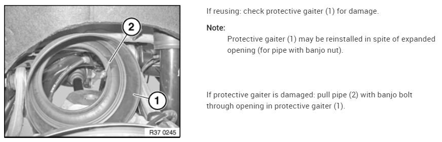

Pic 5
If reusing: check protective gaiter (1) for damage.
Note:
Protective gaiter (1) may be reinstalled in spite of expanded opening (for pipe with banjo nut).
If protective gaiter is damaged: pull pipe (2) with banjo bolt through opening in protective gaiter (1).

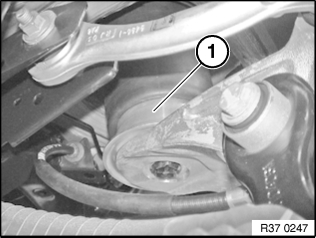

Pic 11
Important!
Do not use any tools to install the lower section of the air spring (1).
Press lower section of air spring (1) by hand into wheel carrier until it can be seen and heard to snap into place.

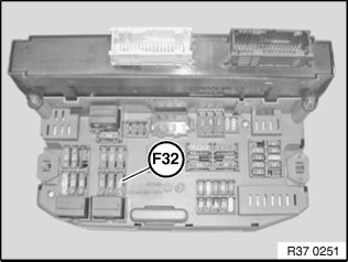

Pic 12
Deactivating air suspension system:
Fold down power distribution box in passenger compartment
Pull out fuse (F32) for air supply system
Pic 13

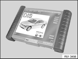

Draining air spring system:
Connect BMW diagnosis system
Switch on ignition.
Drain air springs with the aid of the BMW diagnosis system (control unit function, menu item ”Bleeding procedure for air springs”)
Note:
Depending on the output pressure in the air spring, it may be necessary to repeat the service function "Bleeding procedure for air springs."
(See functional description of the "brake bleeding procedure - air spring" in the BMW diagnosis system.)
