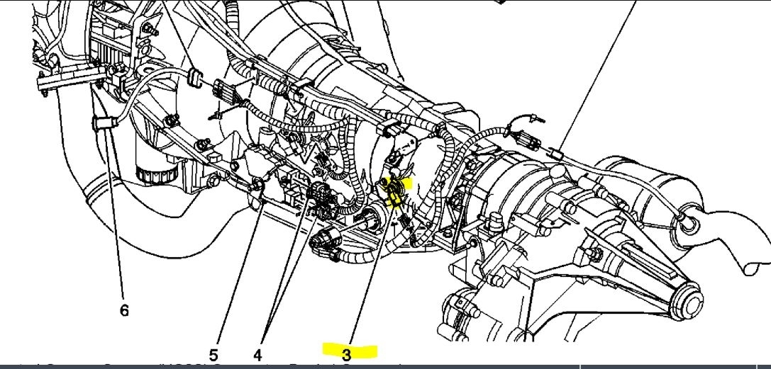

Hi:
It sounds like a vehicle speed sensor (VSS) issue. What codes were present that were cleared?
The speed sensor is located on the transmission. I attached a picture of its location for you. If you can provide the codes that were cleared, it will help me determine if this is the issue.
