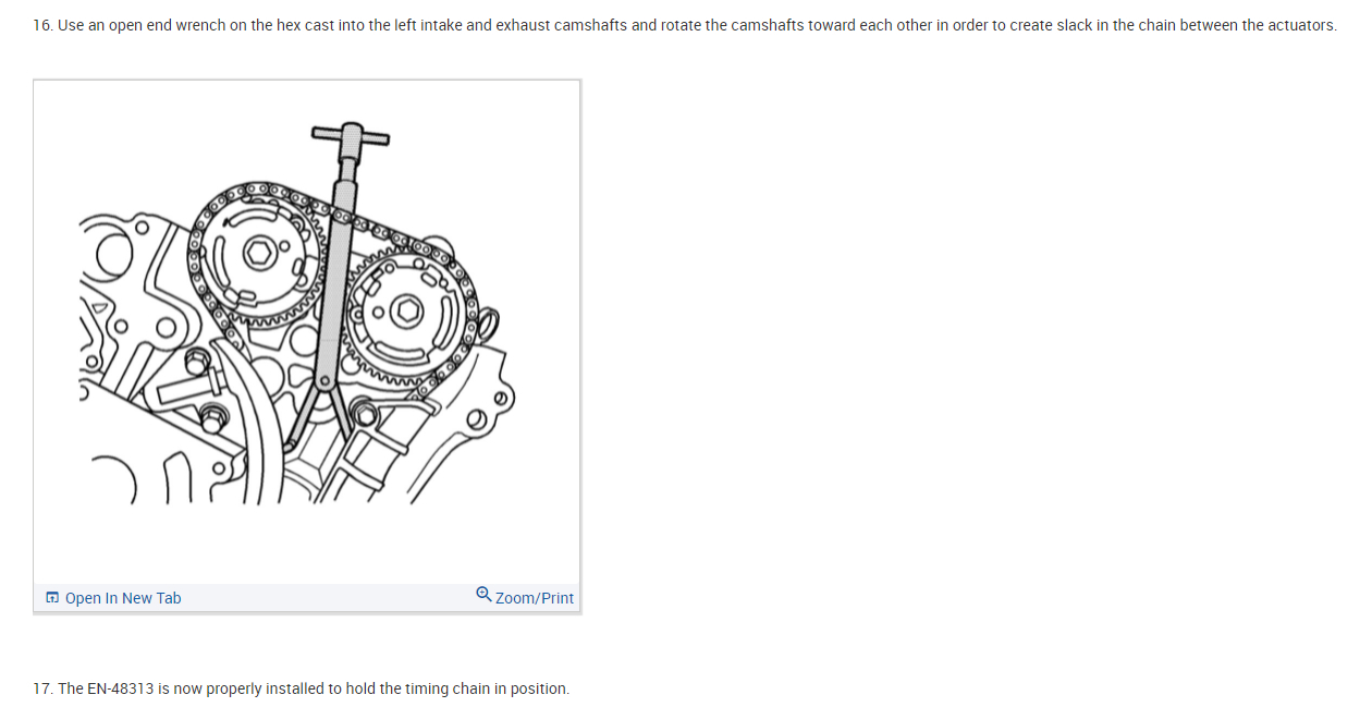

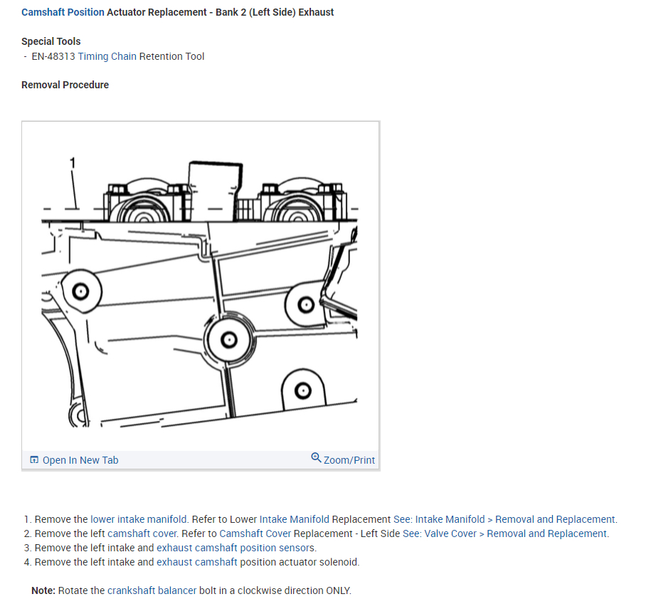

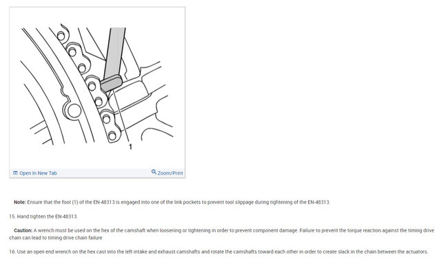

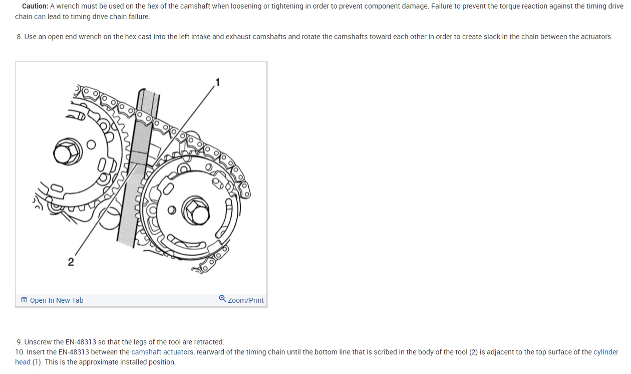

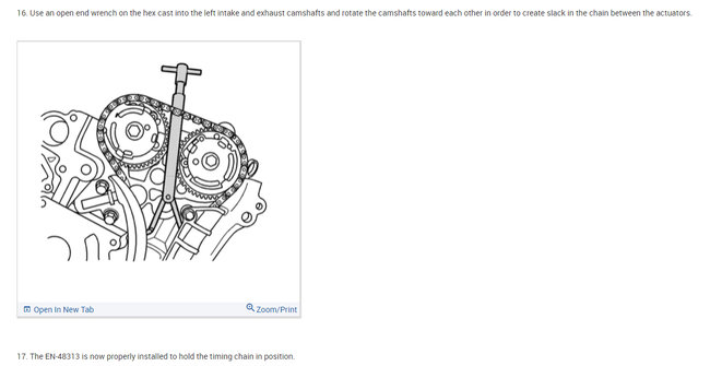

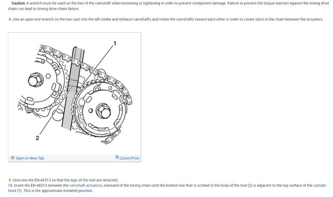

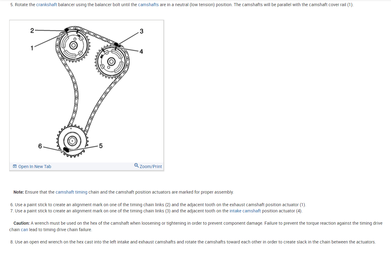

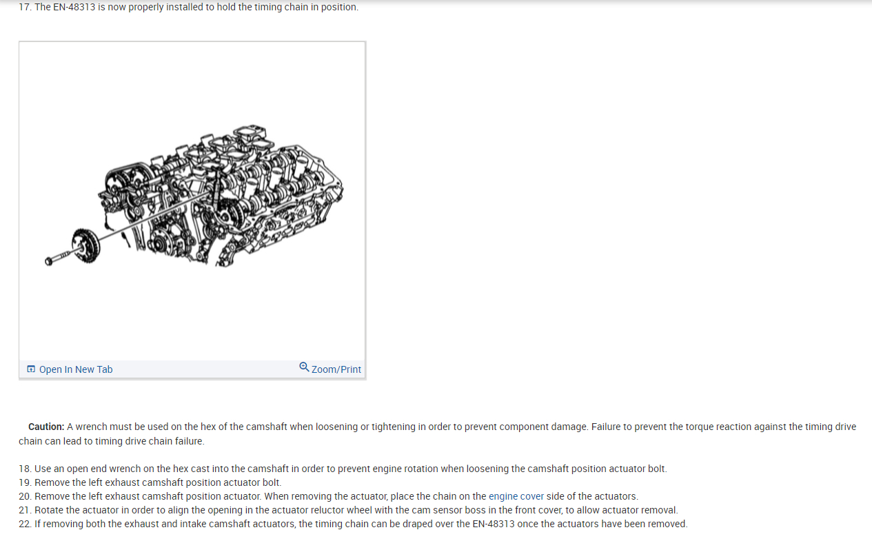

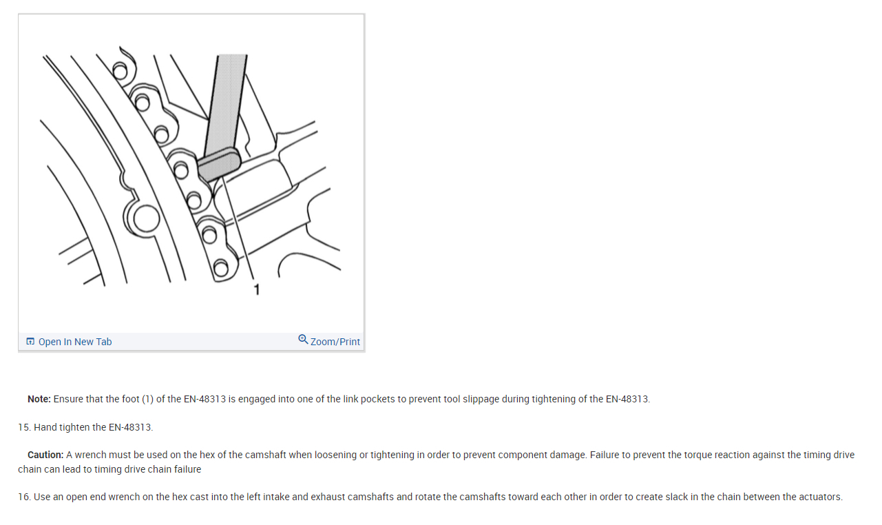

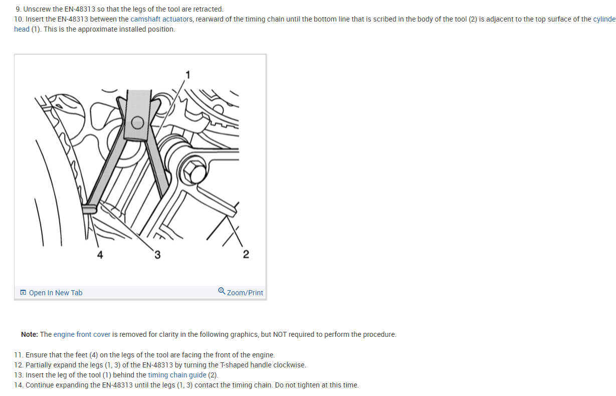

Good evening,
This code could be the actuator solenoid that has failed or the screen on the end is clogged with debris. I attached a flow chart for you to view.
I attached the flow chart for the 24 code for you.
Follow the chart and let me know the results.
