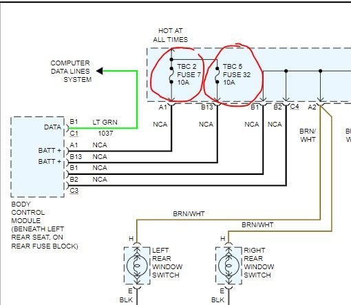

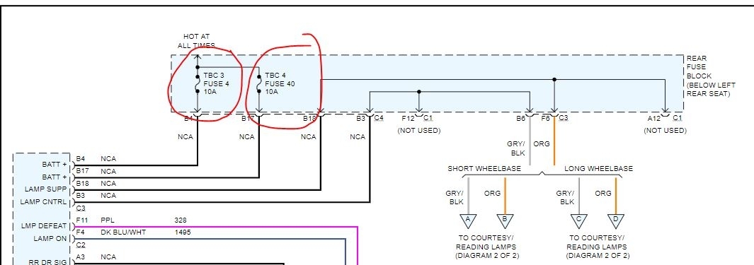

I've changed the dimmer switch. none of the lights are out as the parking brake turn signals, but none of my illumination lights are working. like my cluster lights, door, window lights, or my a/c lights. checked fuses in two fuse boxes and still haven't solved the problem.
