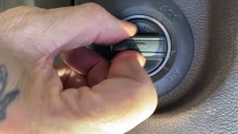

Australian Nissan Pathfinder 2011.
It has a smart key where I don’t need to insert key into barrel to turn on/off but there is a key for emergencies.
The ignition knob will not turn to lock. I can turn the car off but there is a lock position to lock the steering wheel.
I’ve put car into park, put my foot on brake, jiggled the steering wheel and only sometimes the ignition will go to lock.
