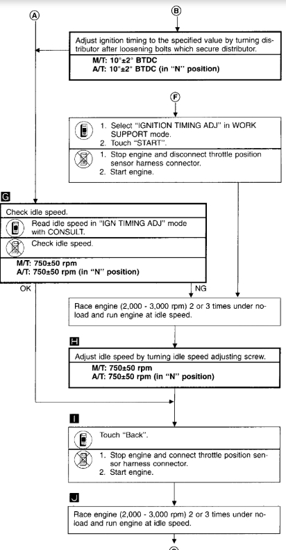

Sure here is a guide to help you and the timing balancer so you can see what to adjust it to. Check out the images (below). Please let us know what happens.
