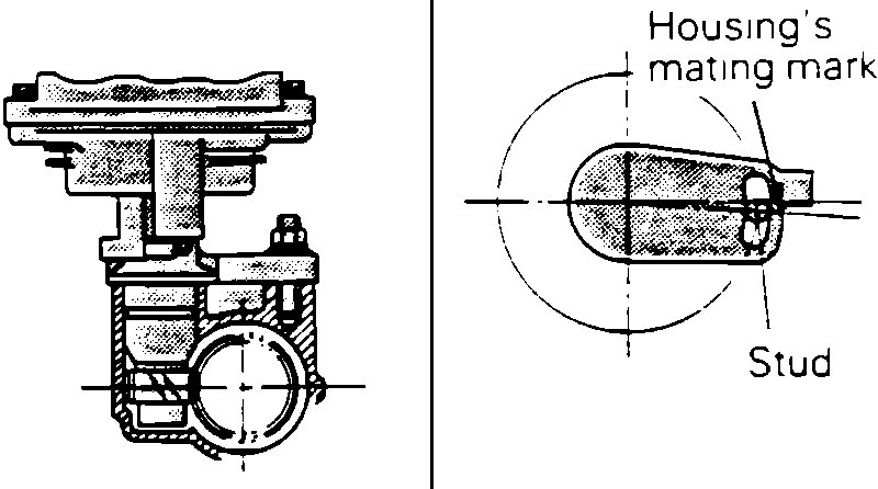

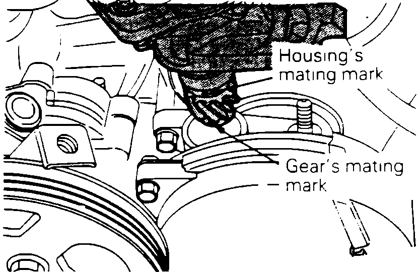

1. Turn the engine so that the piston of the number one cylinder is at top dead center of the compression stroke.
CAUTION: Care should be taken to insure that the number four cylinder is not used by mistake.
2. Align the distributor housing and gear mating marks.
3. Install the distributor into the engine while aligning the distributor's installation flange with the center of the distributor installation stud.

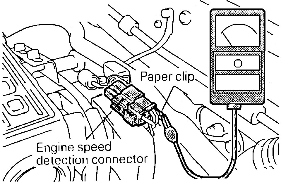

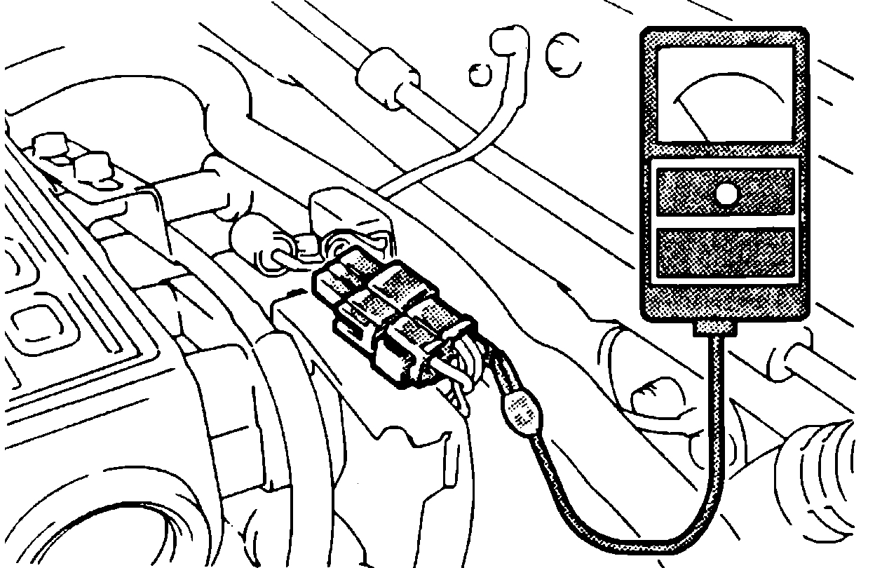

Tachometer Hookup
pic 3
1. Install a paper clip into the tachometer check connector.
2. Connect a tachometer to the clip.

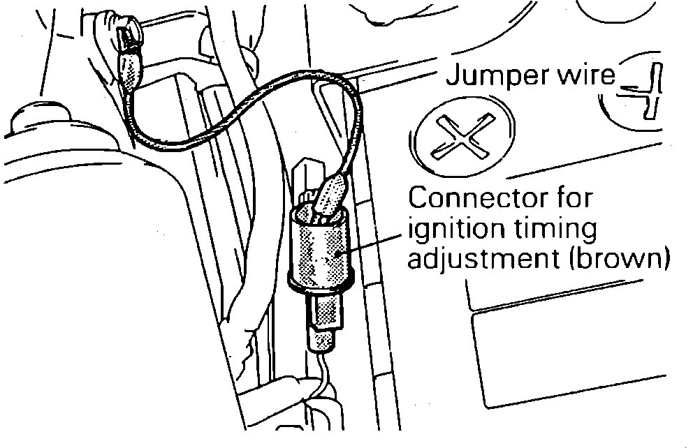

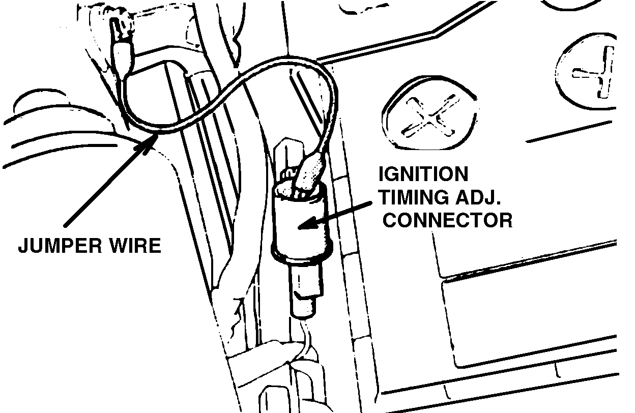

Ignition Timing Adjustment Connector
pic 4
3. With the engine OFF, ground the ignition timing adjustment terminal with a jumper lead.
4. Start the engine and allow it to run at curb idle speed.
5. Connect a timing light to the #1 spark plug wire and check the timing.
Basic Ignition Timing
5° ±2° BTDC.
6. If necessary loosen the distributor mounting nut and adjust timing by rotating the distributor.

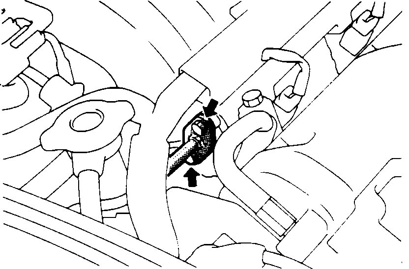

Tachometer Connection Using A Paper Clip
pic 5
1. Insert a paper clip into the 3-pin connector from the harness side of the connector. Do NOT disconnect the connector.
2. Connect a primary-voltage-detecting tachometer to the paper clip.
NOTE: The tachometer should indicate 1/3 of the actual engine speed. Multiply the tachometer reading by 3 for the actual engine speed.

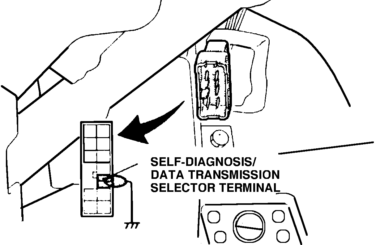

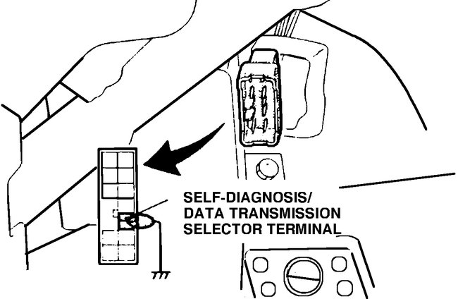

Self-Diagnostic Connector Grounded (under dash drivers side)
pic 6
3. Using a jumper wire, ground the # 10 terminal of the Self-Diagnosis connector.

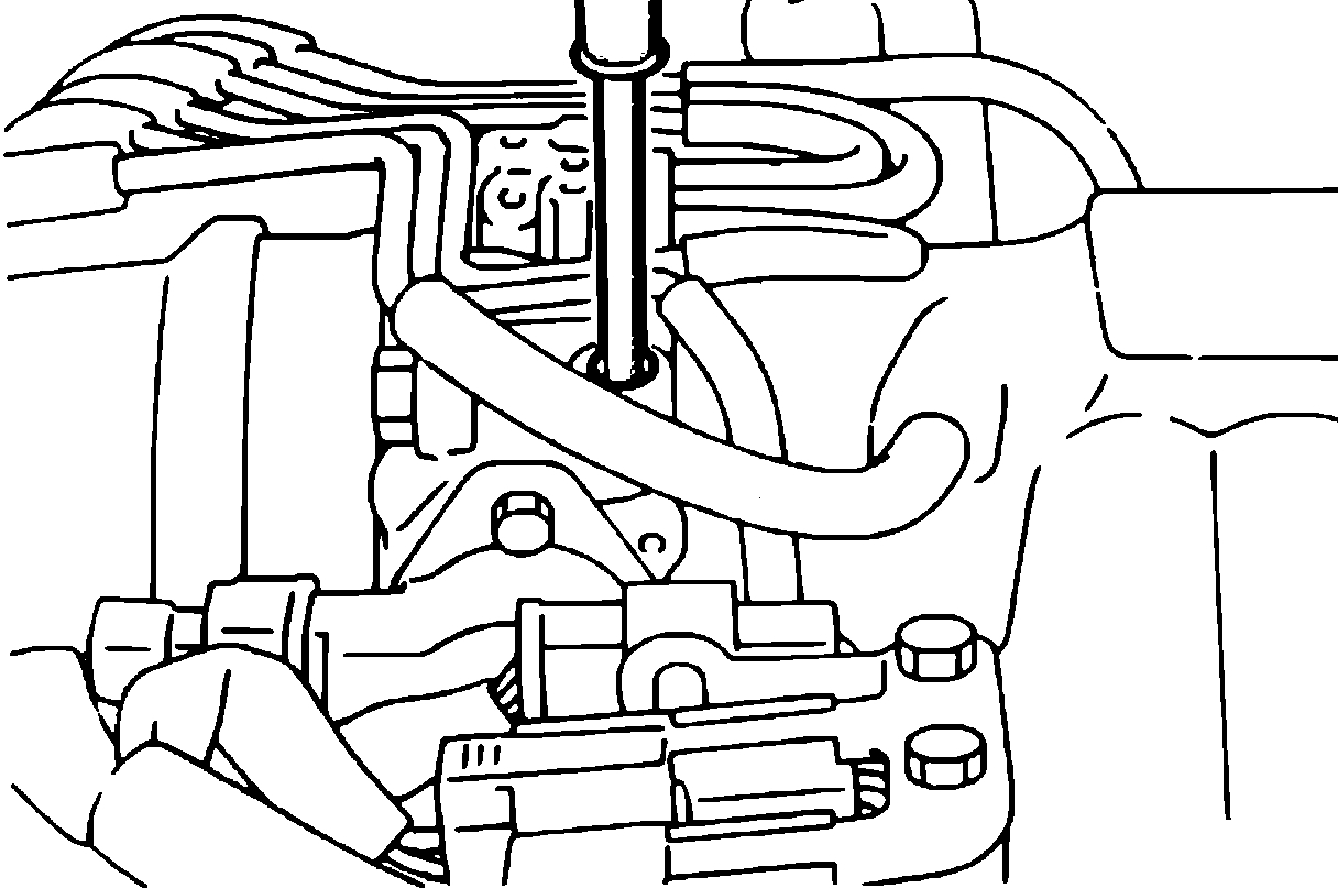

Adjusting The Idle Speed
pic 8
If none of the above conditions apply, then turn the speed adjusting screw until the engine is running at 700 +/- 50 RPM.

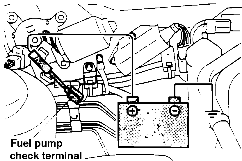

Fuel Pump Operational Test Hook-up
pic 1
2. Apply battery voltage to the fuel pump drive connector to power the fuel pump.
3. Pinch the fuel hose to check that fuel pressure is felt.
NOTE: The fuel pump is mounted in the fuel tank and it operates submerged in fuel, therefore its operating sound is hard to hear without removing the fuel filler cap.

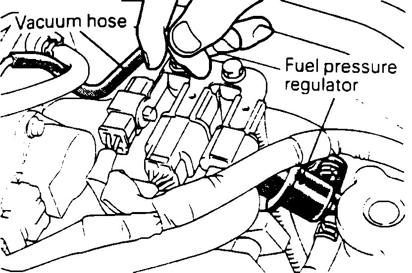

High Pressure Fuel Hose Connection
pic 2
2. Disconnect the high pressure fuel hose at the delivery end.
CAUTION: Cover the hose connector with a shop towel to prevent splashing of fuel caused by residual pressure in the fuel line.
Fuel Pressure Gauge Installed
pic 3
3. Using the fuel pressure gauge adapter (MB998742) or equivalent, install the fuel-pressure gauge to the delivery pipe (fuel rail).

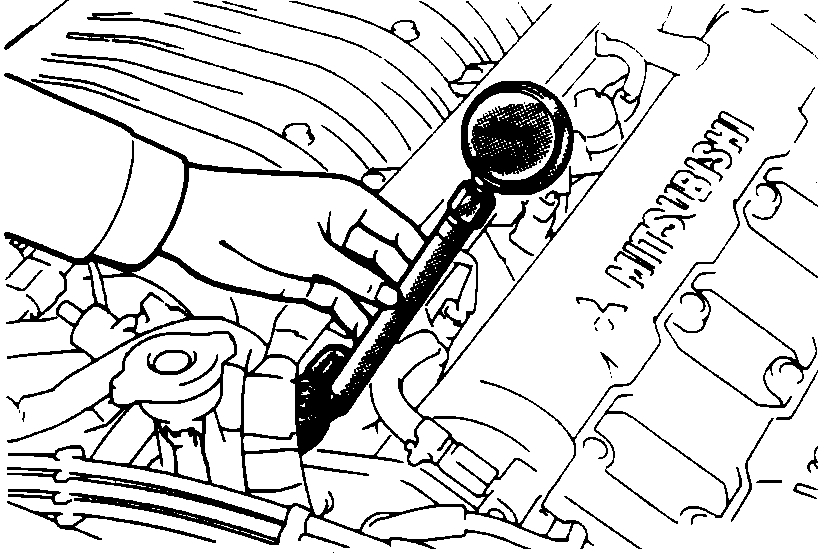

5. Apply battery power to the fuel pump drive terminal to activate the fuel pump. With fuel pressure applied check that no fuel is leaking at any of the connections.
Fuel Pressure Regulator, Vacuum Control Line Removed
pic 4
6. Disconnect the vacuum hose from the pressure regulator, and plug the hose end. Measure the fuel pressure at idle.
