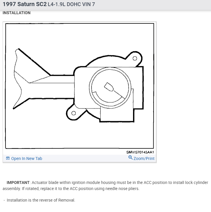

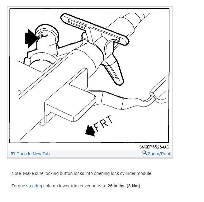

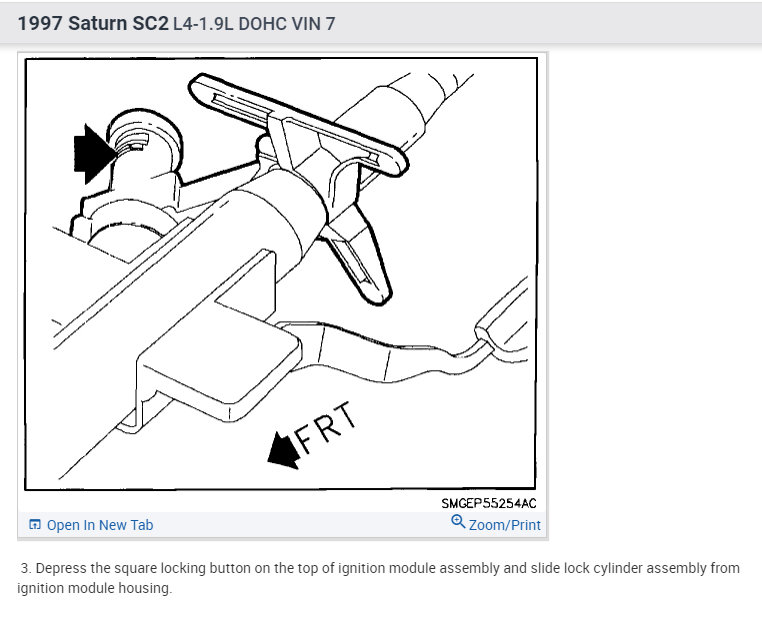

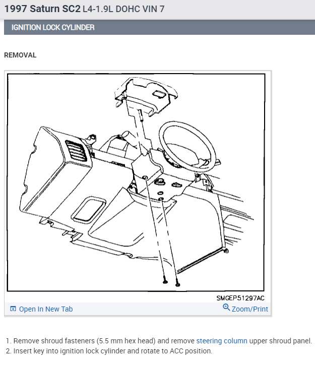

Can you upload the picture of those rivets in question?
The replacement procedure does not call for anything like that.
See attached for the replacement steps.
Let me know of any questions.
