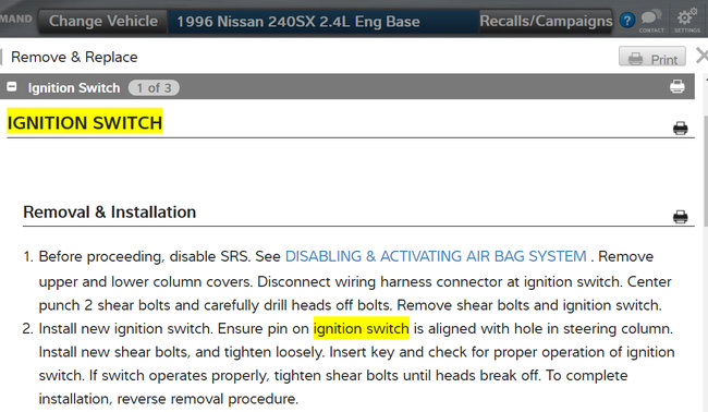

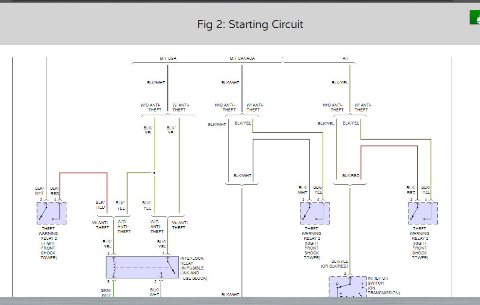

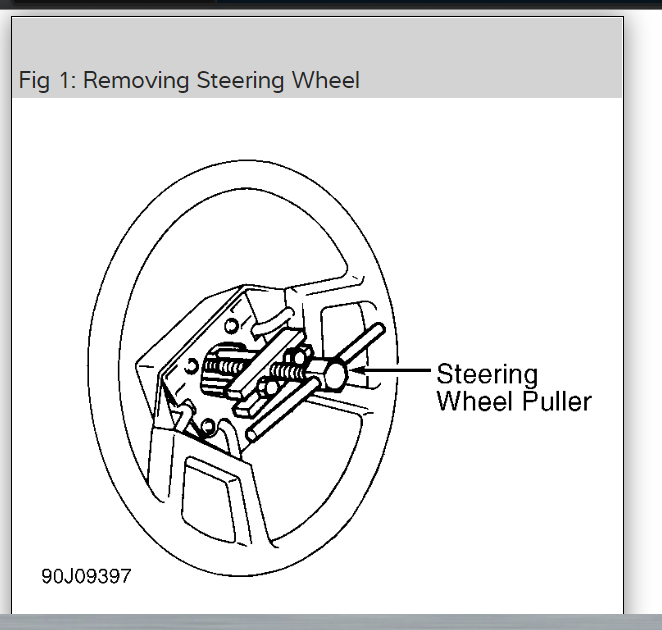

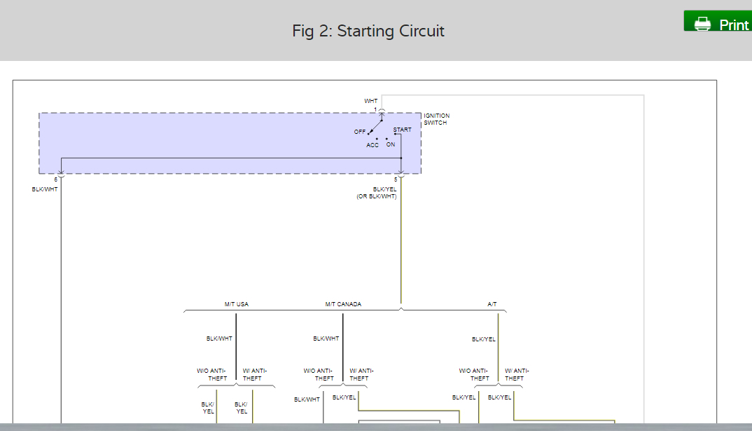

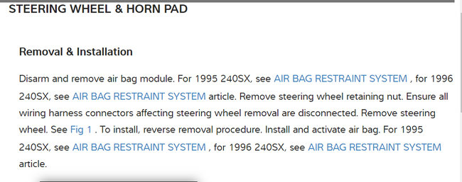

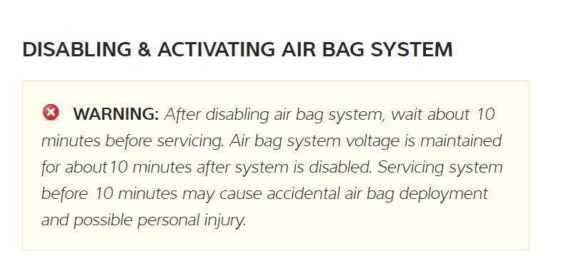

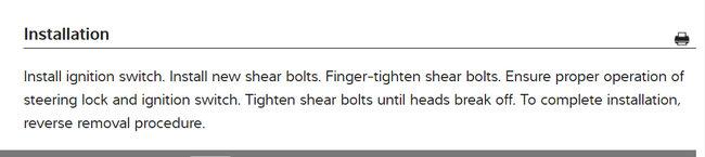

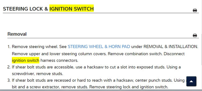

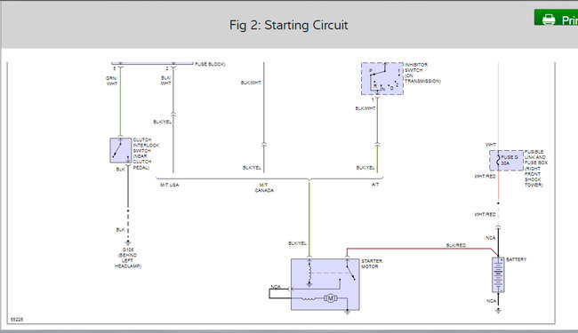

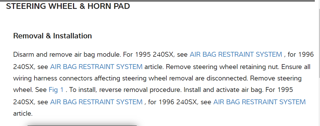

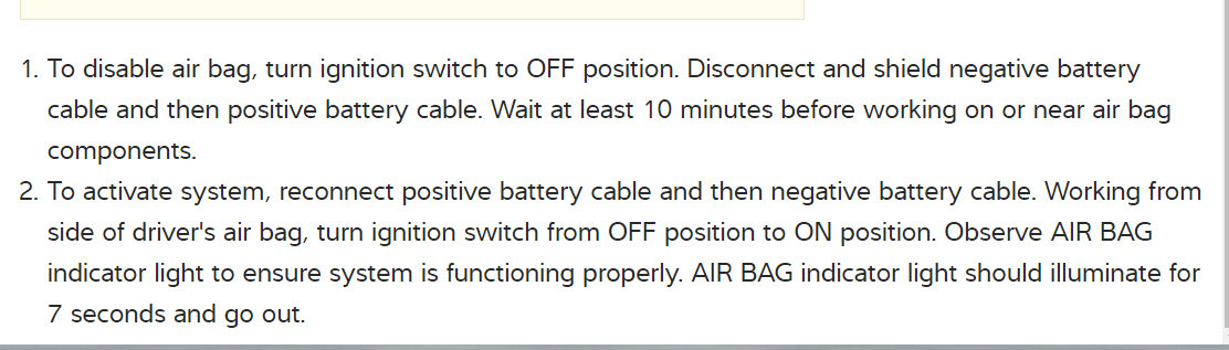

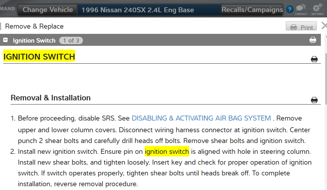

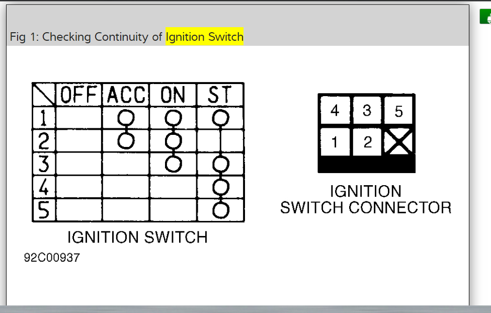

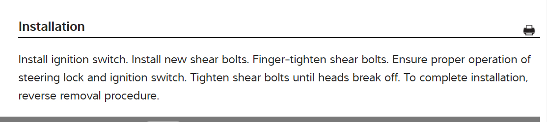

This sounds like you could have a problem with your vehicle's ignition switch. In the diagrams down below I have included instructions for troubleshooting your vehicle's ignition switch. You will need to do a continuity check and you will need a multimeter to do this. I have included a link below if you are not familiar with how to use one.
Please go through this guides and get back to us with what you find out.
