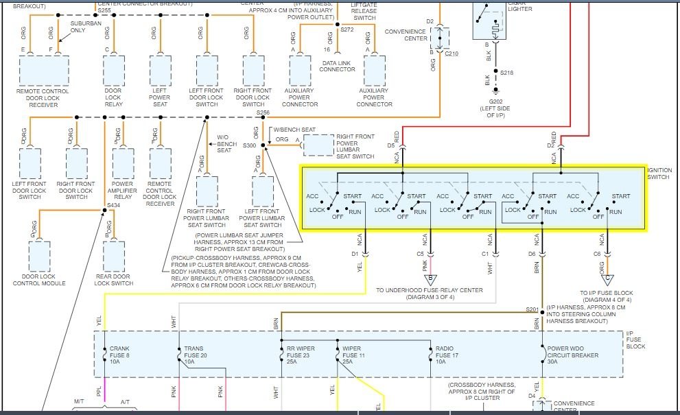

So I got the security issue resolved but Im back at square 1 again. I have 7.5 volts on the orange brown and red, 13.5 on the pink and white and 0.0 on the yellow at the switch and 7.5 on the whole right half of the fuse block. This would be all too easy with a wiring diagram but my chiltons doesnt cover this and my factory service manual on disc has a VMware error I cant solve either. Ideas or a PDF diagram maybe? Thanx!
Jul 24, 2019 at 7:42 PM

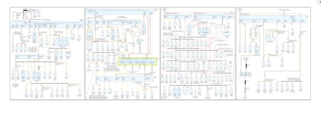

Diagram attached for you to view.

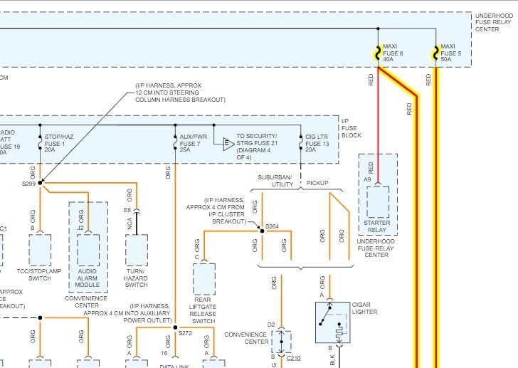

Thank you very much Roy. Would it be possible to get a shot of where the right hand red wire that feeds the orange and brown originates? That is my bad feed circuit.
Jul 25, 2019 at 7:13 PM

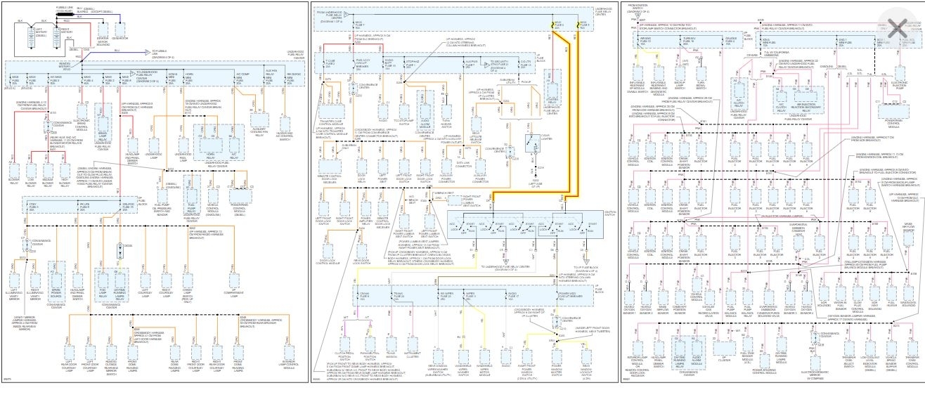

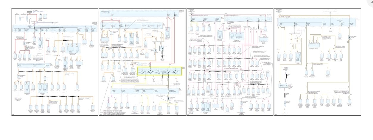

They come from the main fuse block. I attached the diagrams for you.

Sorry it took so long to update. In the end the 40 amp fuse for that circuit was blown. Obviously I wasnt looking for a blown fuse as one would think Id have 0 voltage but I had 8 volts. Clearly I was getting a back feed from somewhere and to this moment I have no idea where. The diagram does not show a possible back feed source and the main box has no way to back feed so it must be coming through the ignition switch though I dont see how as the circuits on that side of the switch are isolated from the others on the other feed. Maybe you can see something I dont. Thanx Roy. And bye the way that was 8 volts under load. It was 12 volts load free. I am going to monitor the voltage and yank fuses to see which circuit is feeding it.
