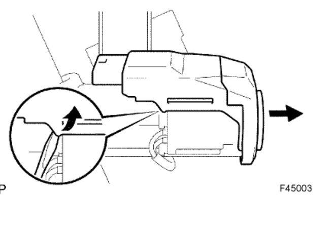

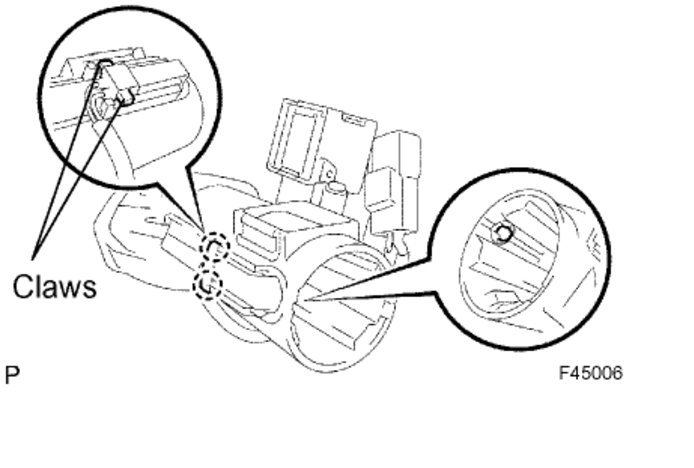

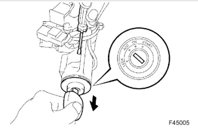

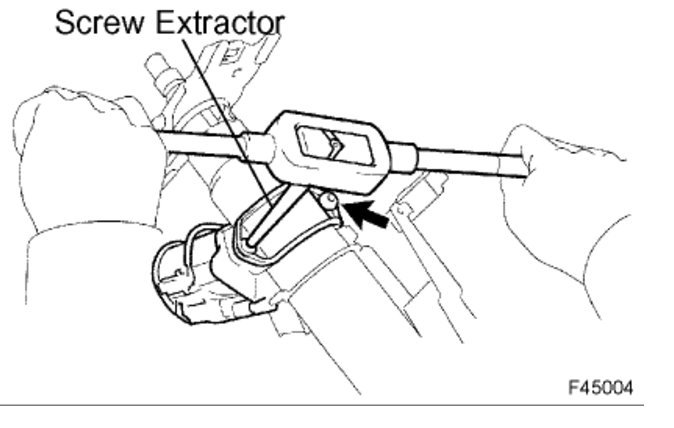

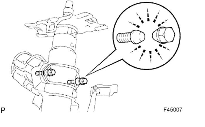

It sounds like the tumbler has gone bad which is common for your cars age. You can get the replacement from Amazon for about $60.00
https://www.amazon.com/gp/product/B000E671FM/ref=as_li_qf_sp_asin_il_tl?ie=UTF8&tag=2carprcom-20&camp=1789&creative=9325&linkCode=as2&creativeASIN=B000E671FM&linkId=444738586a16b2aa0de1e6cd2eb3eda6
The only tough part will be getting out those rivets but if you use a sharp chisel and dig in from the side to loosen it will not be to bad.
