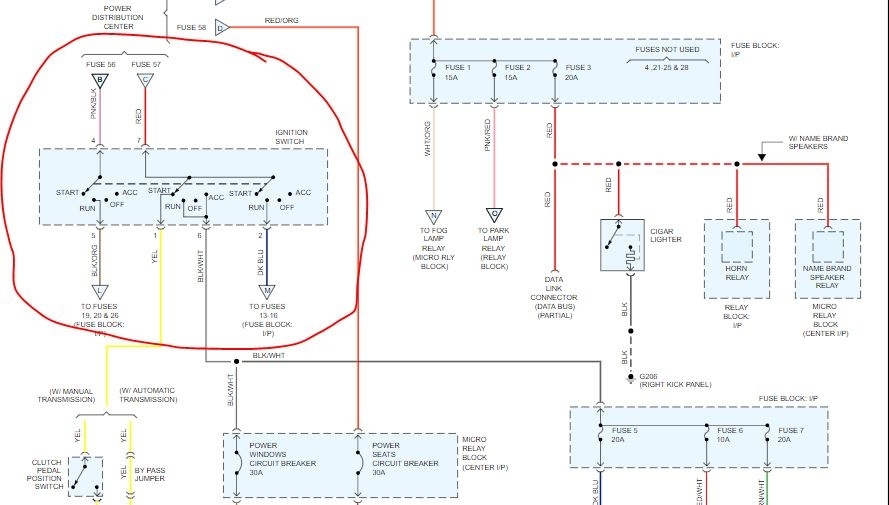

Ignition switch and lock have been replaced apx 4 to 5 times. Last time both of them from knects. Seams this time the spring back is gone. I put a hot wire the first time this happened so I could start the start the van. So I was able to start the van. Van is a SE model. Would like to know how to by pass entirely. I'm an electrian. A scamatic of how to do would be great.
