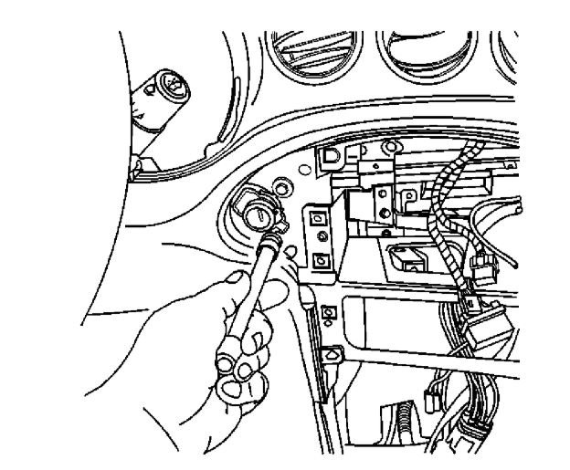

2. Remove the instrument panel (I/P) accessory trim plate.
3. Remove the I/P cluster.

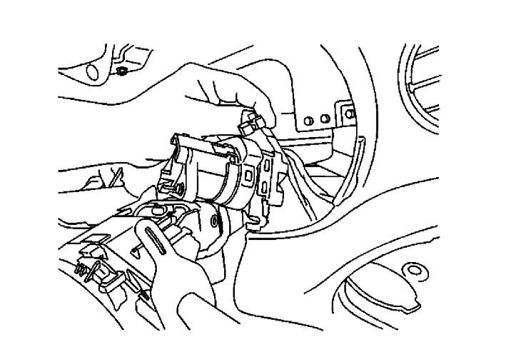

4. Remove the bolts from the ignition switch.
5. Reposition the ignition switch for ease of removal.

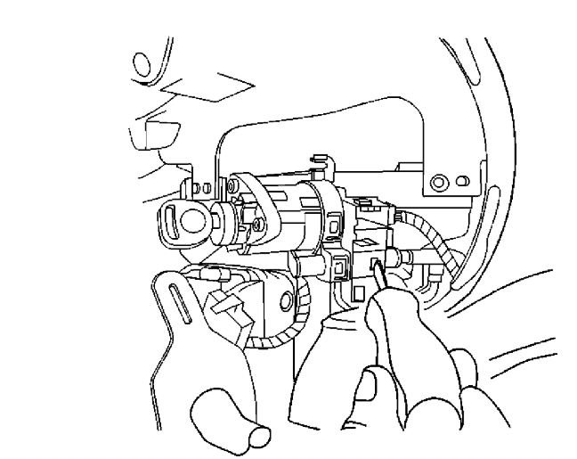

6. Insert the key and turn the ignition lock cylinder to the ON/RUN position.
7. Press the transaxle park/lock cable retainer to release the retainer, then pull to remove the park/lock cable from the ignition switch.
8. Remove the lock cylinder from the ignition switch:
8.1. Depress and hold the ignition lock cylinder detent.
8.2. Turn the key to the ON/RUN position.
8.3. Pull the ignition lock cylinder out with the key.

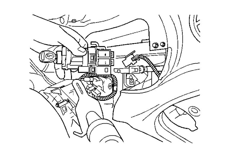

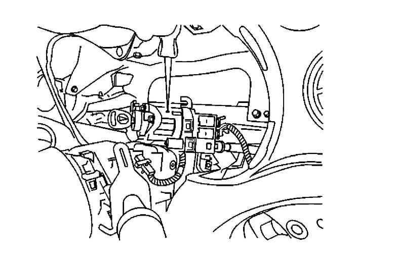

9. Disconnect the Passlock electrical connector from the ignition switch.
IMPORTANT: Remove the ignition lock cylinder before you remove the Passlock electrical connector.

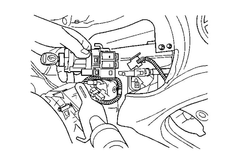

10. Disconnect the electrical connectors from the ignition switch.
11. Remove the ignition switch through the I/P cluster opening.
