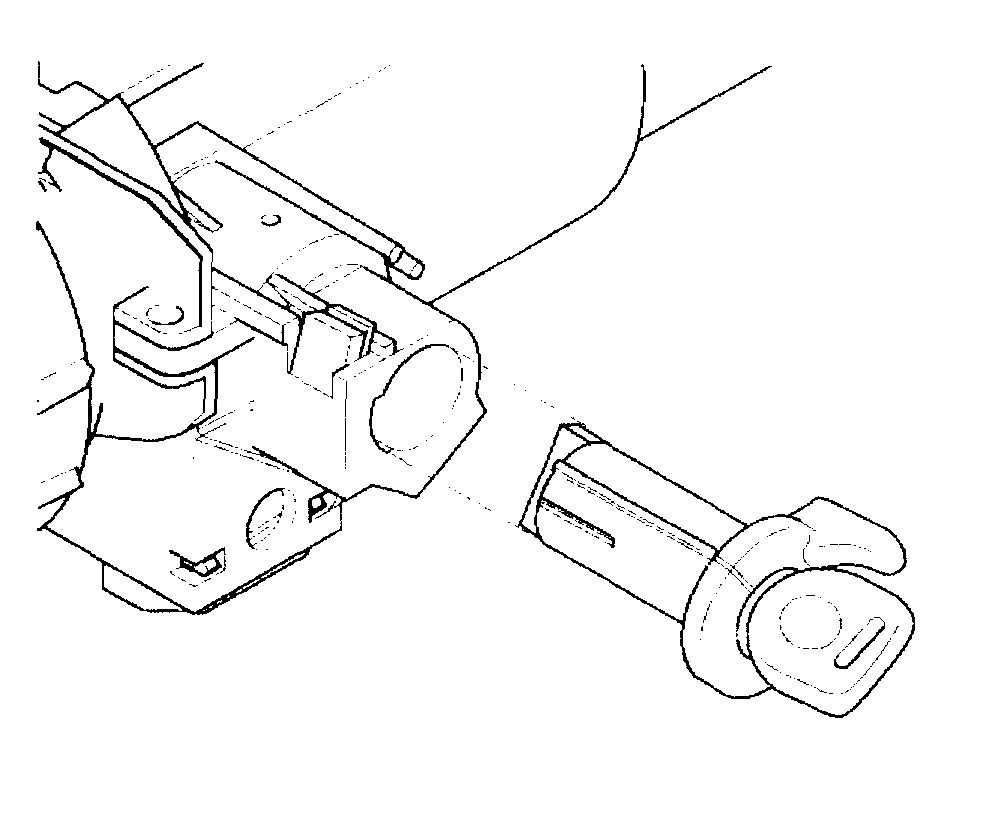

Take a look through these directions. They explain the directions for replacing the tumbler/switch. I believe you already replaced these parts, but check to see if there are any parts you missed. The attached pics correlate with the directions.

pic 1
1. Disconnect the negative battery cable.
Caution: Refer to SIFI Caution in Cautions and Notices.
2. Disable the SIR system.
3. Remove the hush and knee bolster.
4. Remove the steering column trim covers.

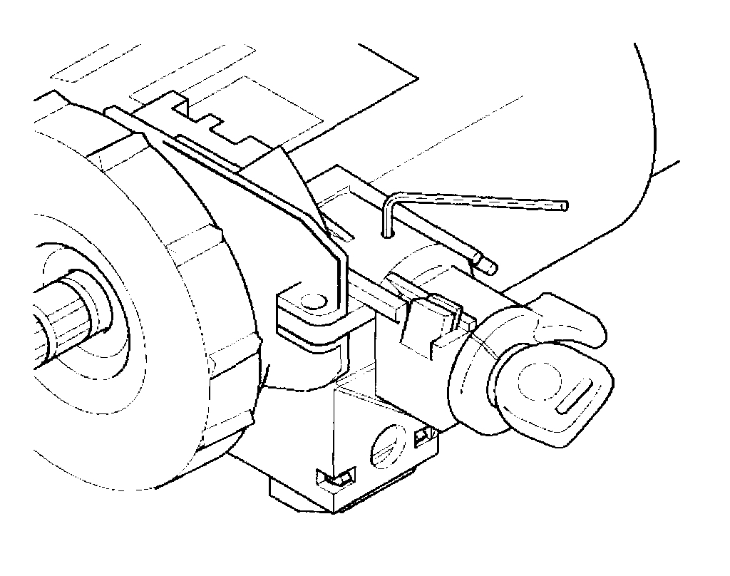

5. With the key installed, turn the key to the RUN position.
6. Install an alien wrench into the hole on top of the lock cylinder housing.
Push down on the alien wrench to release the tab on the lock cylinder inside the lock cylinder housing.

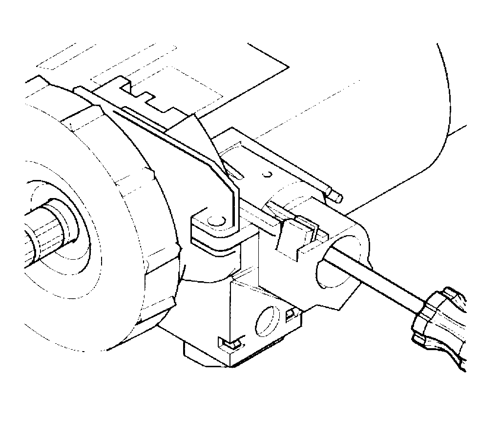

pic 2
7. Slide the lock cylinder out of the lock cylinder housing.
8. Disconnect the PASSLOCK and key buzzer from the lock cylinder housing.

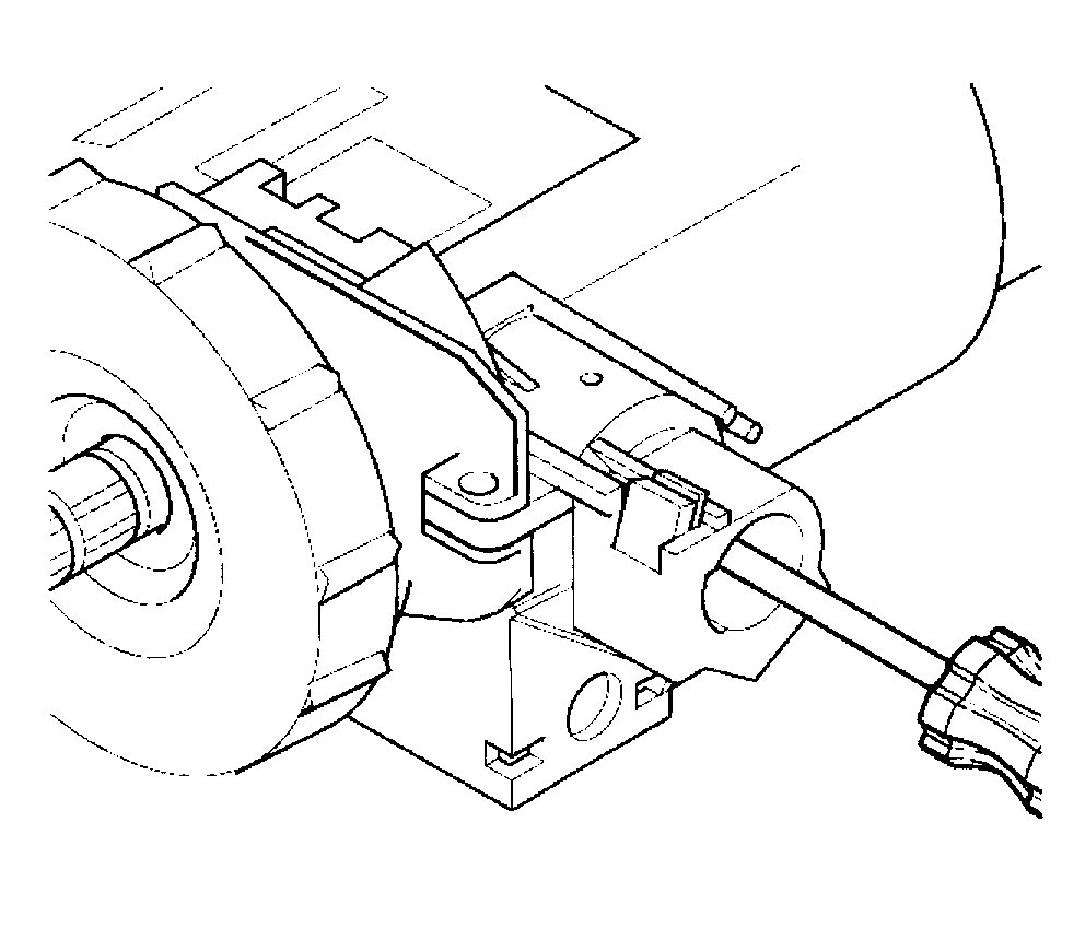

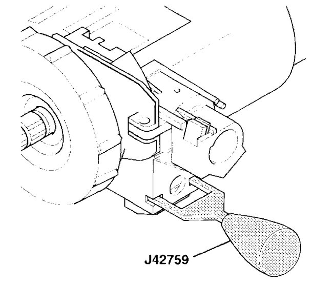

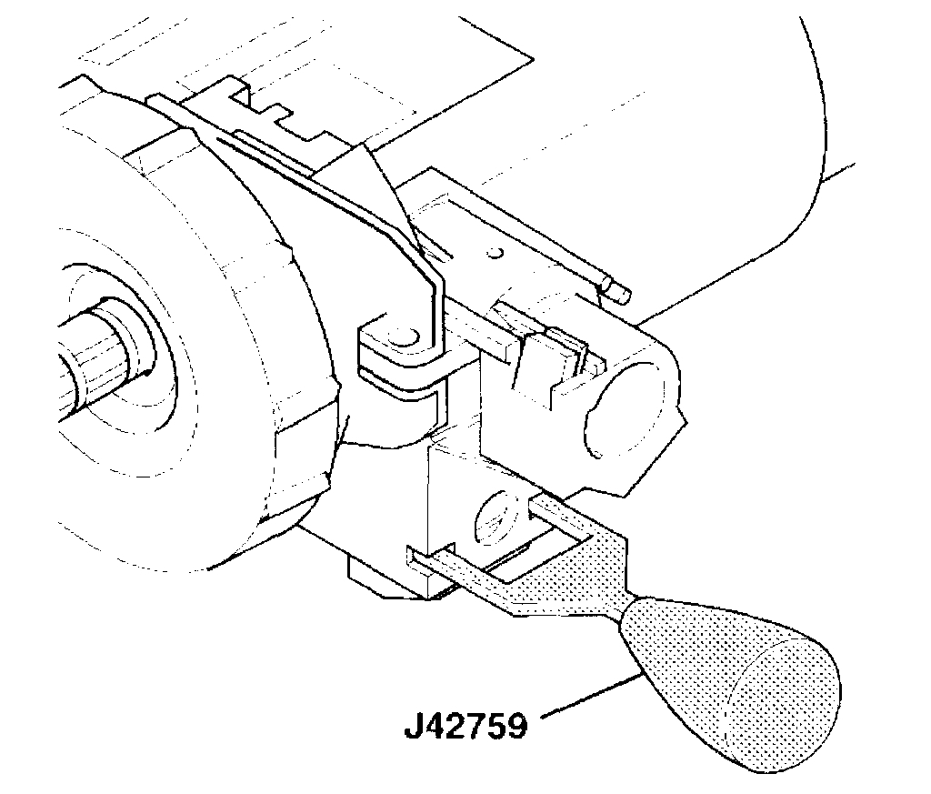

pic 3
9. Insert J 42759 into the lock cylinder housing to release the tabs on the ignition switch.
10. Pull the ignition switch out of the lock cylinder housing.
11. Disconnect the connector from the ignition switch.

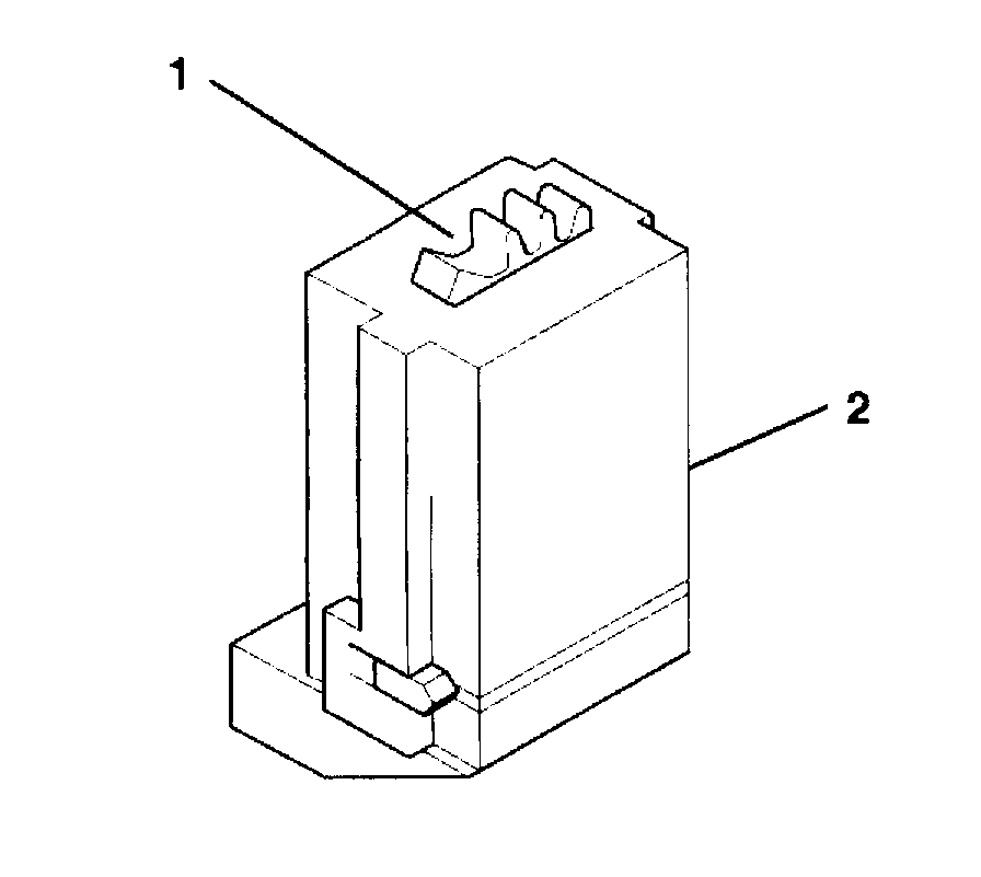

Important: The gears between the ignition switch and the lock cylinder housing must be in the correct position. Failure to do so will cause a misalignment of the gears in the ignition switch and the lock cylinder housing, which may result in a NO START or BATTERY DRAIN.
1. Verify the alignment of the gear (1) in the ignition switch (2). If gear (1) not in position shown, turn gear in ignition switch (2) until you reach the correct position.

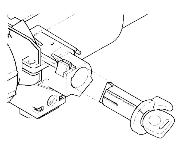

pic 5
2. Use a screwdriver to rotate the lock cylinder housing gear counterclockwise until it hits a stop.

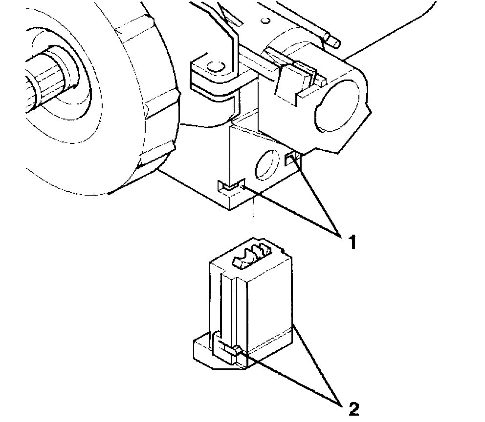

pic 6
4. Insert the ignition switch into the lock cylinder housing. The tabs (2) on the ignition switch MUST be seated inside the lock cylinder housing (1) for proper installation.
