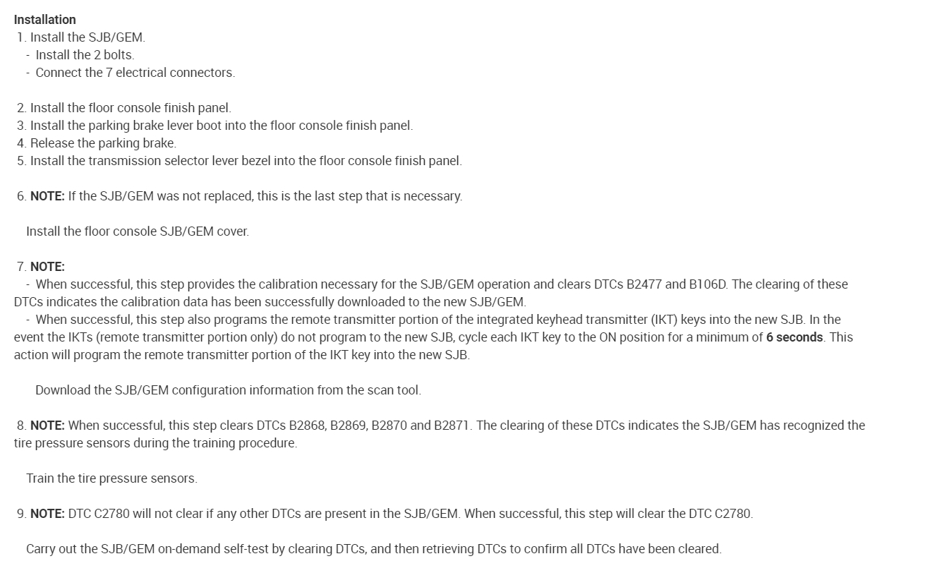

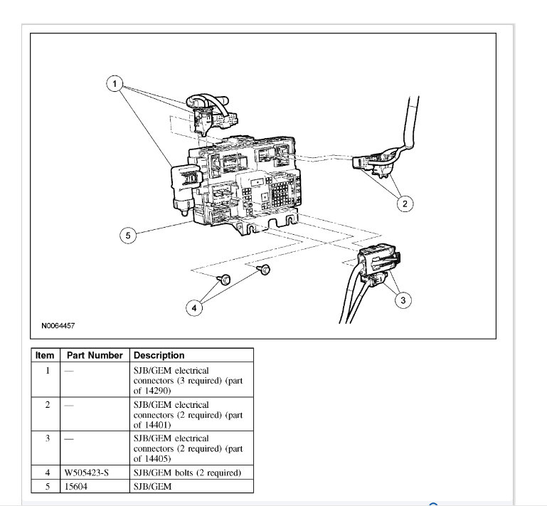

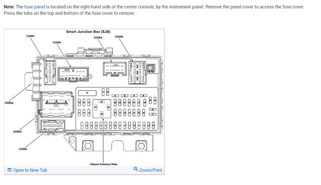

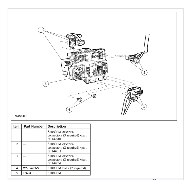

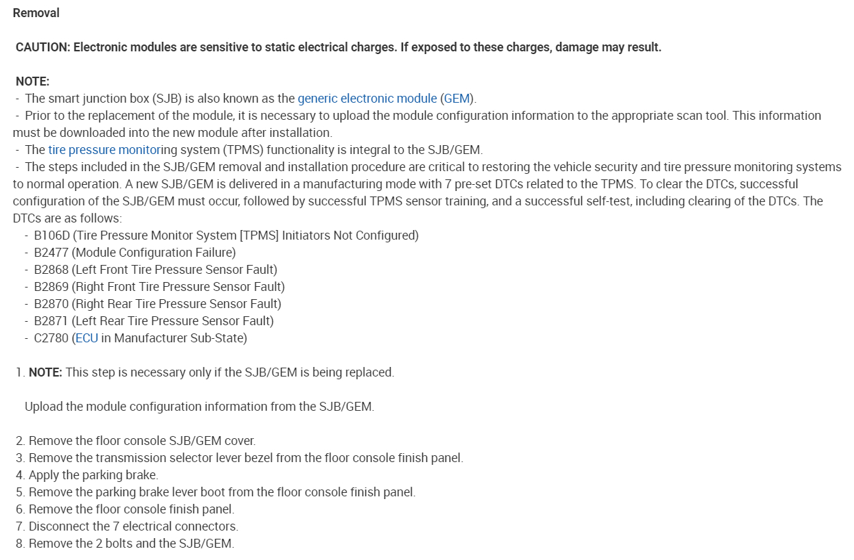

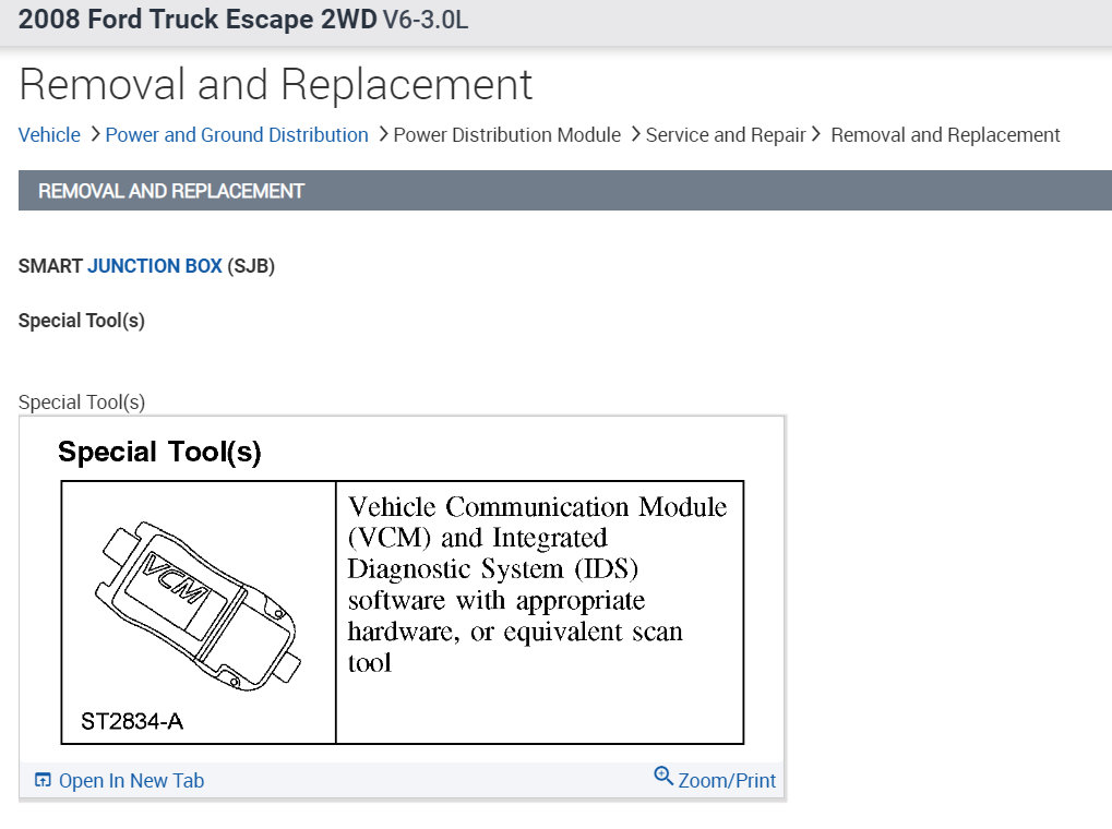

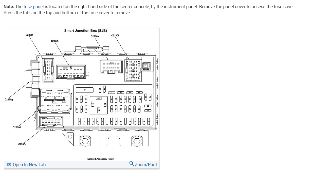

I have seen this problem before. It was the SJB that was bad which is common. here is the location of the SJB and how to change it out. A CAN scan might pick it up as well as the problem.

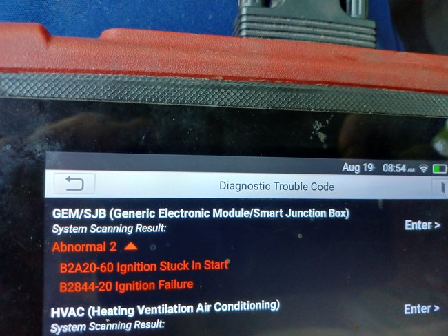

Okay, I have an adequate scanner after further searching your suggestion and the symptoms. I went to the Motorcraftservice.com website and obtained the factory as built data for the vehicle and attempted to reprogram the original SJB (smart junction box) and after completing that process I have little to no luck even starting the vehicle but I have more trouble codes and a clicking noise from the #28 fuse (5amp radio) so I believe you have me in the right direction however those parts are on backorder until September sometime from Ford I am uploading a photo of the trouble codes I'm seeing now in the SJB and I will keep you posted on my findings but it seems as though I am equipped to program the module myself.
Aug 19, 2022 at 12:10 PM
Nice work it does sound like the SJB is the problem, especially with those codes. Please let me know what happens.
