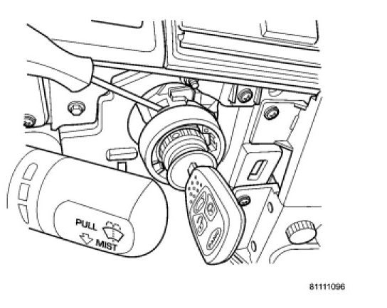

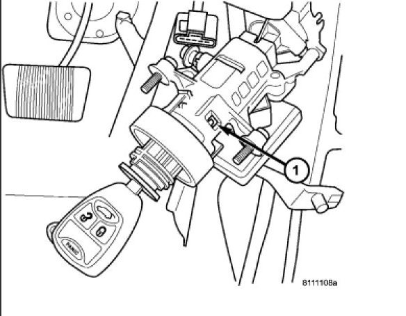

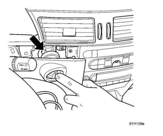

It sounds like the ignition key tumbler is worn out and needs replacement. This guide may help you get it unstuck
https://www.2carpros.com/articles/ignition-switch-wont-turn-stuck
Here are some diagrams (below) to help you get the job done.
