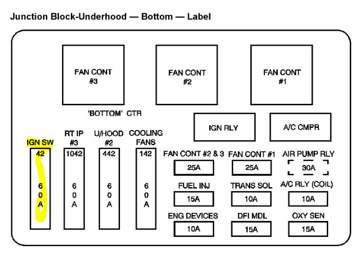

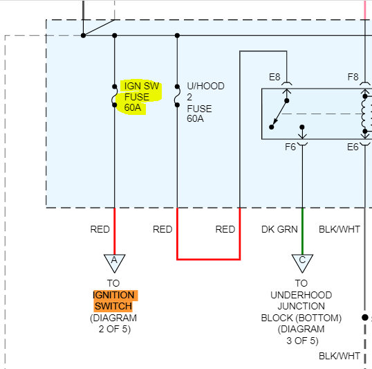

We disconnected the battery cable to put a new stereo in and when we reconnected it the key came out. We tried to put it back in. It will not turn the steering wheel is not locked. We don't know if we trip the Anti-Theft or if it's something else causing it.
