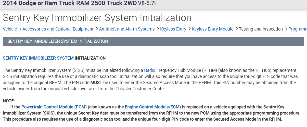

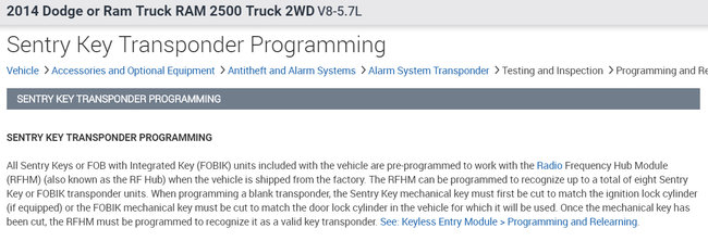

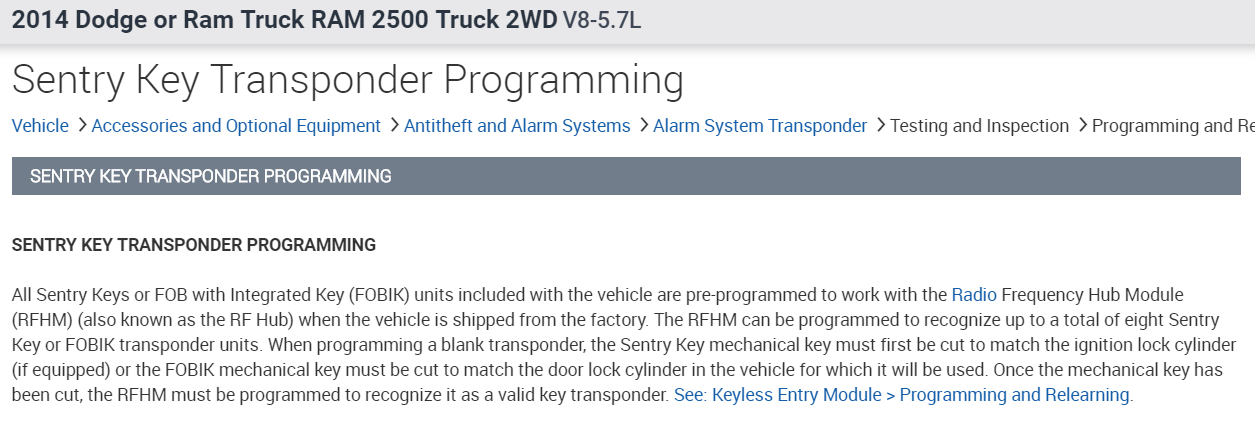

It's the ignition switch where the key fob is inserted called a win module for wireless ignition with out key-less go.
Jul 13, 2019 at 1:20 PM
CERTIFIED EXPERT
53,854 POSTS
It looks like it must be initialized to the truck to be able to work. here are the instructions to do so in the diagrams below. Check out the diagrams (below). Please let us know what you find.
