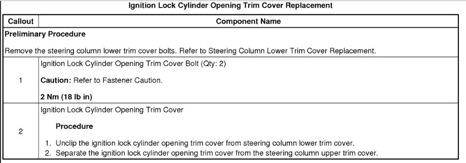

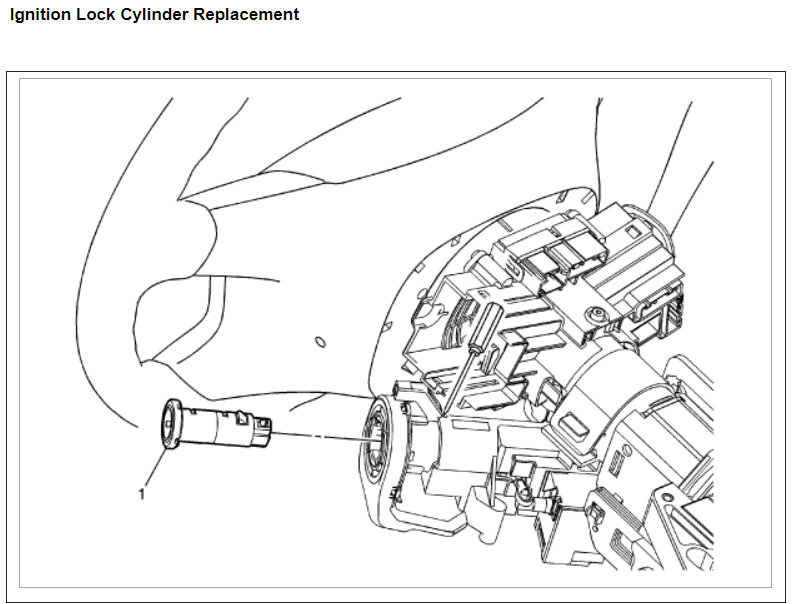

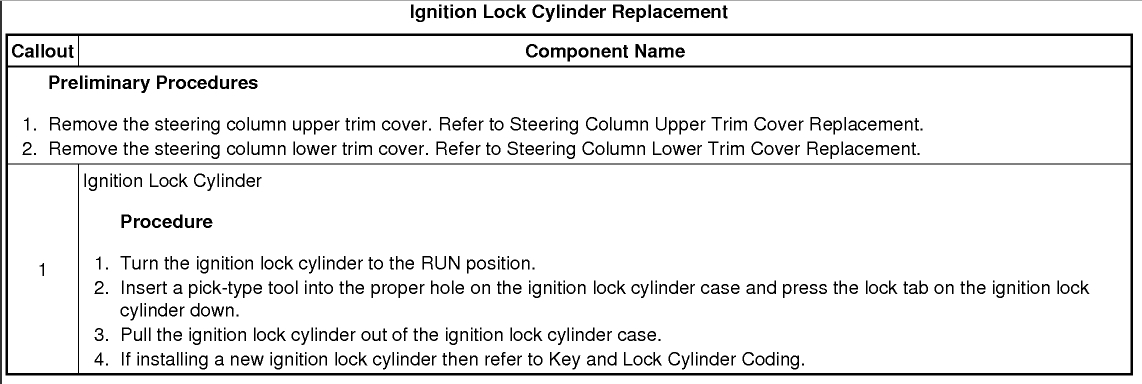

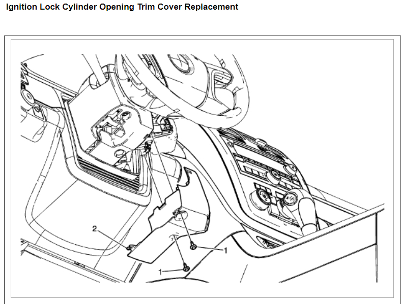

It sounds like the ignition tumbler has gone out which you will need to replace. If you give the VIN number to the dealership they can program the key before they give it to you. The lube will not hurt anything as far as the RF chip goes.
Here are diagrams to help you change out the ignition tumbler.
