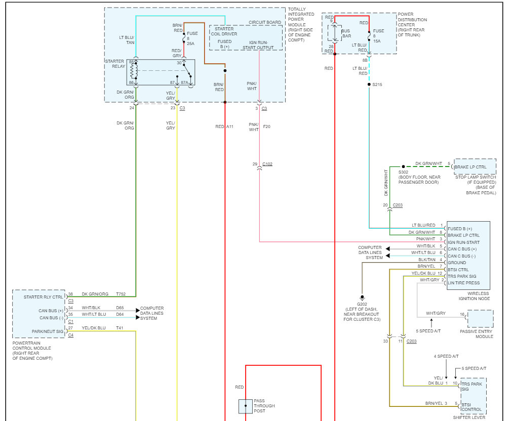

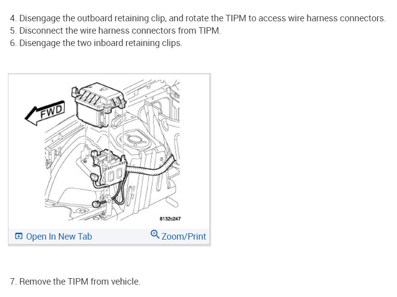

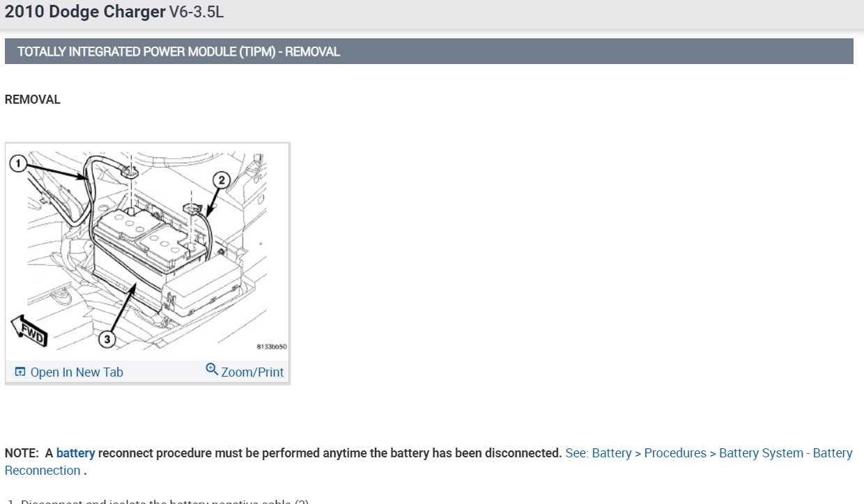

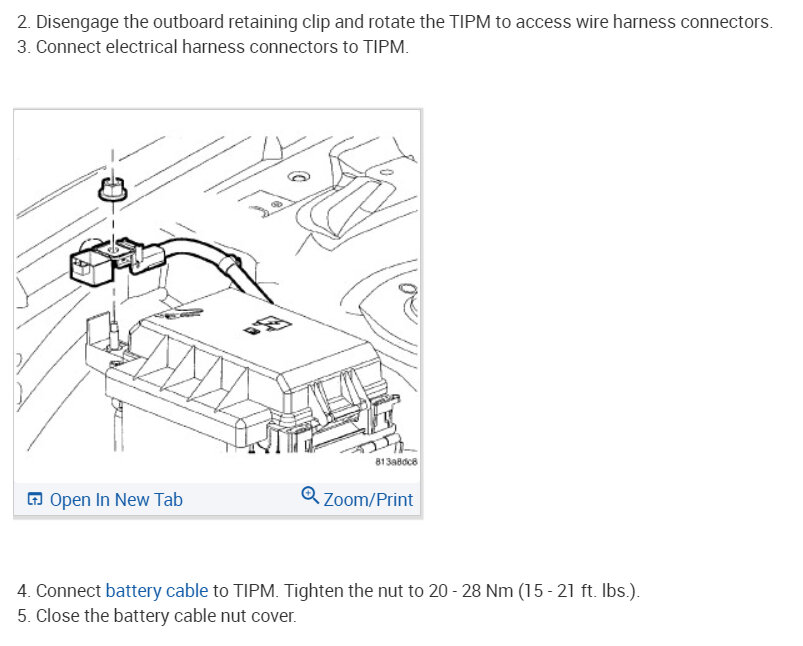

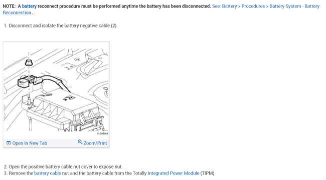

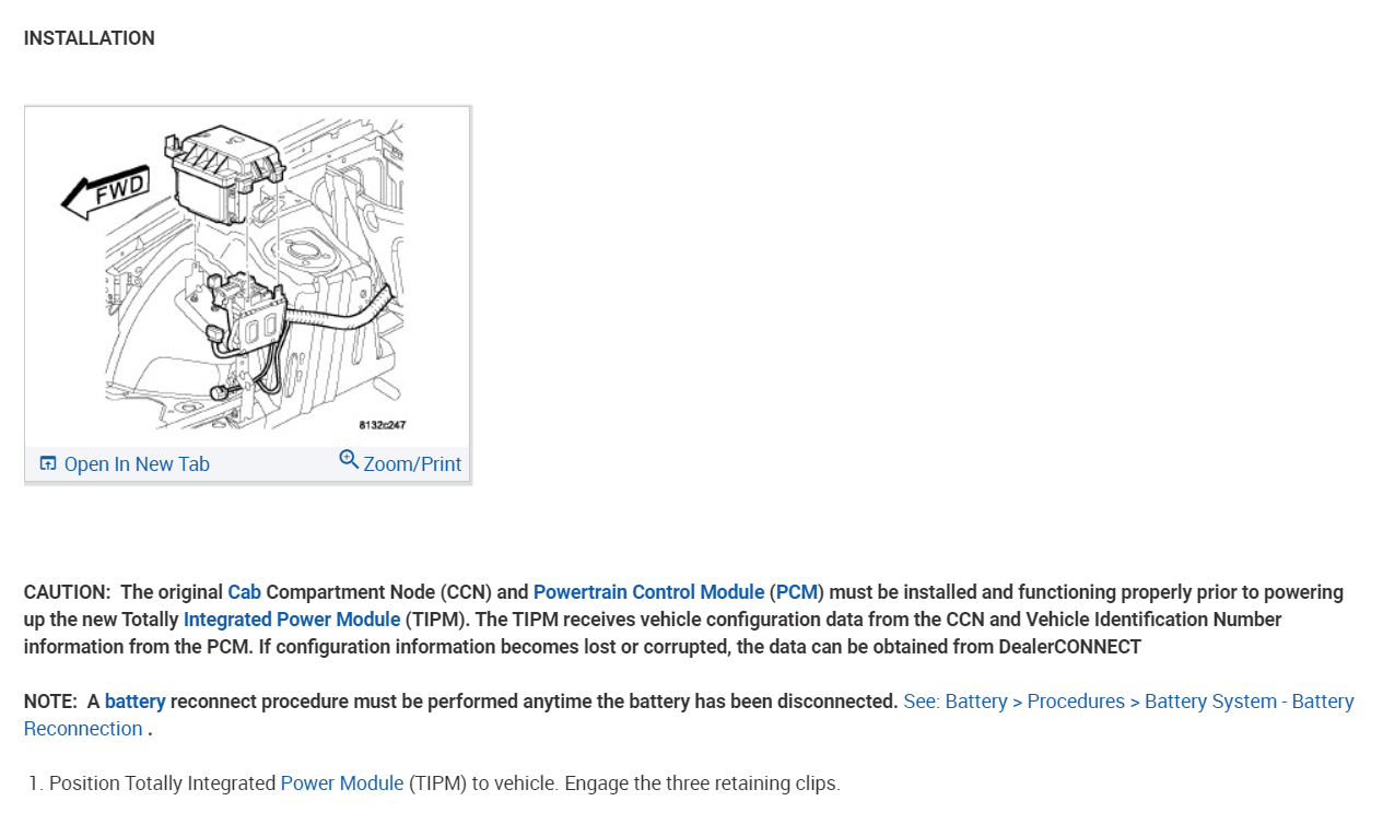

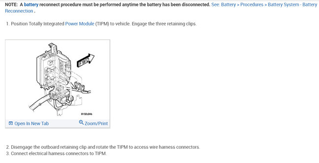

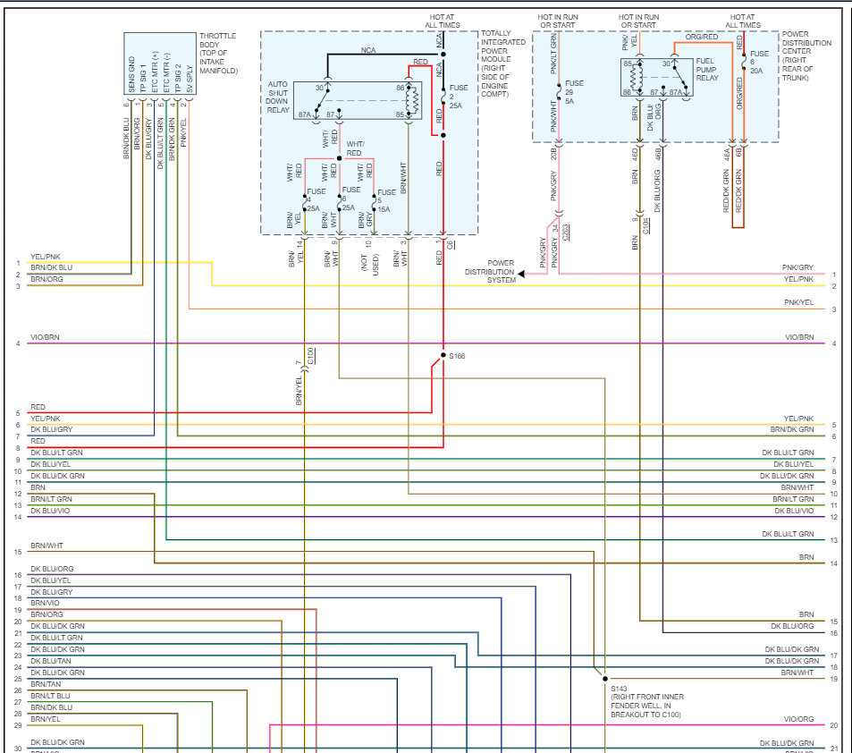

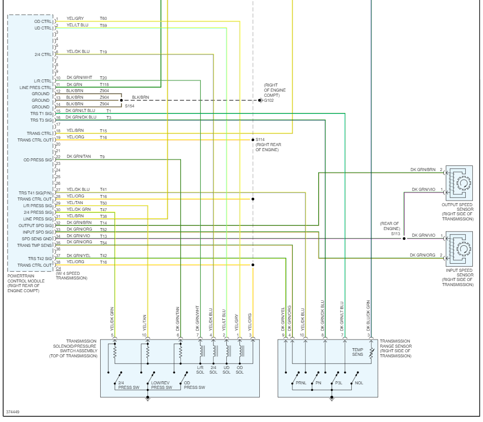

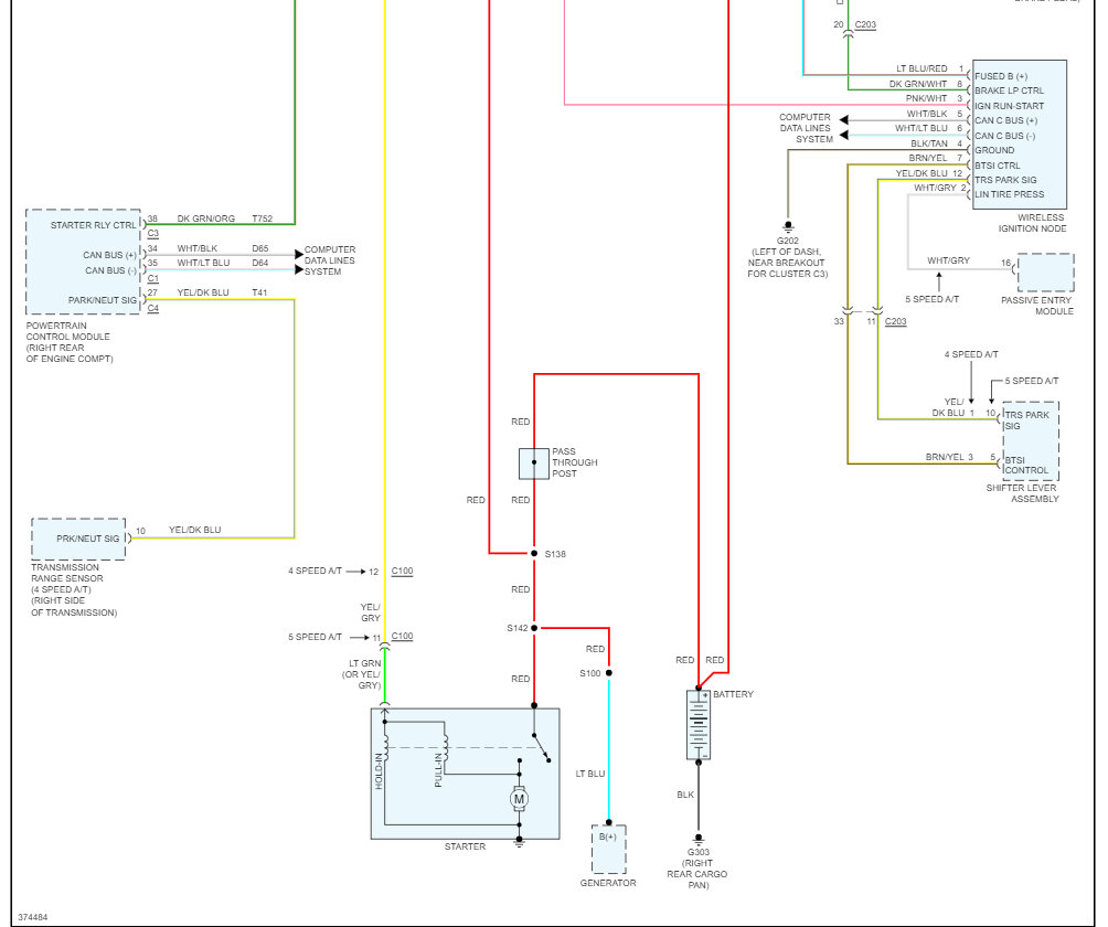

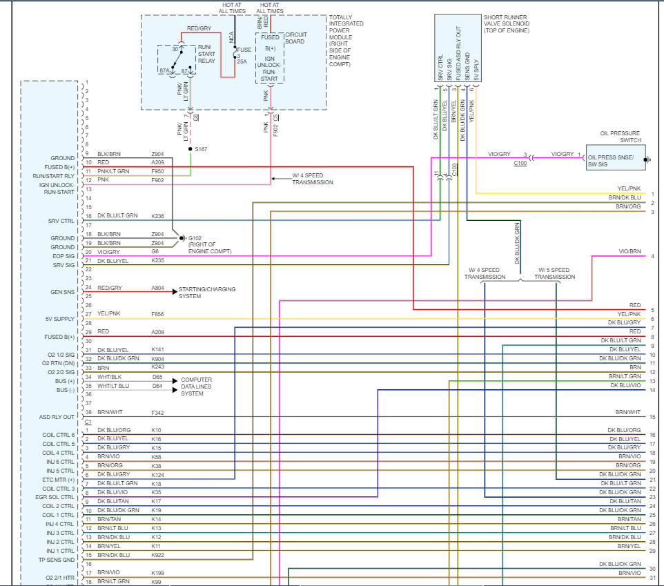

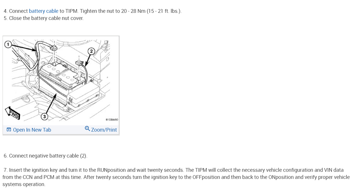

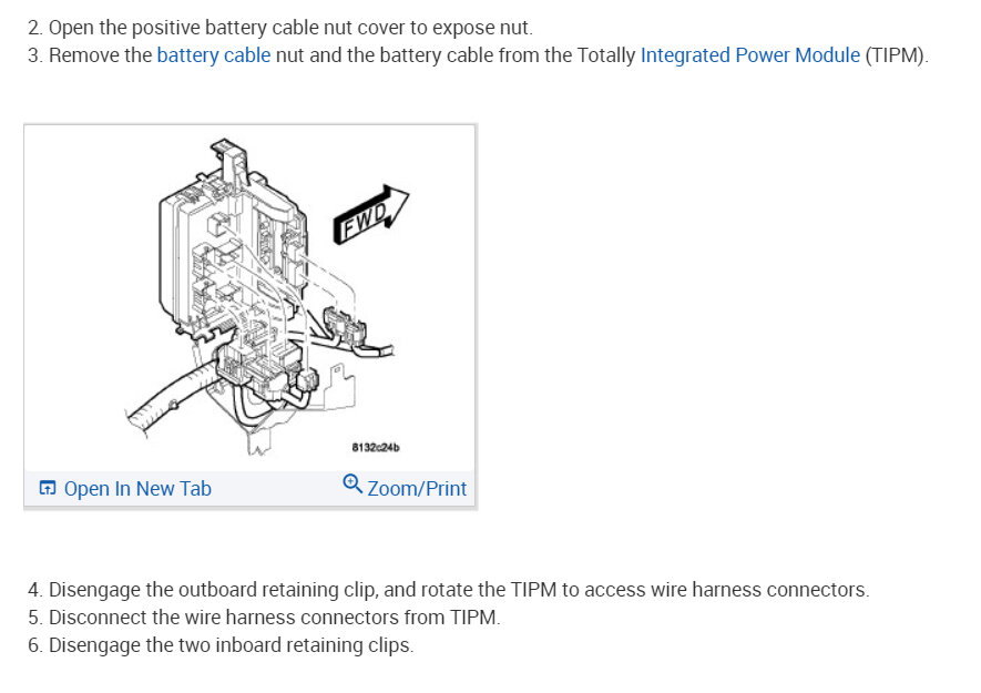

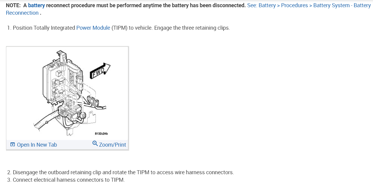

Here are the wiring diagrams for the starter circuit which you can see the TIPM's involvement. Also, I have included how to change out the TIPM in case a code comes up for it. It could have gone bad from a voltage spike when the battery was connected. The TIPM is easy to replace because it-self learns. Check out the images (below). Please let us know what you find.

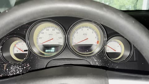

I just replaced the TIPM, I also had a doubt thinking that could be the problem causing the PCM not to send any signal out to the Coil. I replaced it with a donor fuse box from Junkyard, it does the exact same thing, Cranks but not spark. I also checked the for codes after replacing the TIPM and this is what I got. I will send them to you in a picture, I also recorded a small video where I show the lights on Dash when I switch the key to on. Check engine light will stay on, and then it would blink a few times and stay on again, I've seen that in a Misfire condition but no idea on this specific case. Hope you can help out.

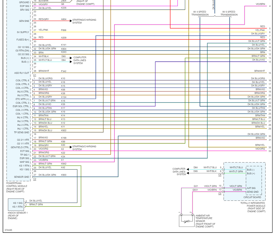

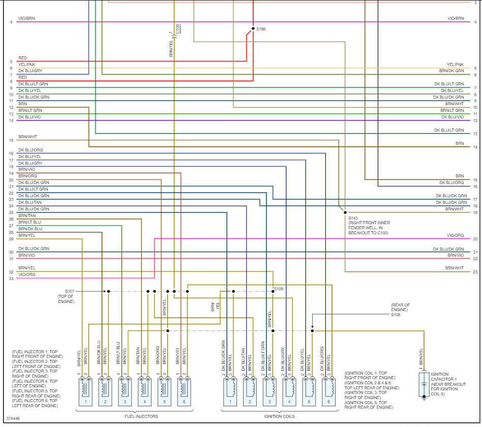

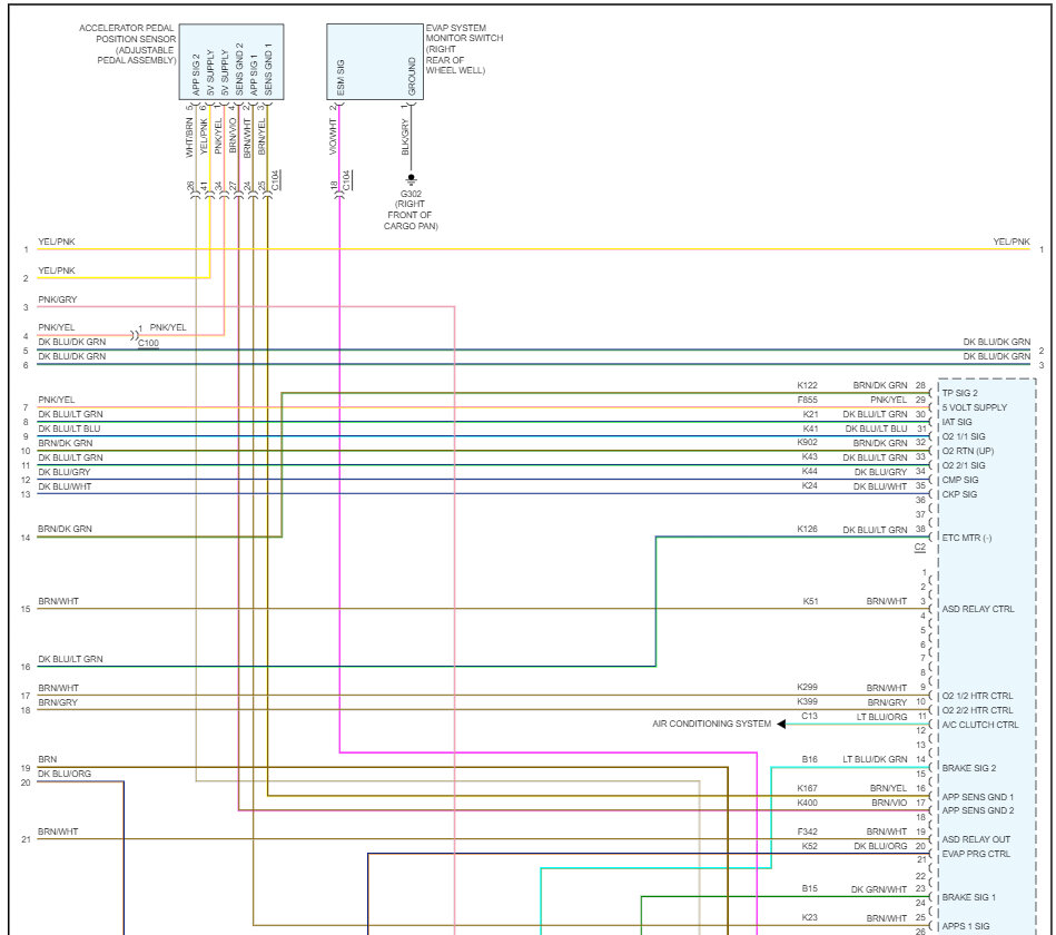

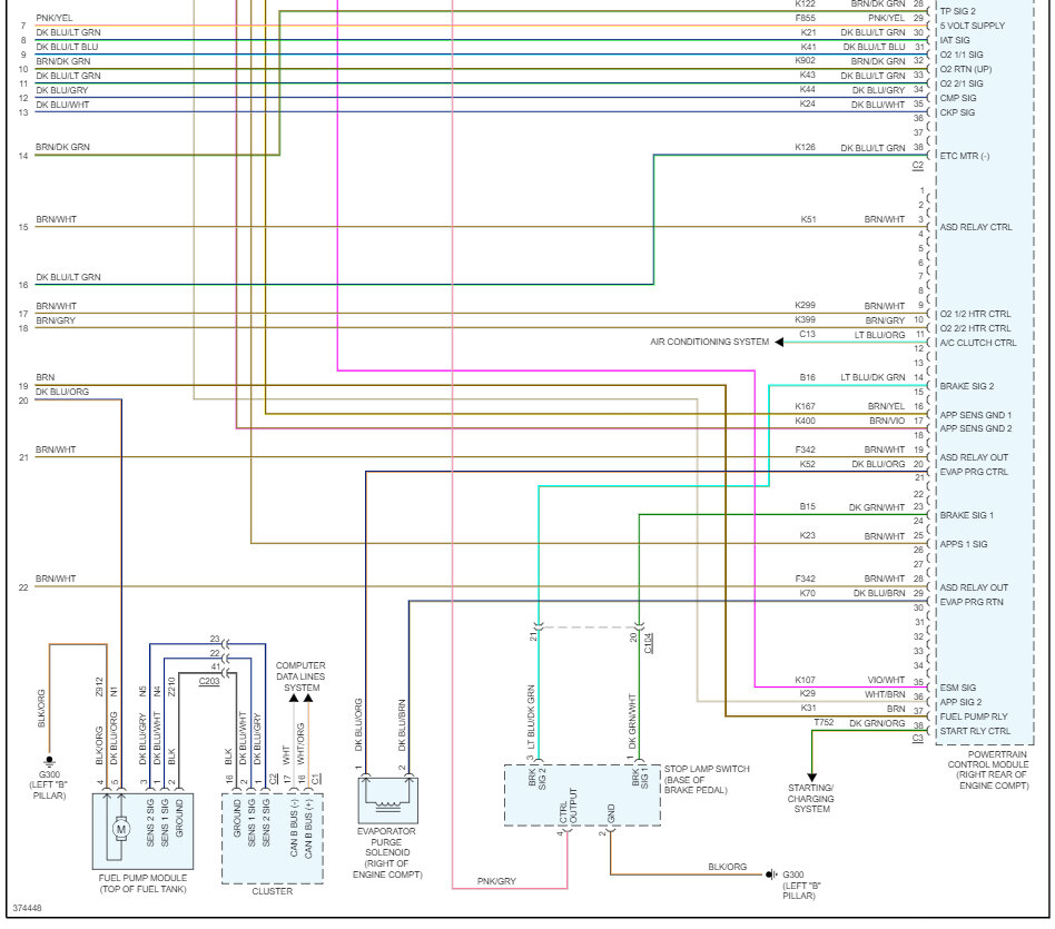

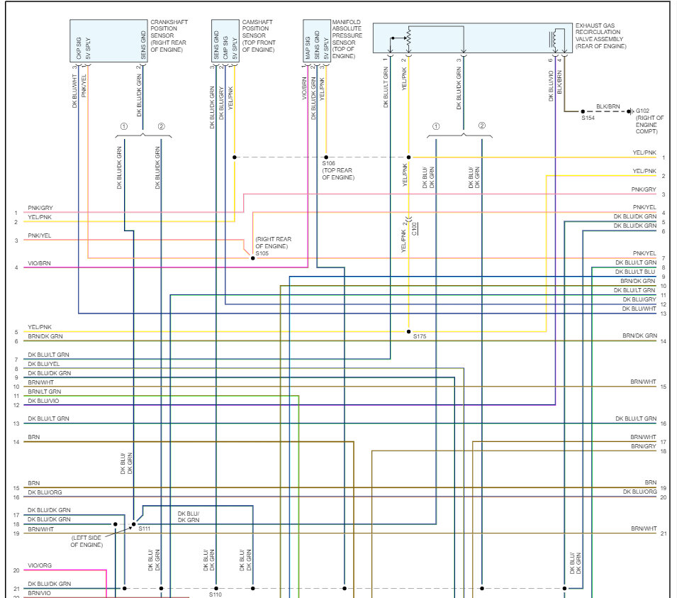

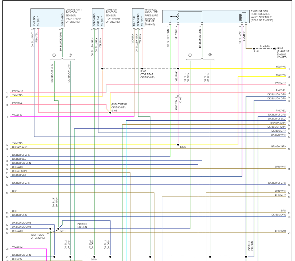

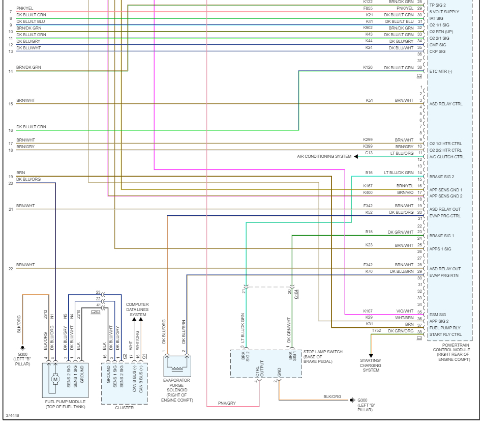

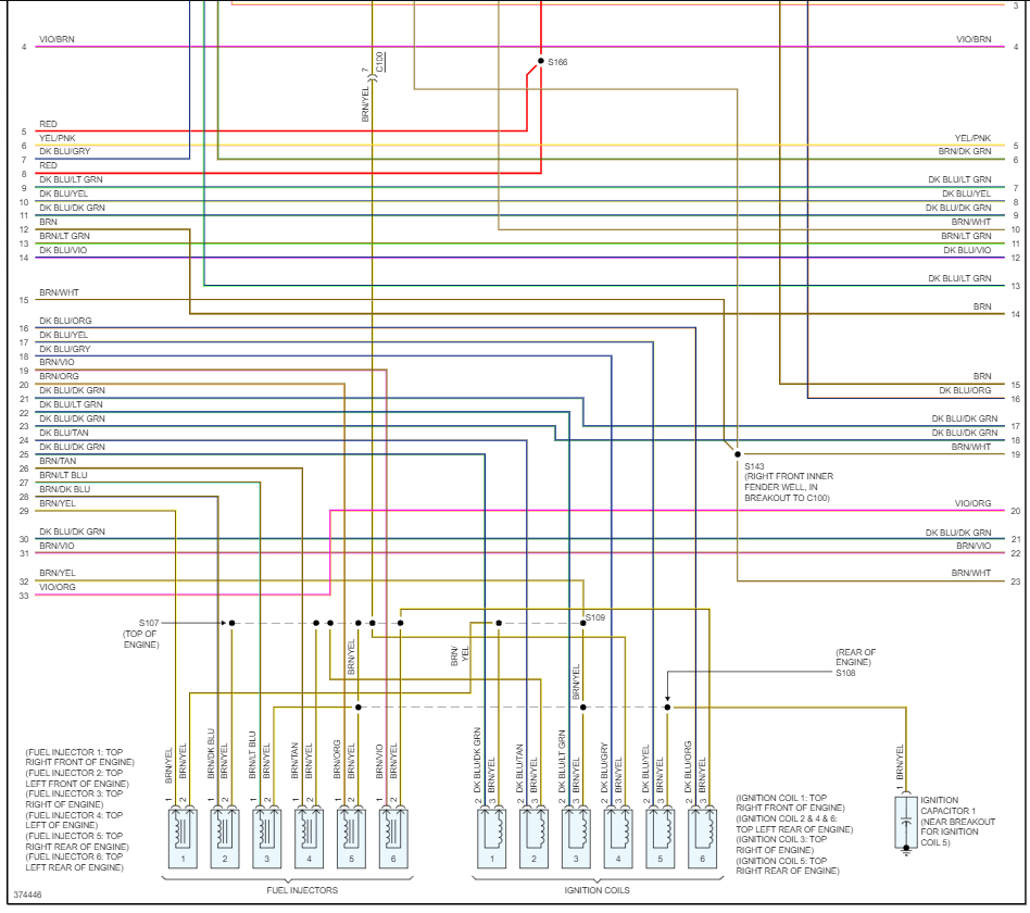

So, to be clear the engine cranks but there is no spark? I shorted ignition coil; fuel injector or oxygen sensor can shut down the PCM and cause no spark. I would remove the electrical connectors and test the coils using a voltmeter set to ohms and compare them all. Also let's check the power and ground to the PCM here is a guide and the PCM wiring diagrams below.
