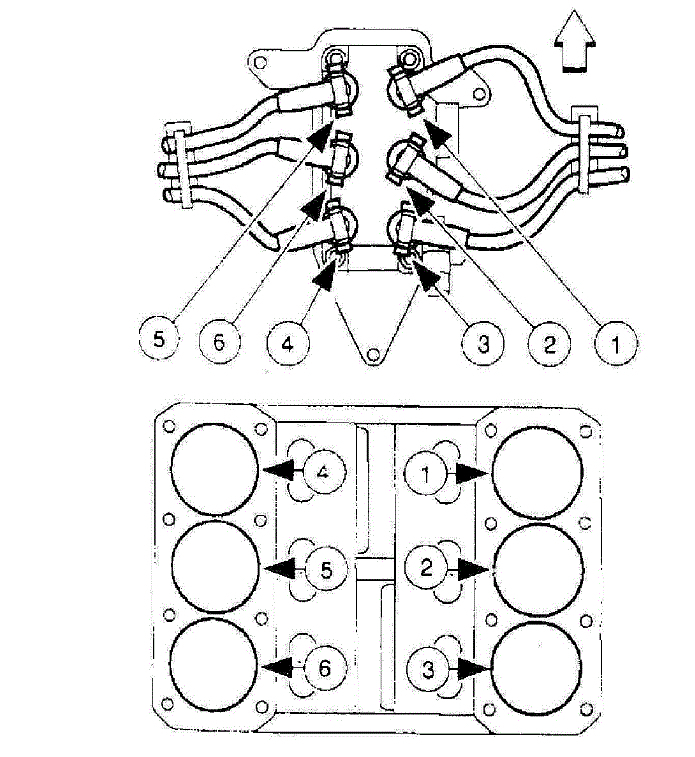

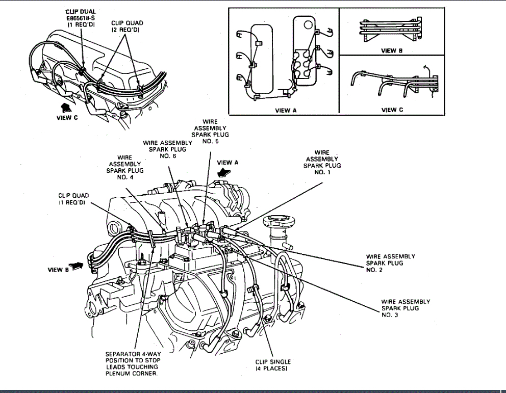

First, reconfirm they were put on correctly. I will tell you the wire routing is extremely important on these vehicles simply if it done wrong, they melt on the exhaust system and short. Plus, (and this is from memory) they plug wires are somewhat difficult to get on the plugs on a few of the cylinders. Make sure they are fully seated. You should feel a click when installing them on the plug.
Do me a favor. Just to confirm, I've attached two pics. The first shows the firing order. The second shows wire routing. Confirm these things are correct.
Next, in the dark, start the vehicle and open the hood. Check to see if there is any arcing coming from the plug wires at any point.
