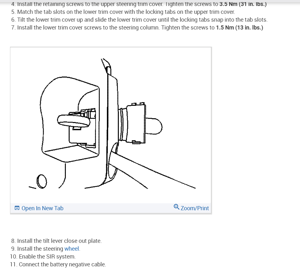

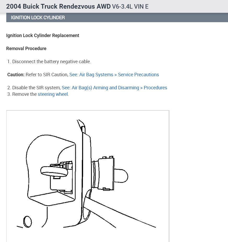

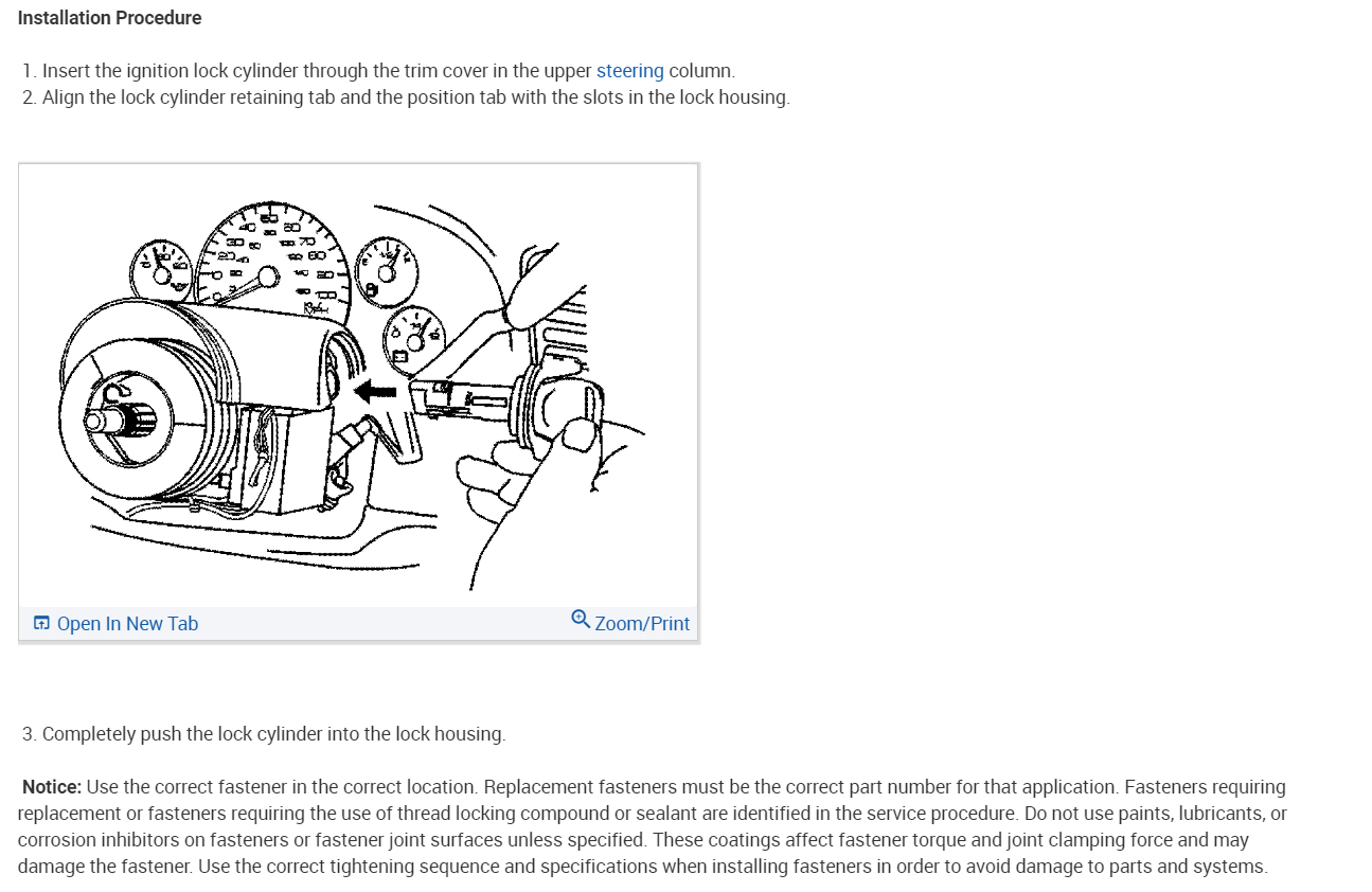

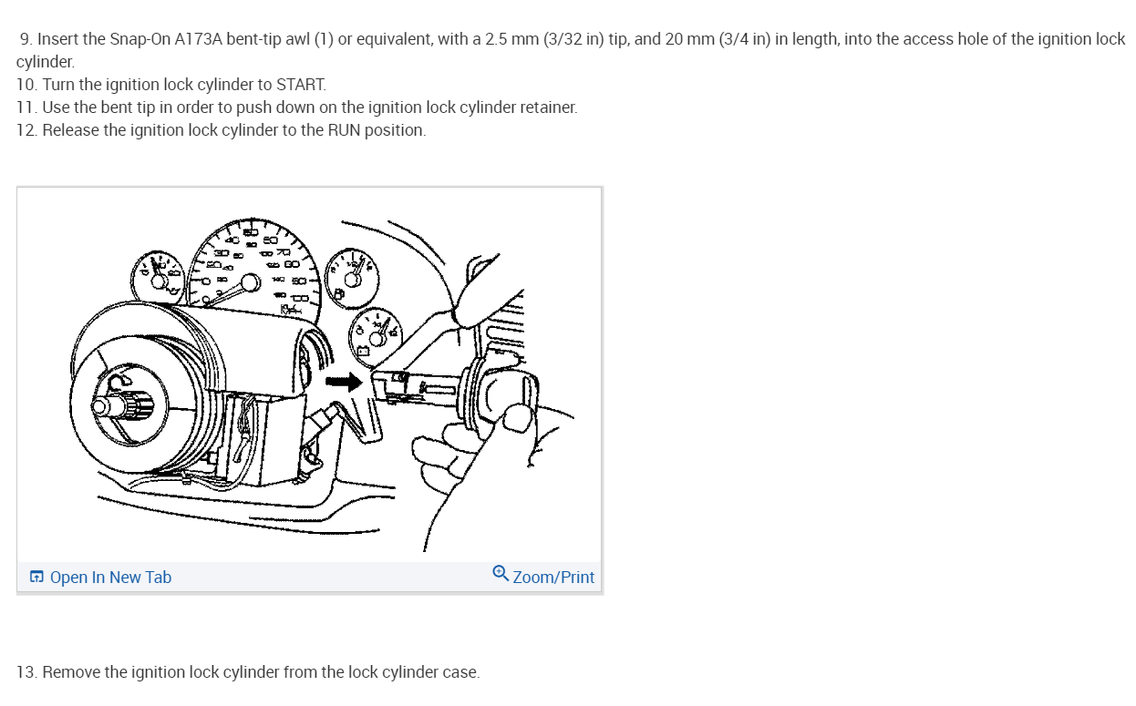

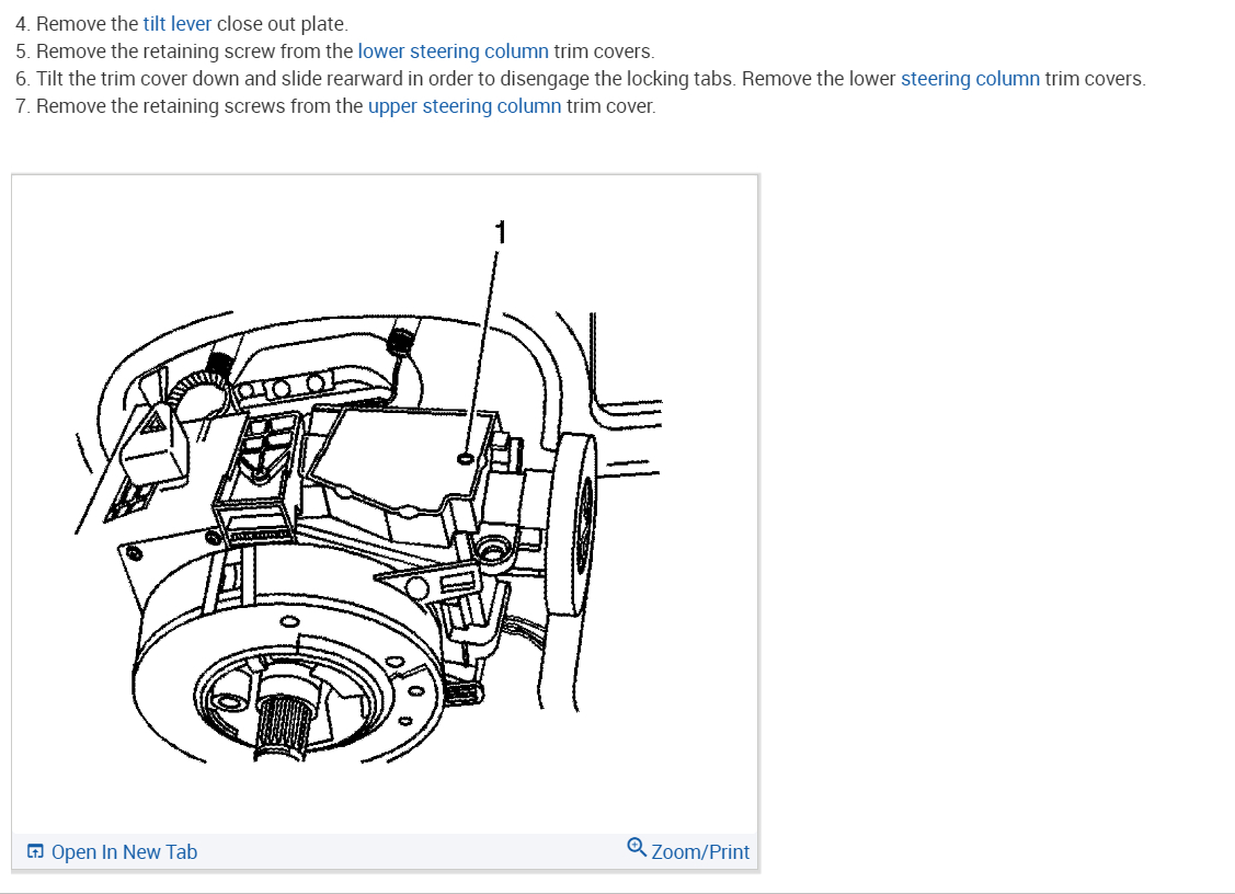

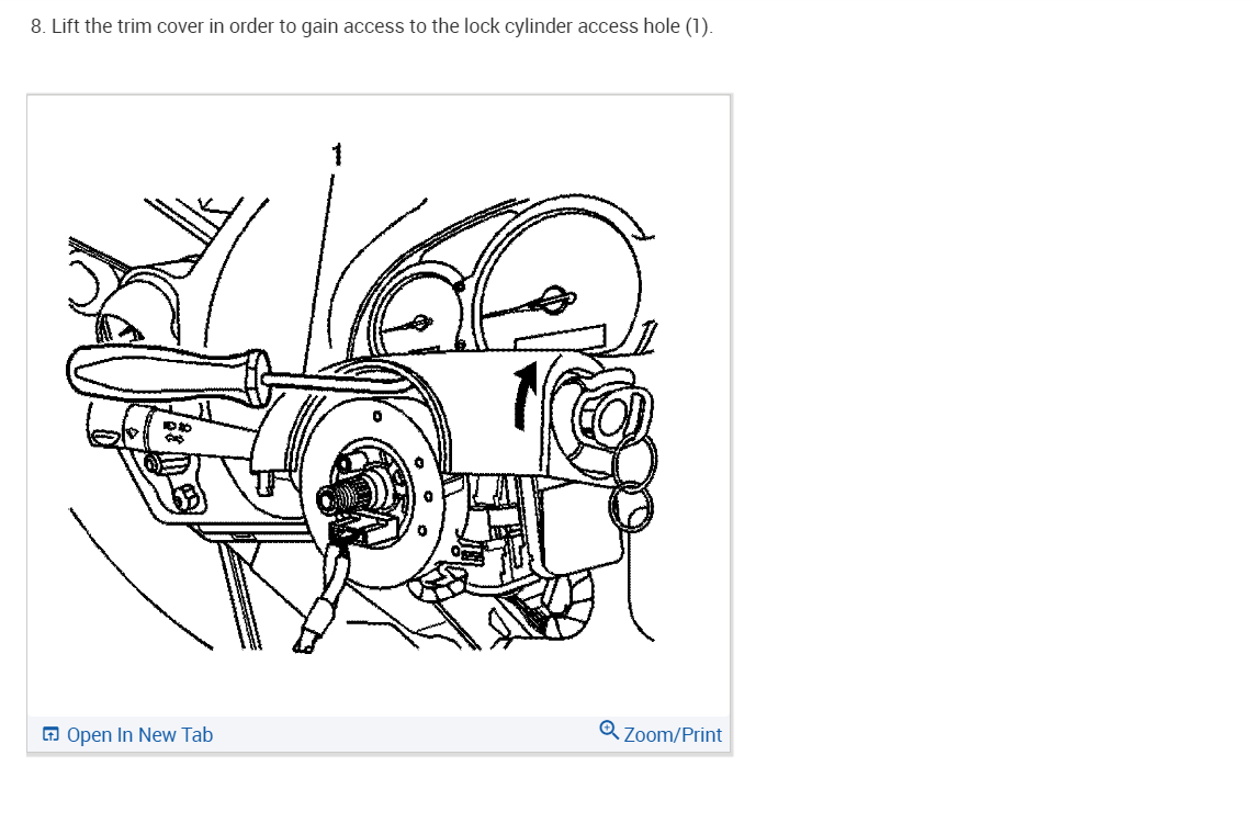

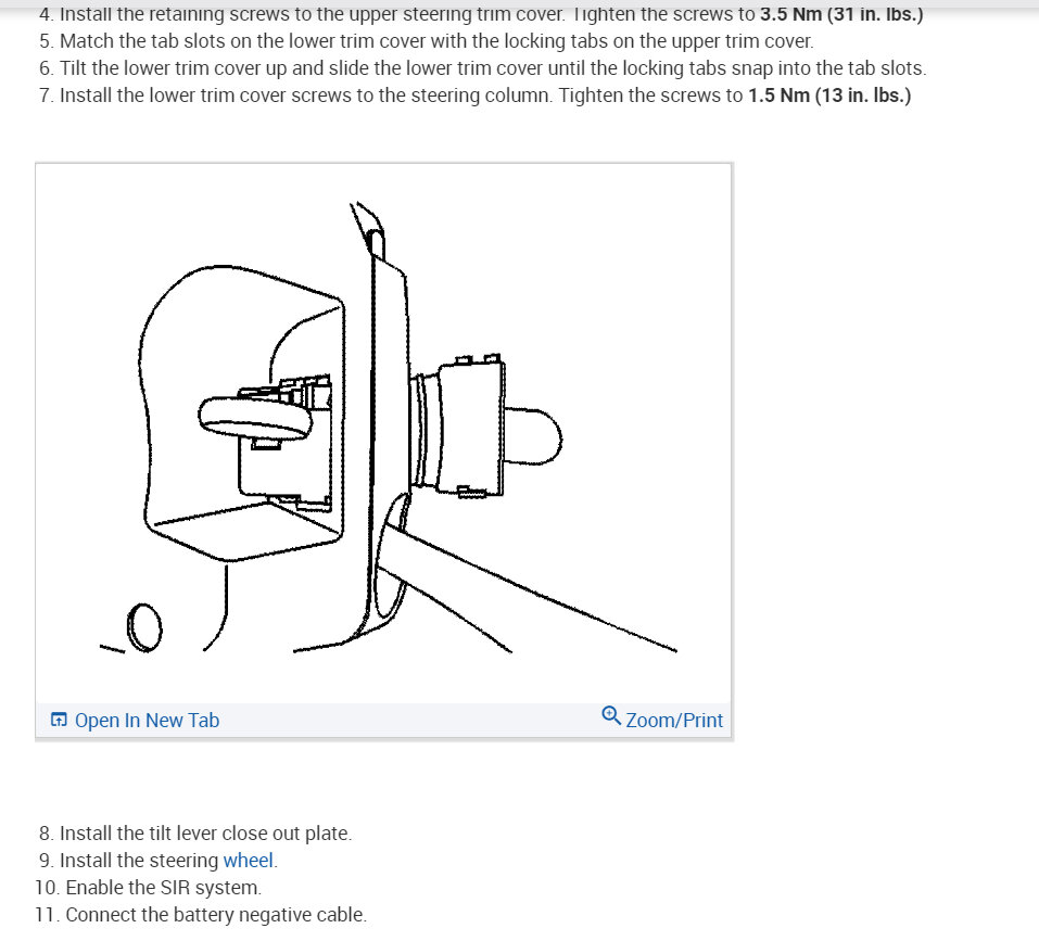

Yep, the interior parts of the ignition switch can fall apart and need to be replaced. here are the instructions on how to do so in the images below. Check out the images (below). Please let us know what happens.
