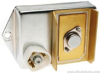

There were two ignition systems used around this time period. One used a computer that was hung on the driver's side of the air filter housing. The other system used the common five-pin ignition module, (only four are used starting with 1980 models), as shown in the photo. The color of the box denotes the maximum engine speed it will work up to, but they all interchange. This module is usually mounted on the passenger-side inner fender, but it could also be on the firewall. The body of that module must be bolted solidly to the body to provide the ground circuit. Check if the sheet metal is rusty or those bolts are loose.
