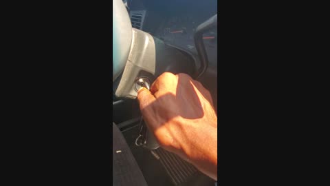

Can you please shoot a quick video with your phone so we can see what's going on? that would be great. You can upload it here with your response.

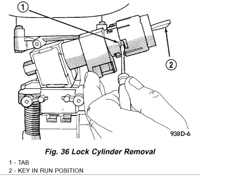

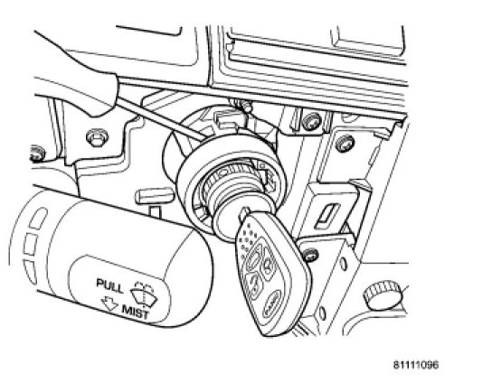

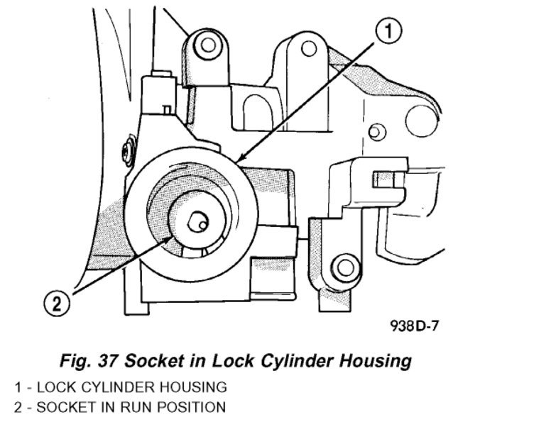

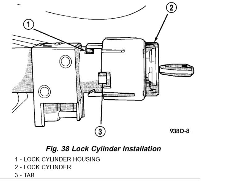

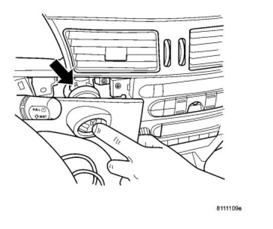

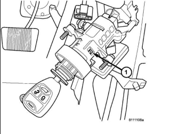

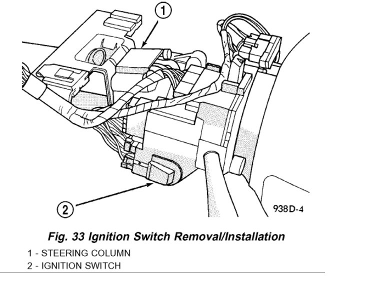

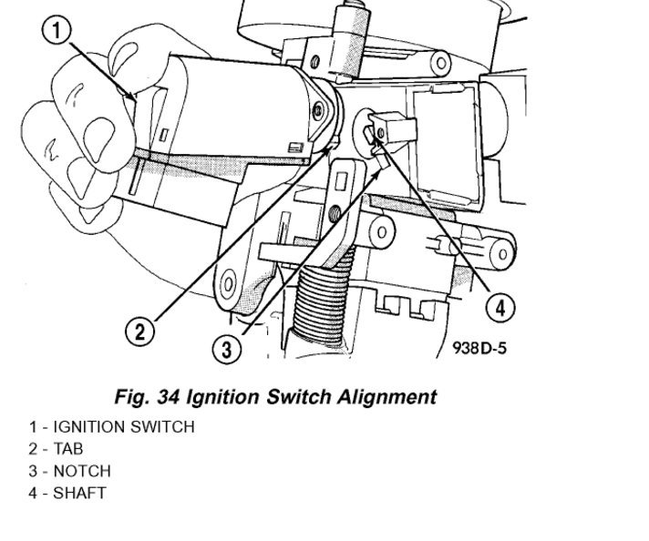

Thanks for the video. this is common when the ignition tumbler needs to be replaced. here are diagrams and instructions on how to replace the part. Check out the diagrams (below). Please let us know what happens.
