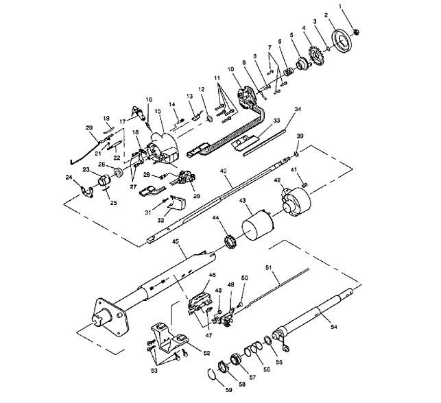

I attached the procedure for replacing the lock cylinder. it sounds like the cylinder needs to be replaced.

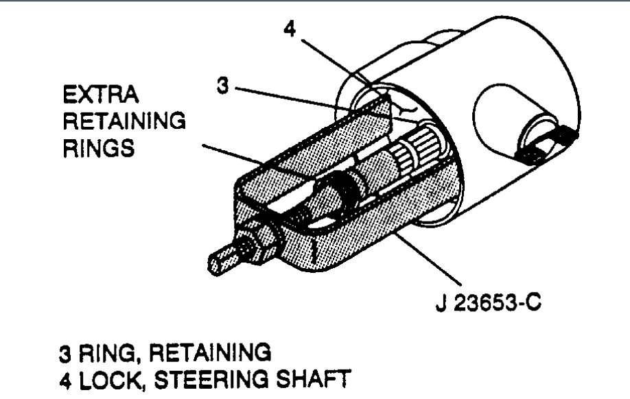

3. Shaft lock retaining ring (3) using J 23653-C to push down steering shaft lock (4). Dispose of ring (3).
Removing Shaft Lock Retaining Ring
4. Shaft lock (4) from steering shaft assembly (40).

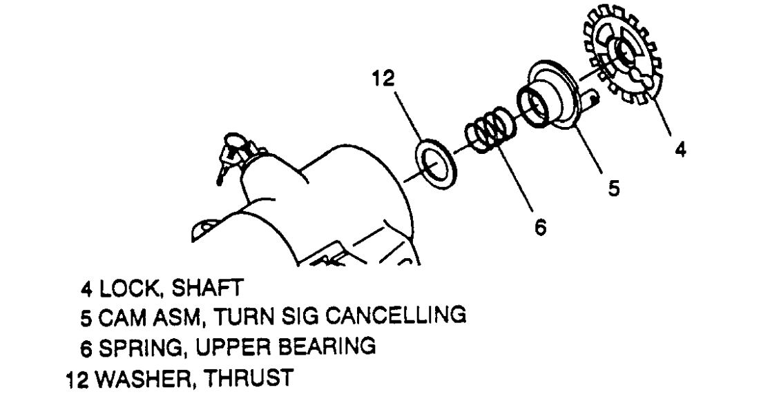

5. Turn signal cancelling cam assembly (5).
6. Upper bearing spring (6).
7. Thrust washer (12).

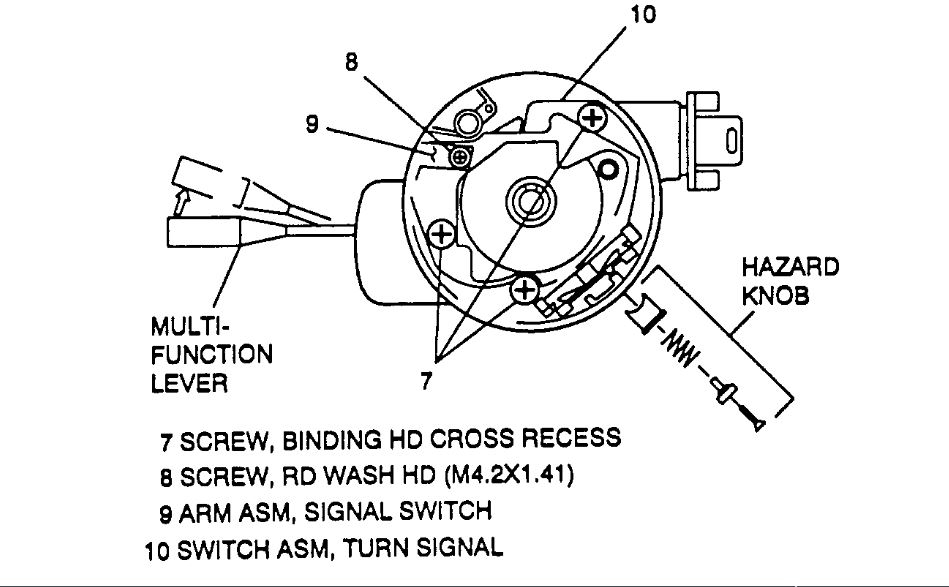

8. Turn signal to "RIGHT TURN" position (up).
9. Multi-function lever and hazard knob assembly.
10. Washer head screw (8) and switch actuator arm (9).
11. Three cross recess screws (7).
Turn Signal Switch Removal Preparation
Removing Turn Signal Switch
12. Turn signal switch assembly (10).

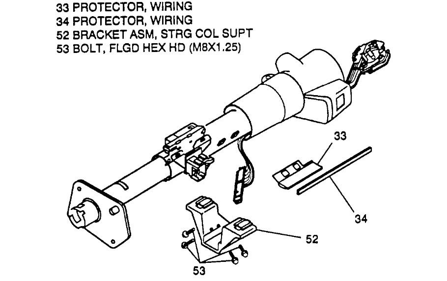

A. Hex head bolts (53).
B. Steering column support bracket assembly (52).
C. Turn signal switch connector from vehicle wire harness.
D. Wiring protectors (33) and (34).
E. Gently pull wire harness through column.
13. Key from steering column lock cylinder set (17).
14. Buzzer switch assembly (13).
15. Insert key in lock cylinder (17).
^ Key in "lock" position.
16. Lock retaining screw (14).
Removing Components From Upper Shaft
17. Steering column lock cylinder set (17).
