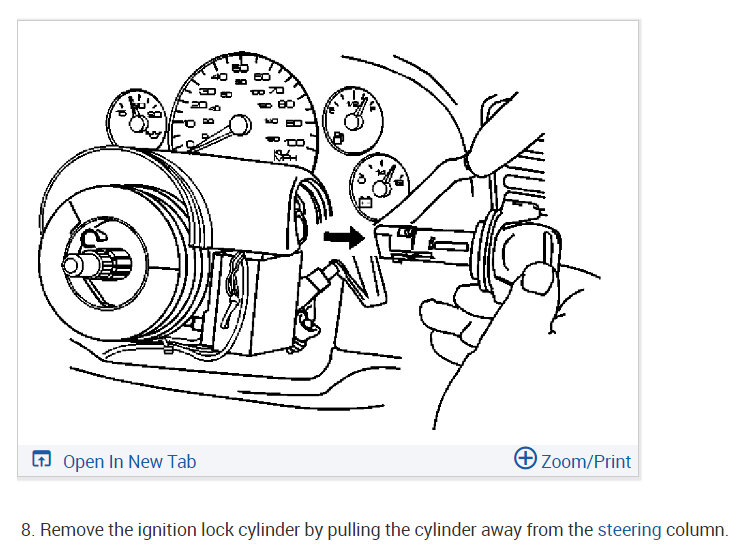

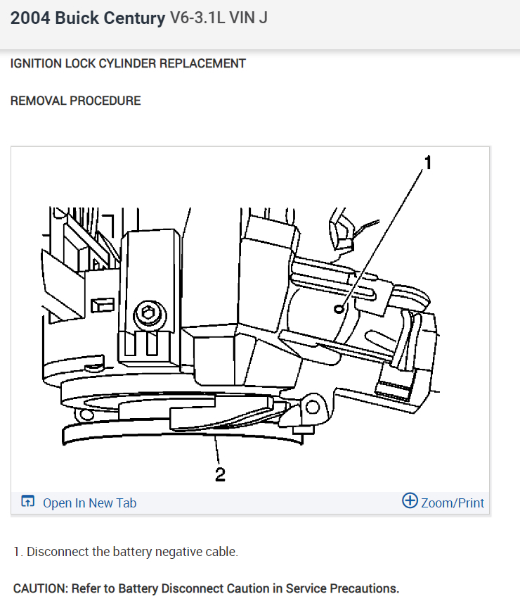

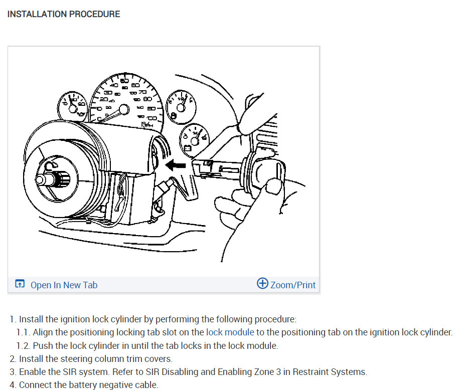

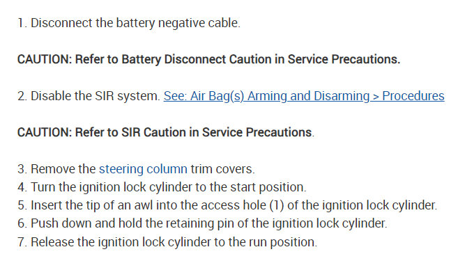

Do you have an image so we can see the damage you are trying to fix? Here is how to replace the ignition switch, I don't see any wires that you speak of? Check out the images (below). Please upload pictures or videos in your response to the problem so we can see what's going on.
