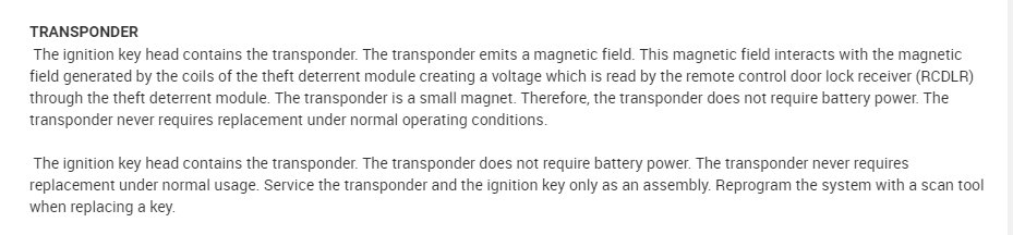

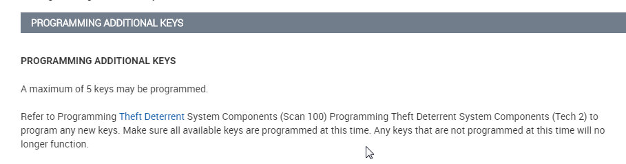

Take a look at the attached. You do not need to replace the ECU when you are doing this. If you are going to get a new ignition switch that already has a key but to it then you are going to have to simply perform the reprogram function. The ignition switch itself is not part of the anti-theft process. Only the magnet in the key and the receiver are the important part of this.
So that means you just need to get the key and switch then program them to the vehicle. However, they will no longer unlock your door so you will have to recode the doors and trunk to match this new key so that they all work.
Let me know if you have questions. Thanks

2006 should have a transponder style key, which is a small chip in the head of the key which is read by the vehicle when it is first inserted into the ignition to enable it to start. If you change the lock cylinder but have it pinned so the original key fits it, then it will work. If you change out the lock cylinder and use new keys you need to have a way to program those keys into the anti-theft system. Changing the ECU would only make it even worse as you would need to program it first, then program in the new keys as the key data is not stored or read by the ECU. An uncoded key will not work as the anti-theft uses the code it gets from the key to enable spark and fuel.
If the issue is lost keys a dealer or locksmith can call the company and get the codes that would allow them to either order or cut a new set of keys, then those are programmed into the system and the lost keys get erased so if someone finds them they won't work anyway.

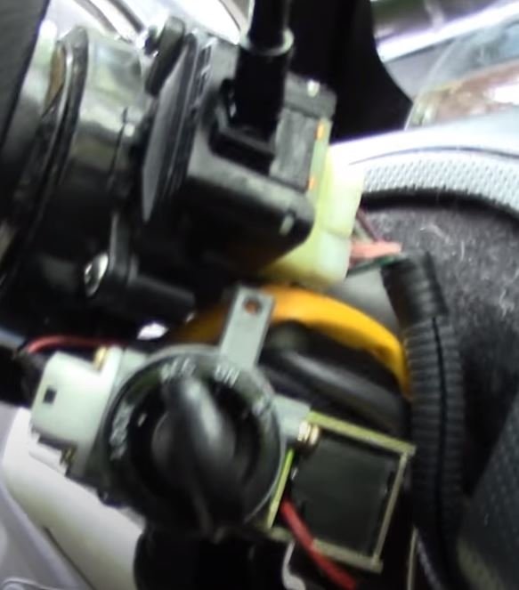

For this car the small switch near to the plastic top key opening is damaged by burglars. if I got a used ignition cylinder with key and this switch dose work? or only I have to pine my key to the new lock and that switch has nothing to do with startup .

That depends on which switch you are referring to. If you mean one inside the ignition itself like near the white connector in the image, it would need to be replaced as it is part of the alarm that reads the chip in the key. If it is the switch above it that control other items then that can be repaired at another time. If it is the part on the housing where the key cylinder goes it needs to be programmed to the system as well.
