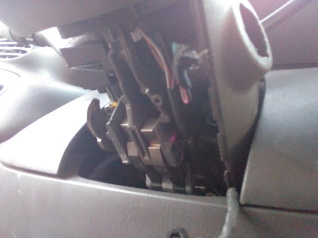

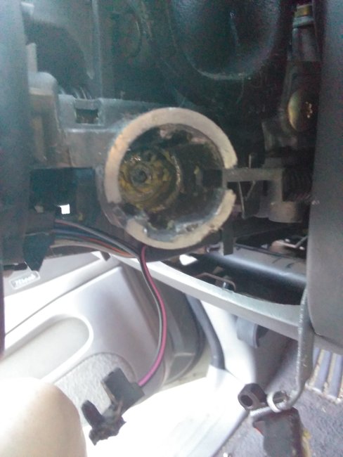

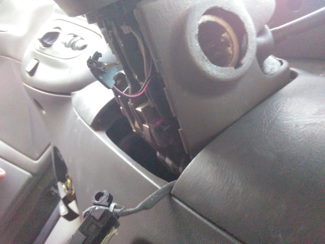

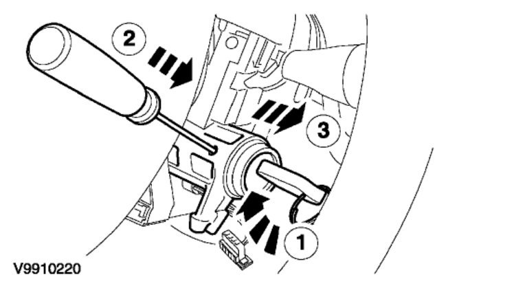

So I am having a different problem that is getting fixed already but that problem is why my Eddie Bauer Edition Expedition has been parked for three weeks. Anyways my now ex tore the lock cylinder out because he had no key. AutoZone has one for $26.00 with the key. After looking at the picture, do you think that that is the only thing I will need to fix that part. Just install it or are there any other visible problems besides the covering gone because I have that still?
Jul 11, 2017 at 1:26 AM
Yes it looks like there might be some damage that has occurred to the lock tumbler housing. It is hard to say what the damage is until you start putting it back together.

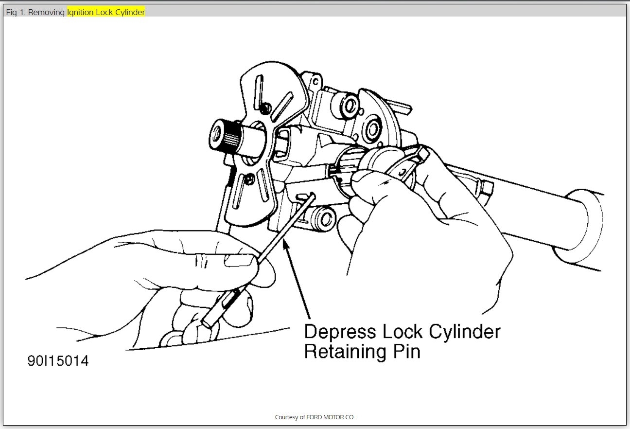

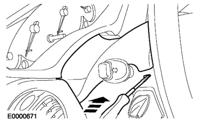

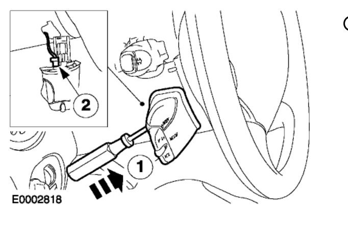

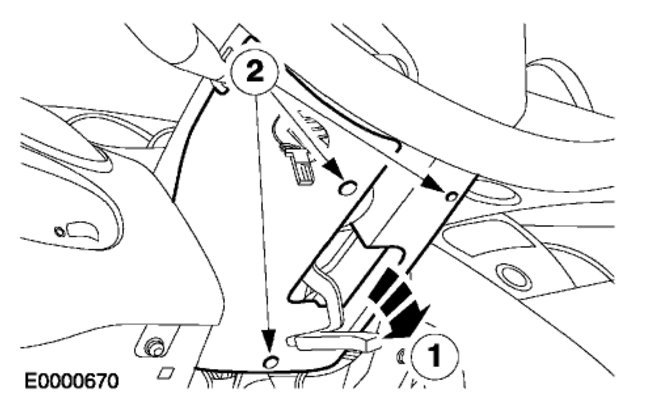

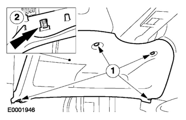

Here are some diagrams to help you get back on the road.
