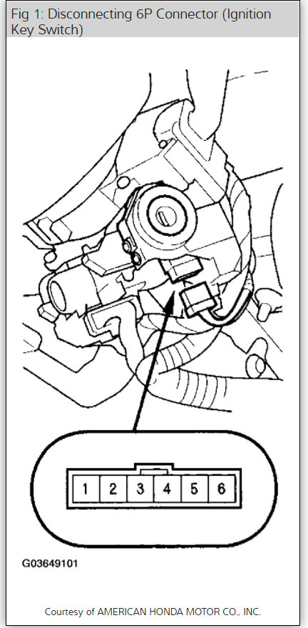

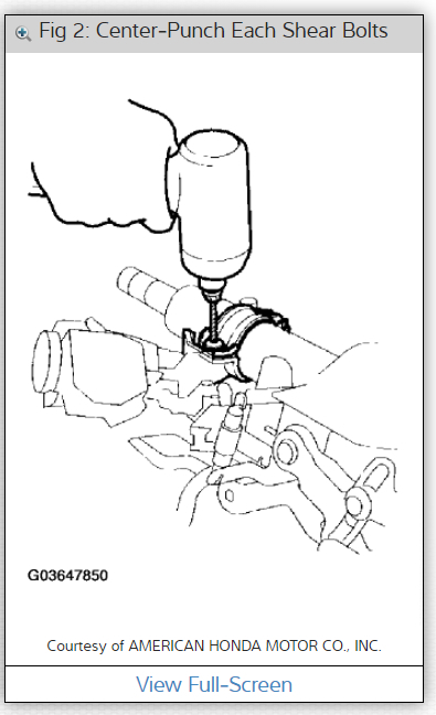

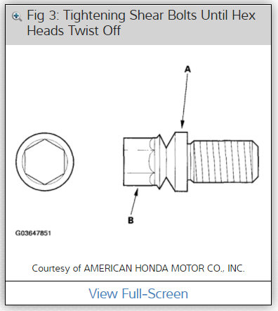

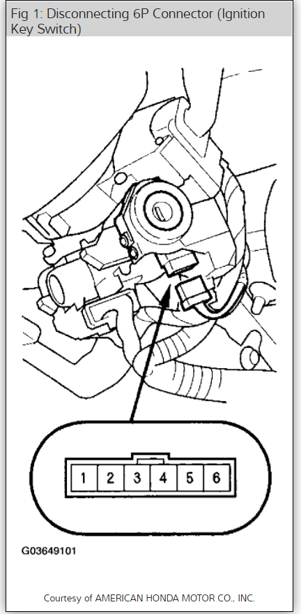

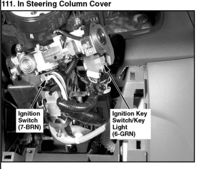

If okay then the lock will need to be replaced here are guides below to help you see what you are in for when doing the job. I think you can get the ignition lock from Amazon or Rock Auto.
Check out the diagrams (below).
