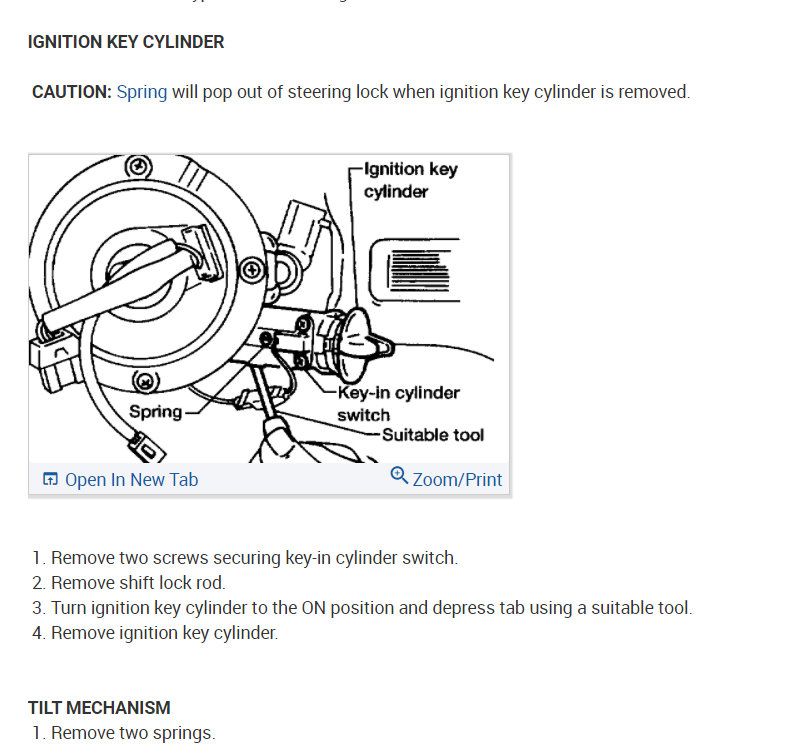

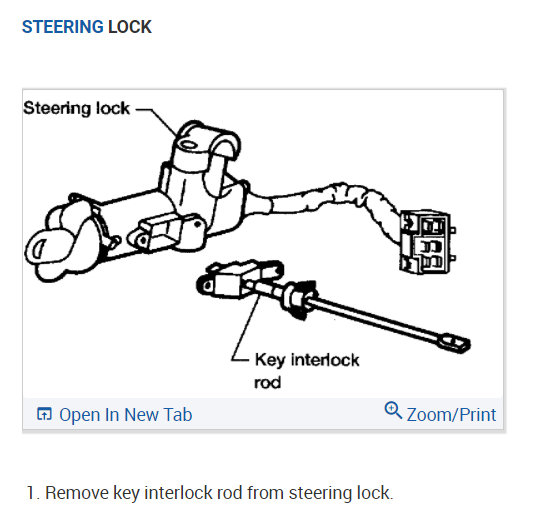

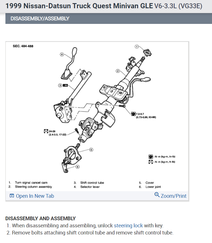

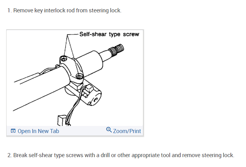

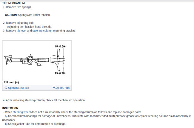

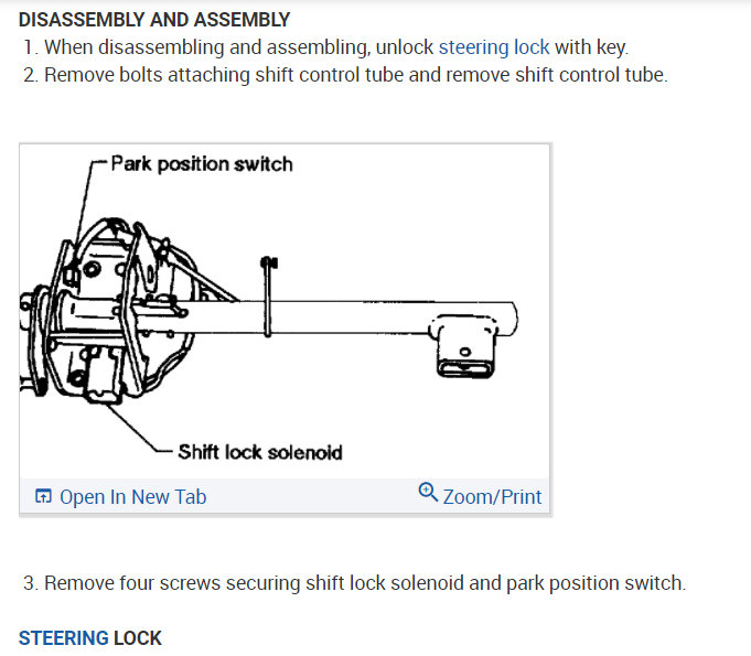

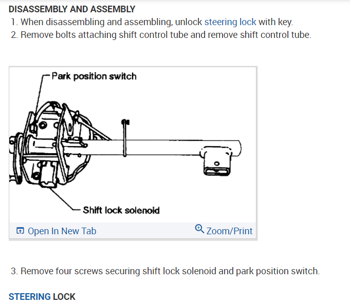

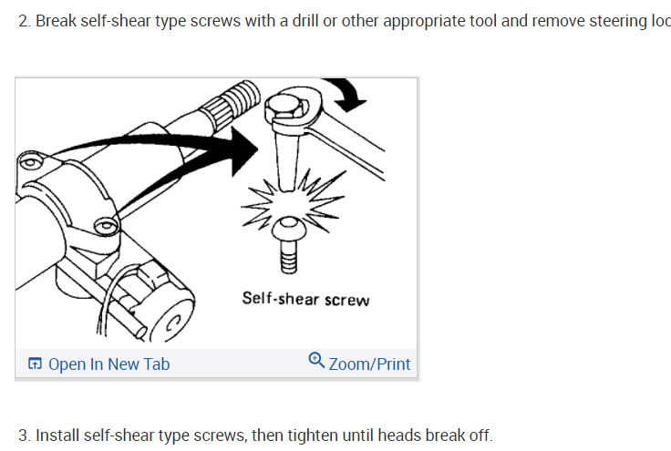

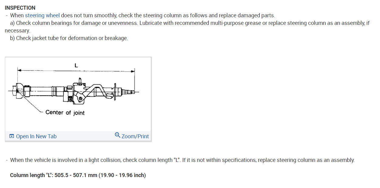

sorry for the late response. here is how to change out the old ignition lock for a new unit. you will need a sharp chisel to grab the edge of the shear bolts to loosen them, tap with a hammer. Check out the diagrams (below). Let us know what happens and please upload pictures or videos of the problem.
