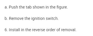

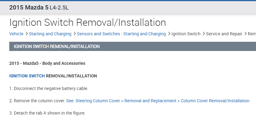

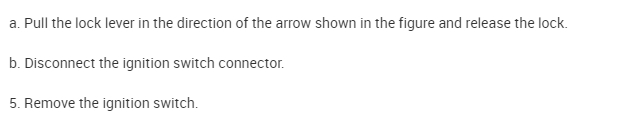

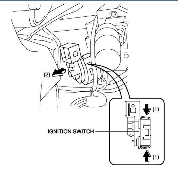

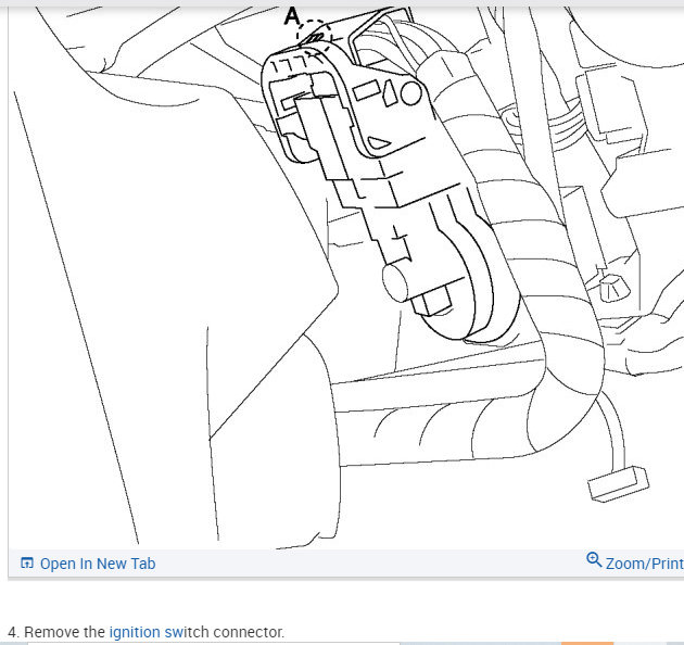

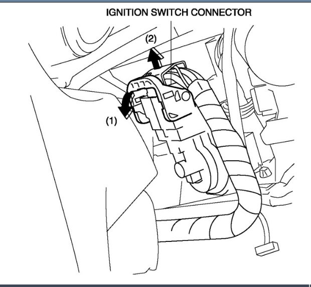

The first thing I would check is to make sure everything is tight. If it is, then I suspect it's the switch that is wearing out internally. However, confirm there is nothing loose first.
I attached the directions below for replacing the switch. Use this to remove and inspect.
Let me know what you find.
See pics below.
