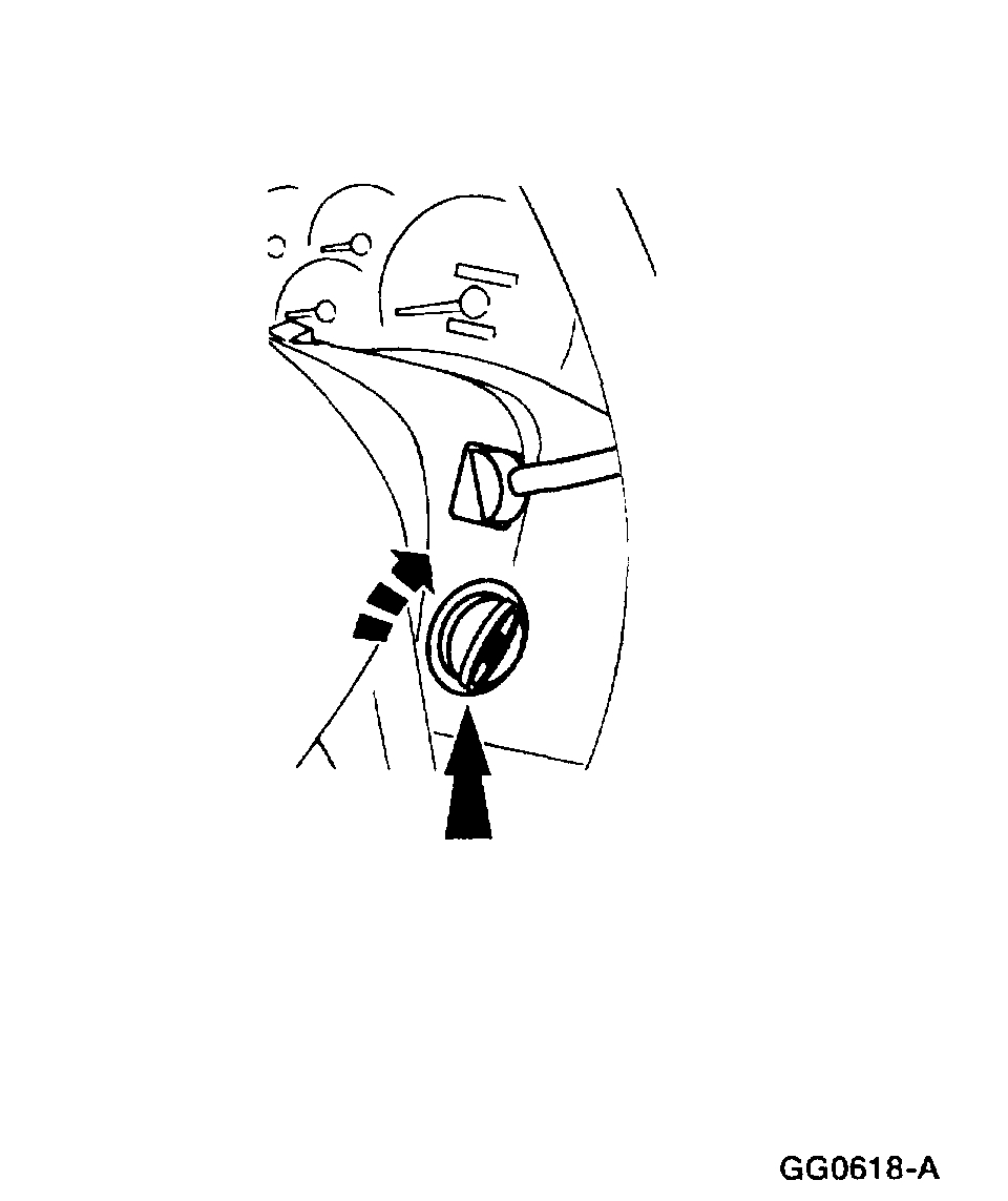

1. Disconnect the battery ground cable and wait at least one minute.
2. Remove the steering wheel.
pic 1

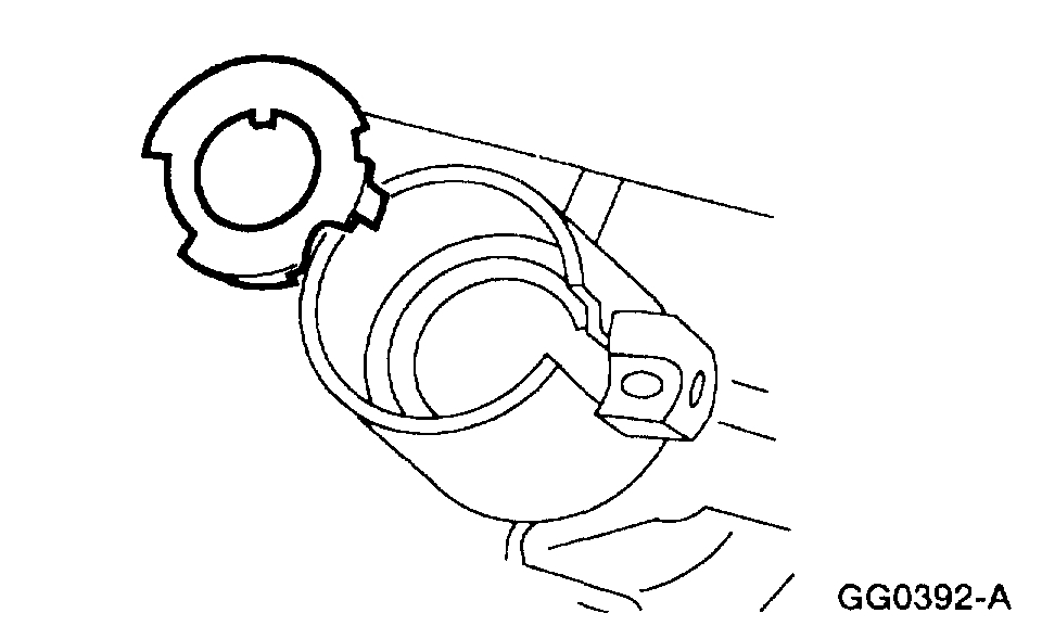

3. Twist off the cap from the ignition switch lock cylinder.
pic 2

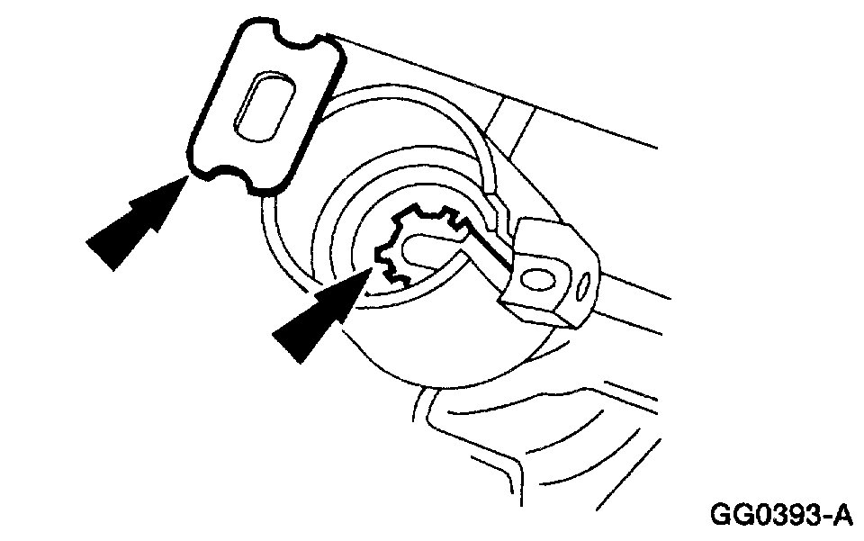

4. Remove the ignition switch lock cylinder.
^ Use a 1/8-inch diameter drill bit to drill out the lock cylinder retaining pin.
^ Use a 3/8-inch diameter drill to drill down the middle of the ignition lock key slot until the ignition switch lock cylinder breaks loose.
^ Remove and discard the ignition switch lock cylinder and drill shavings from the steering column.
pic 3

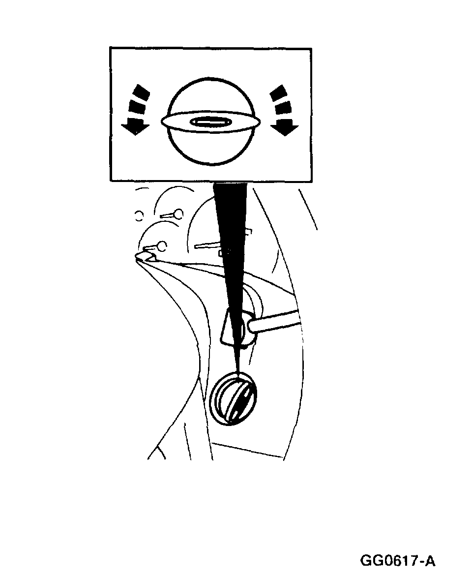

5. Remove the bearing retainer.
pic 4
6. Remove the bearing and the gear.
^ Thoroughly clean all drill shavings from the steering column and inspect it for damage.

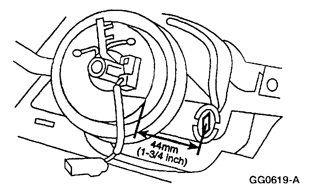

Installation
The side air bag sensors are located at or near the base of the B-pillar.
To deplete the backup power supply energy, disconnect the battery ground cable and wait at least one minute. Be sure to disconnect auxiliary batteries and power supplies (if equipped).
pic 5
1. NOTE: Use a new ignition switch lock cylinder.
Follow the removal procedure in reverse order.
^ Verify ignition switch lock cylinder operation.
