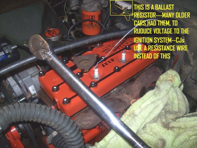

Should you ever have the ballast resistor fry/ go out. Just to get you back in, you can jump across it's terminals with a wire/ paper clip/ piece of barbed wire/ etc. Replace it soon as you can!
The Medic
