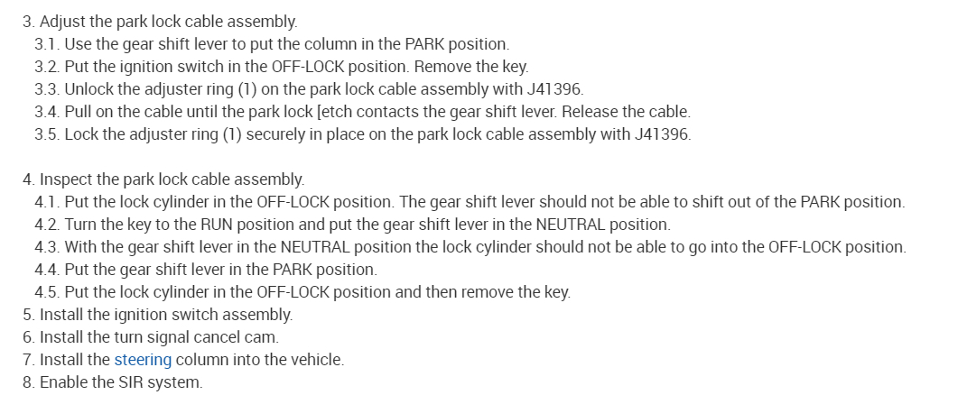

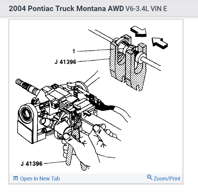

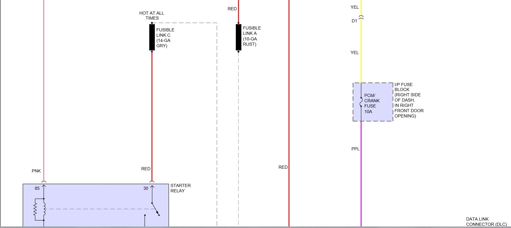

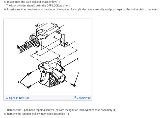

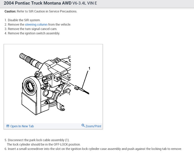

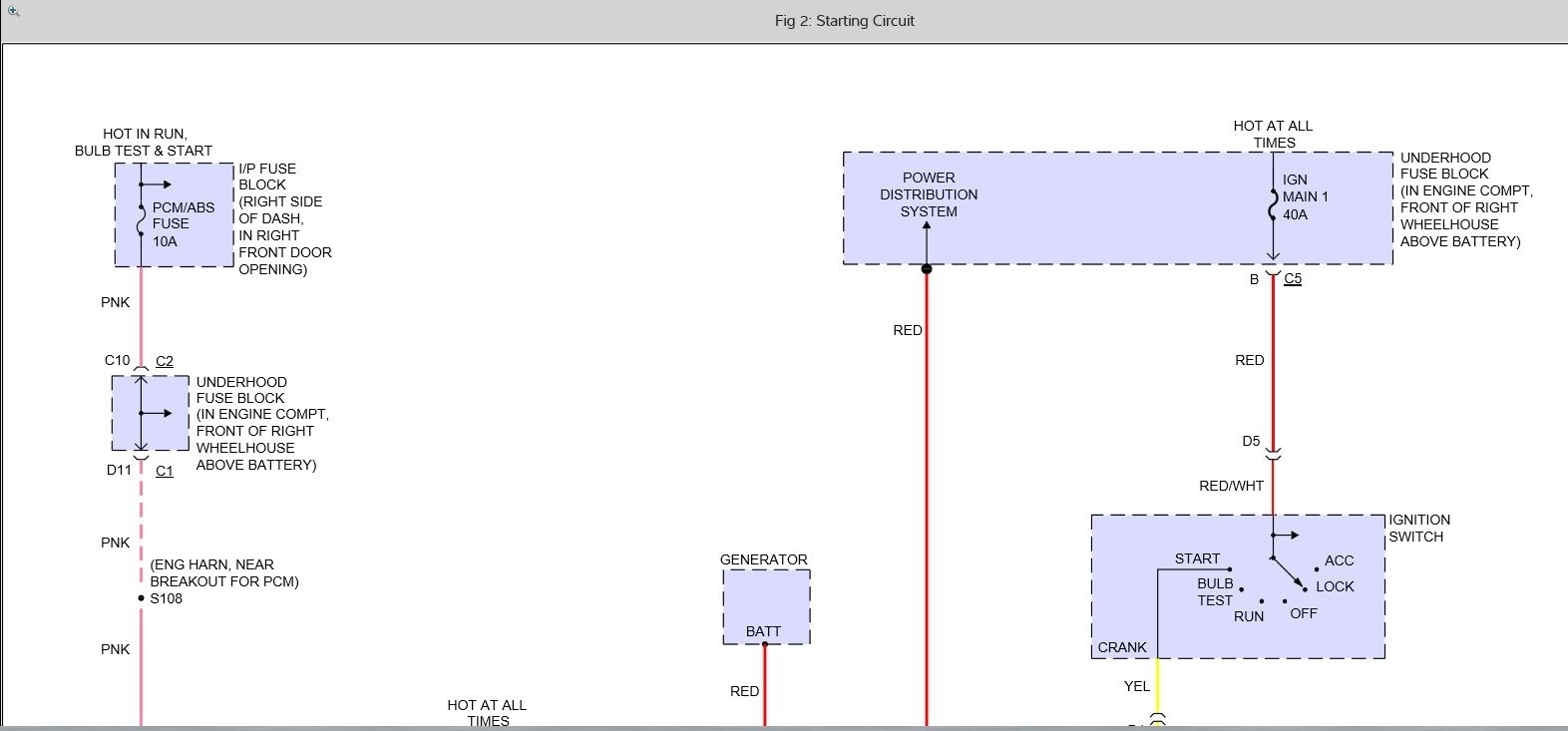

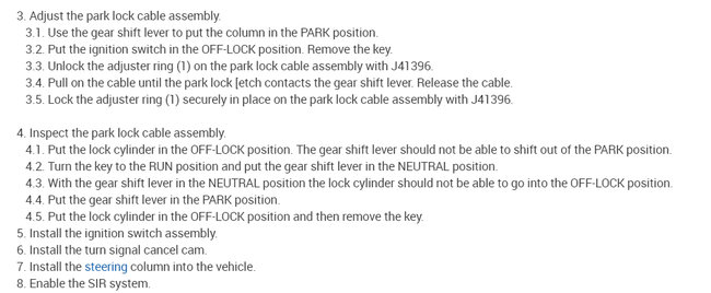

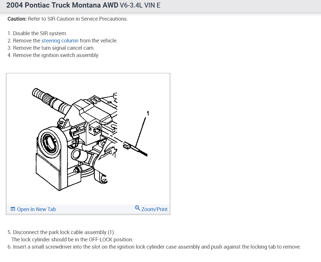

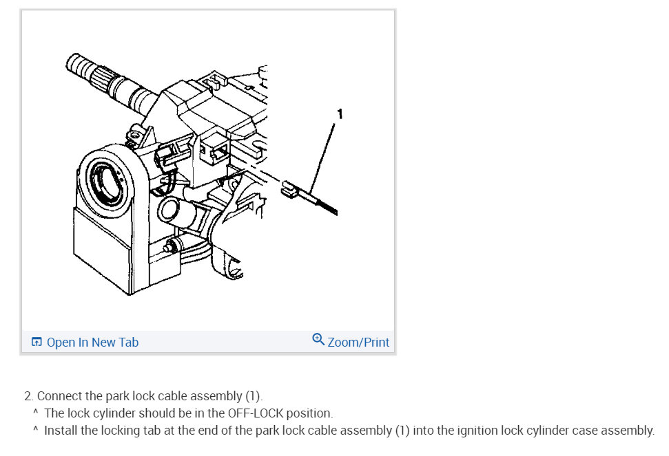

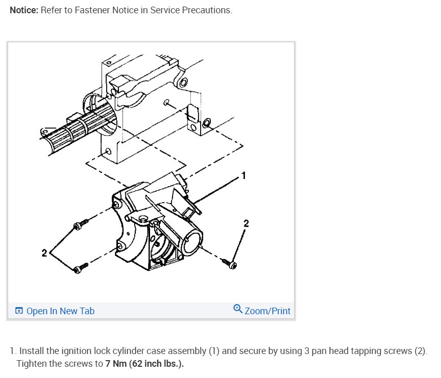

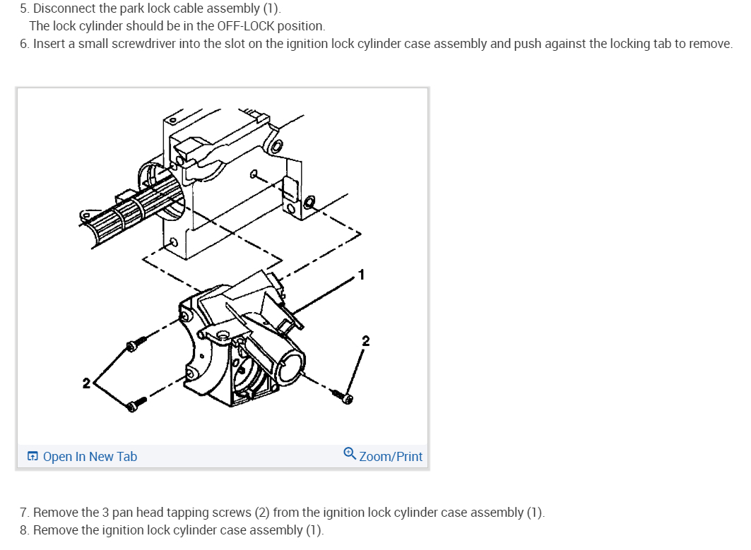

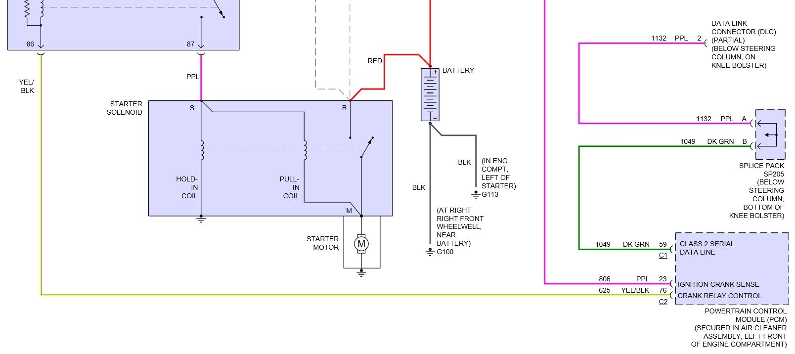

I replaced the Ignition switch cylinder and it was fairly hard to get out so i took a hammer/flat head screw driver and beat the cylinder out. once i installed the new cylinder switch the ignition on the i had power to lights radio but not the instrument cluster. also the vehicle will not start.
