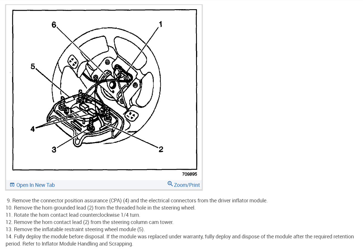

I have to remove the airbags?
Jan 28, 2020 at 9:33 PM

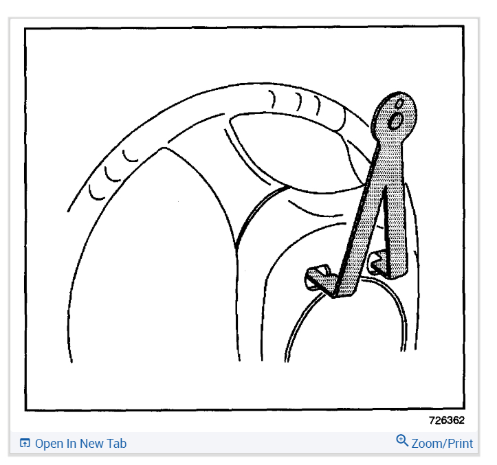

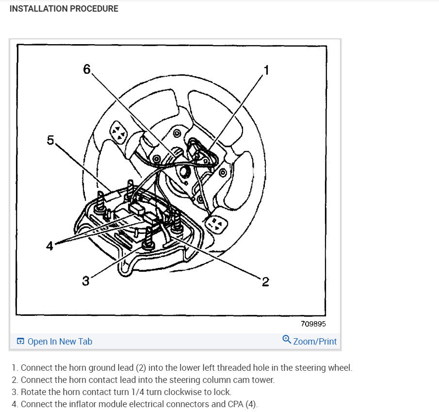

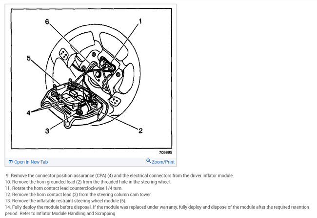

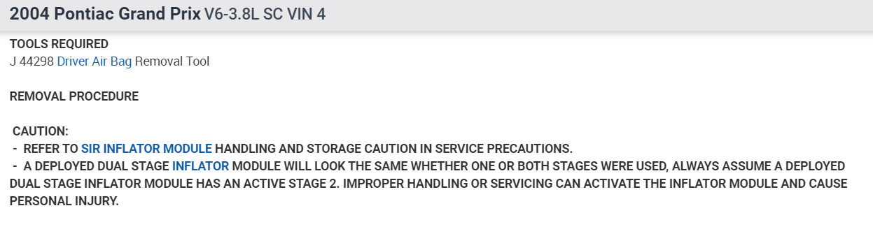

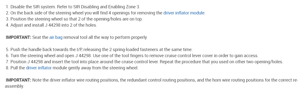

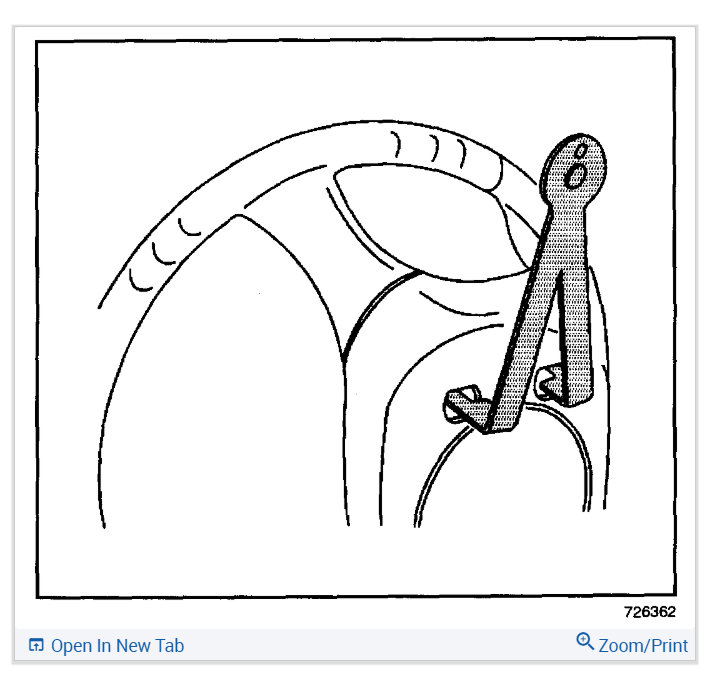

Here is how you can remove the airbag in the steering wheel. This guide walks you through the steps with instructions below to show you on your car:
https://www.2carpros.com/articles/air-bag-removal-steering-wheel
Check out the diagrams (below). Please let us know if you need anything else to get the problem fixed.
