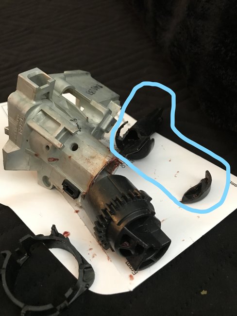

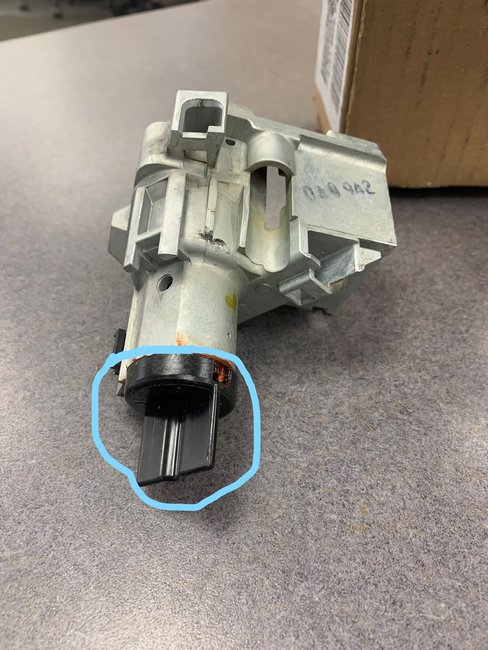

Hey Guys, I just ordered a part from a supplier in Arizona because the dealer said it is discontinued but I was able to get the contact for this supplier through the dealer. Anyway, the part I ordered was a ignition cylinder housing and one of the plastic pieces was broken that appears to go in where the ignition cylinder would go. My question is, do I need this piece or is it a dust cover or something? Please let me know. I have attached a photo of what it should look like and the one that I received.

the first one shows the broken piece with the blue circle and the second one with the blue circle shows the the piece in tact which is a new one they can send me if I do need that piece.
Jul 17, 2021 at 2:56 PM
SQM
  • 6,383 POSTS
Unfortunately you do need that black plastic piece. It actually engages the cylinder. So yes have them send you the replacement.
