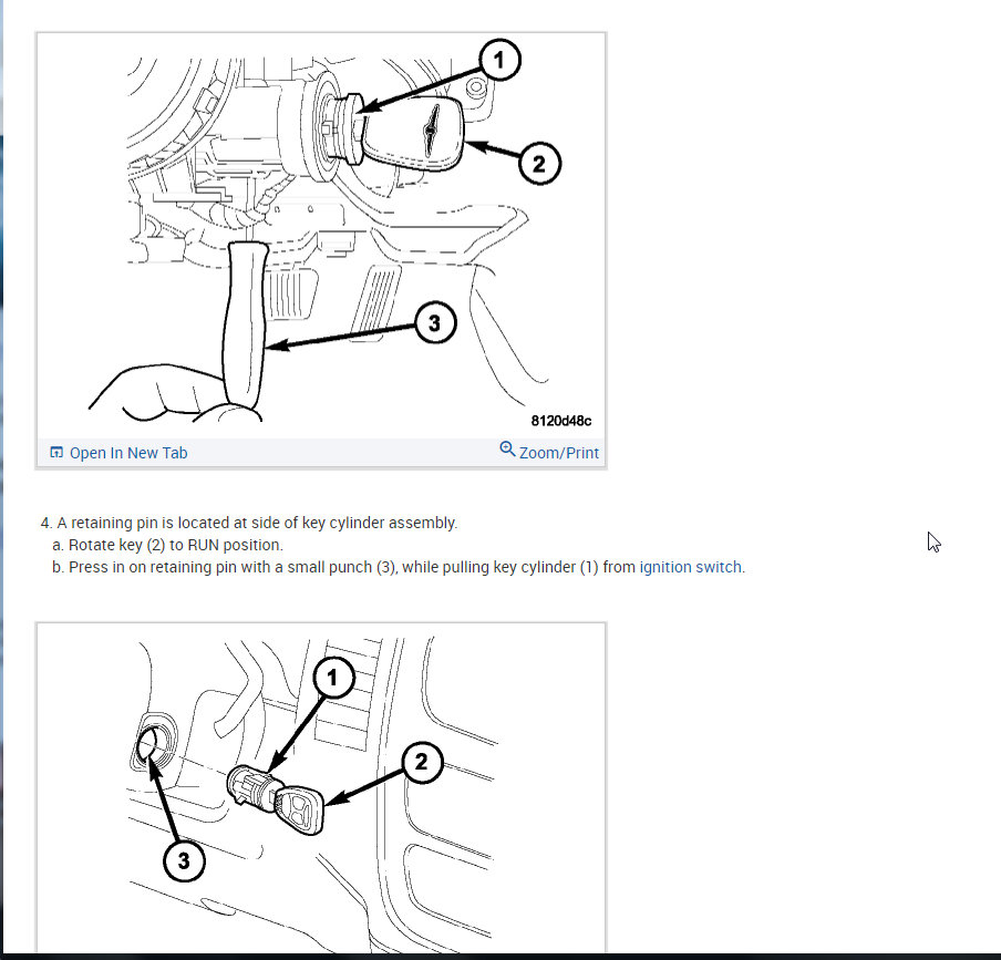

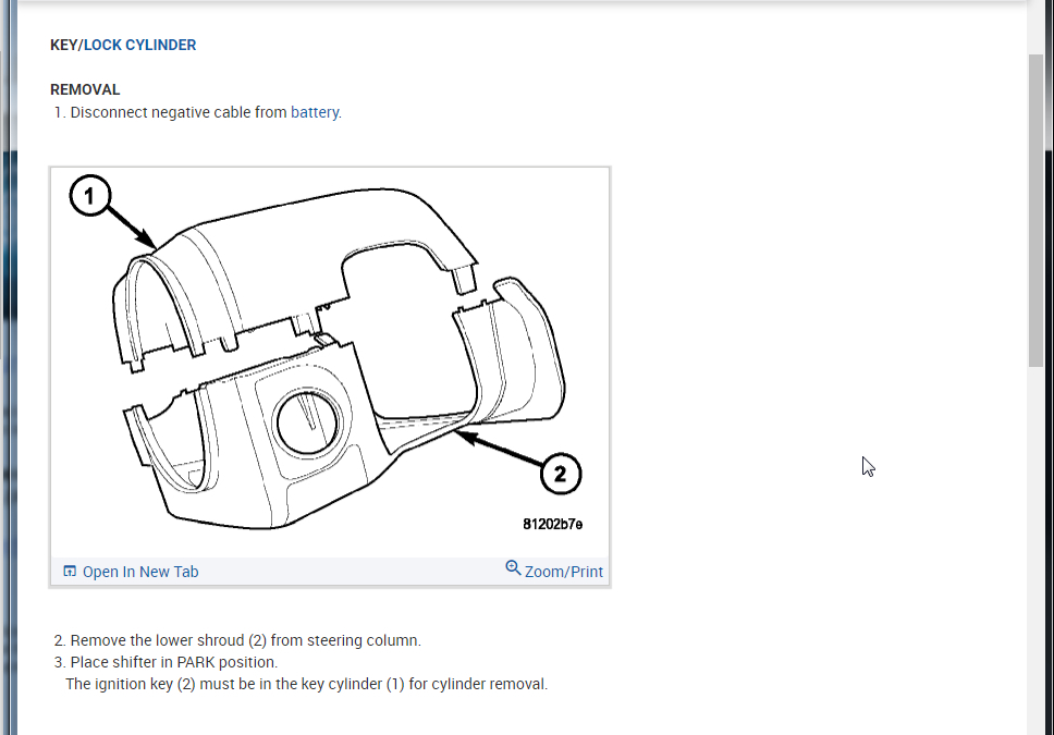

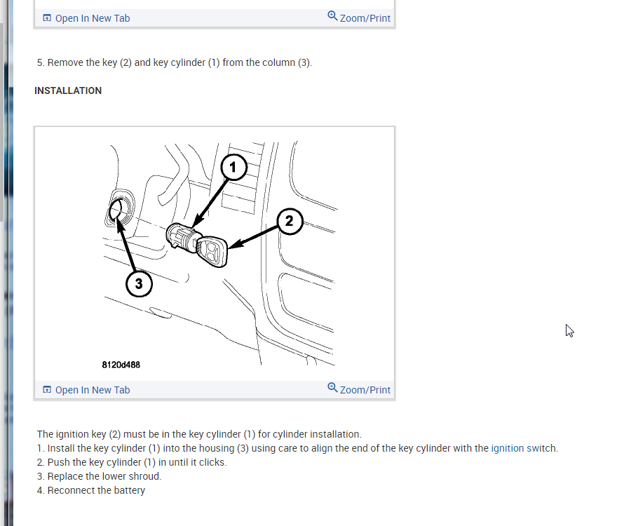

I attached the process below for replacing the cylinder. Clearly you need to turn the key to do this but I would not drill it yet. Let us know if this works. If not we can try and figure something else out but drilling it should be the last resort.
