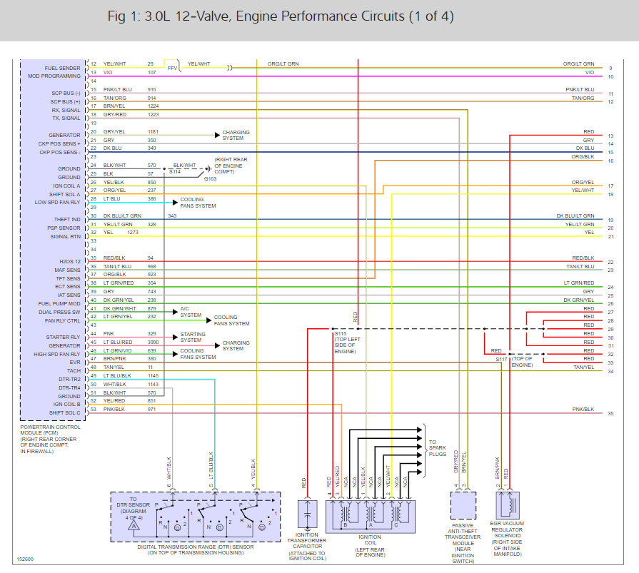

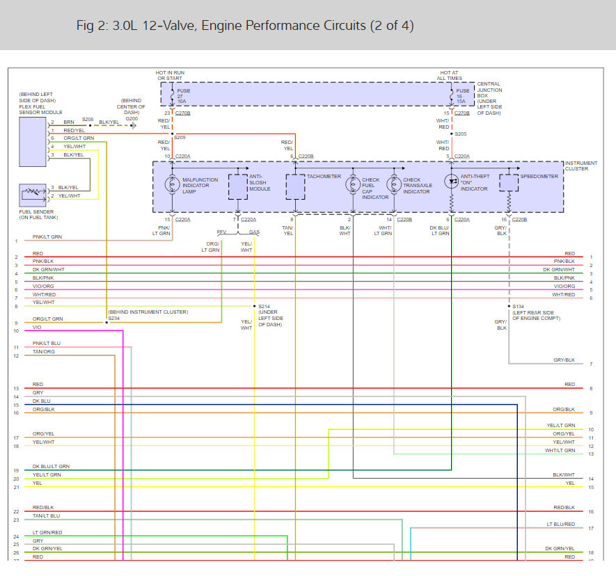

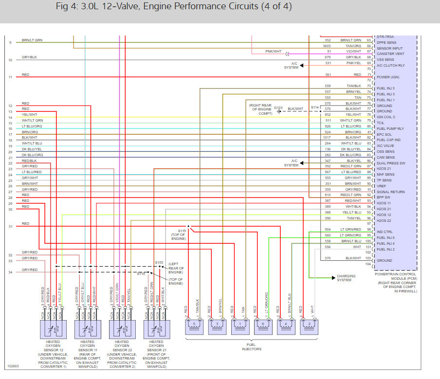

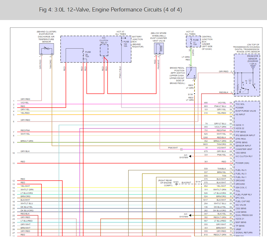

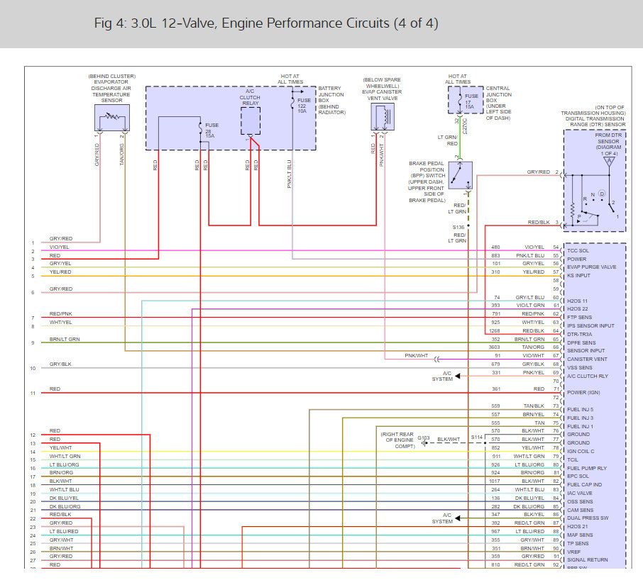

In 2002 this vehicle did not have a separate ignition control module. Instead, it was controlled by the power control module (PCM). The following information is direct from Alldata regarding the ignition system:
Integrated Electronic Ignition System
The Integrated Electronic Ignition (EI) system consists of a crankshaft position (CKP) sensor, coil pack(s), connecting wiring, and PCM. The Coil On Plug (COP) Integrated EI System uses a separate coil per spark plug and each coil is mounted directly onto the plug. The COP Integrated EI System eliminates the need for spark plug wires but does require input from the camshaft position (CMP) sensor. Operation of the components are as follows...
With that in mind, can you tell me if you have checked for trouble codes? Here is a link that shows how it is done. If there are codes saved, it may be very helpful in helping you narrow this problem down.
