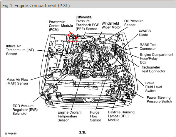

Cannot find it, not located where the manuals say. No fire issue. Cranks but does not start. Already replaced fuel pump and pump is working.

If it is the PCM (Power train Control Module) you are speaking of I have attached a picture of it and circled it in red. It is located right side of firewall. Hope this helps and thanks for using 2CarPros.
