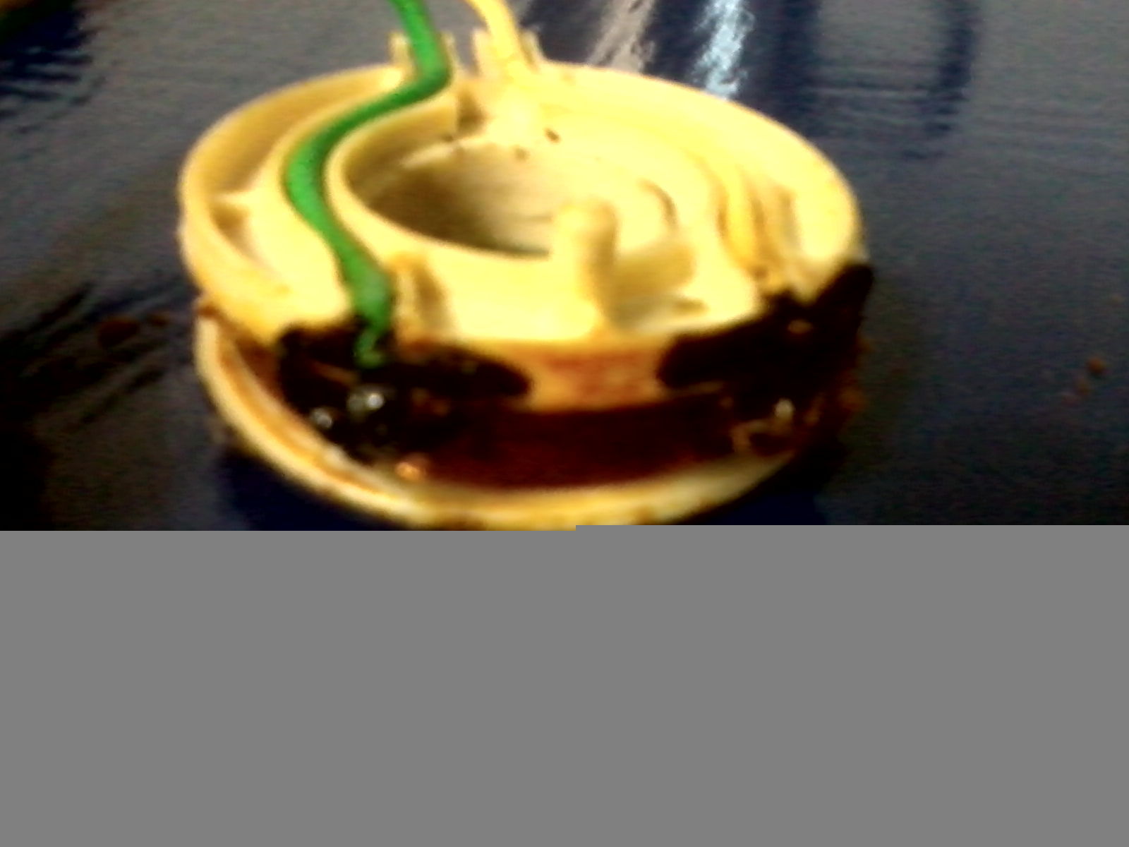

Thanks for your advise last year. Truck ran great for 5 months, no problems what so ever....until now. Would not start one morning, turned over just fine just not starting. Removed air cleaner, sprayer carb cleaner into intake (opened throttle plates) same results no change. Pulled ignition module, had tested at Advance, came back faulty. Replaced with new one one turn of key, same results, removed new module, had tested, faulty. Advance replaced, no charge. Installed replacement, after checking pick-up coil. Pick-up coil was bad also (burned areas). Installed new pick-up with new module, one turn of key.....module gone. I'm assuming there is too much current somewhere. 11.6volts going into external coil
