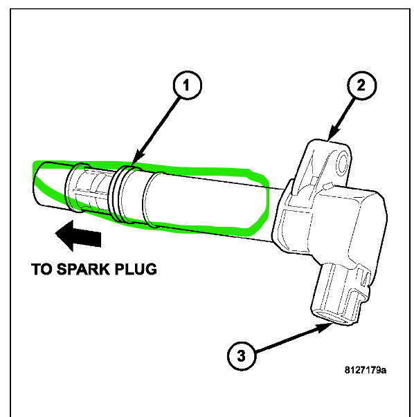

I have a boot stuck onto the coil and can't remove it.

Hello, you're trying to remove this section of the boot off of a coil. Or is it stuck on the spark plug? The boot section of these coils is not designed to come apart as stated in service info, if it's stuck on the spark plug, the coil may have overheated and the boot melted, these are known for failing. Sometimes when they short out, they also damage the engine computer (ECM) because they are a 2-wire coil. I have replaced ECMs due to these shorting out causing excessive current flow through the computer.

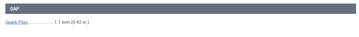

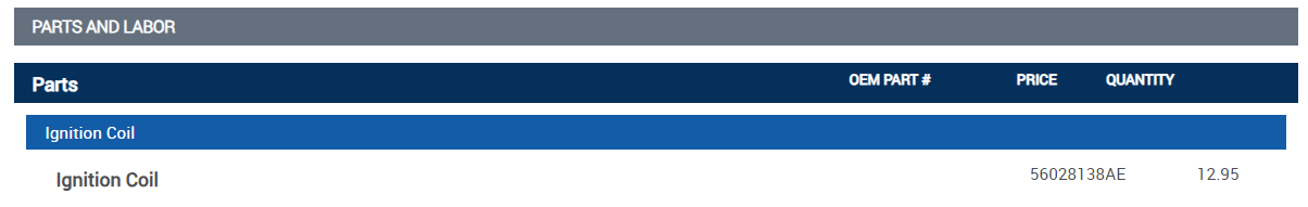

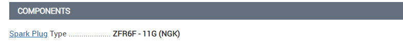

Here is the OEM Ignition Coil part number, the spark plug part number (they are NGK so it's a good plug) and the plug gap.
