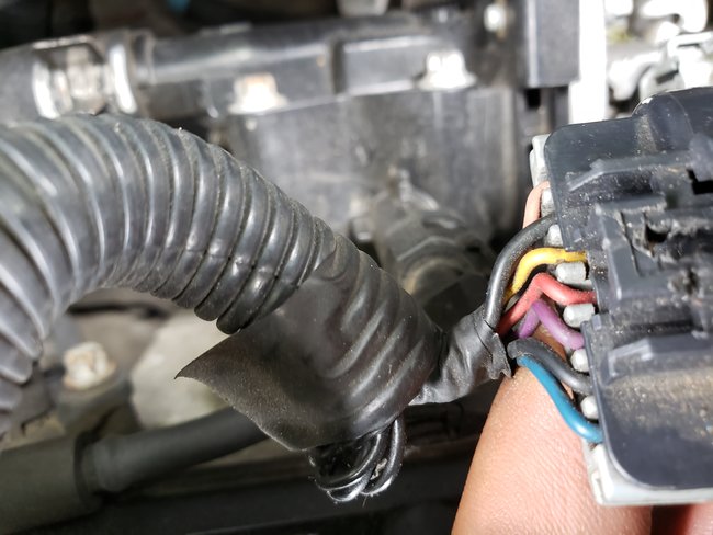

Sorry for misinformation. Here's a pick of what I'm trying to test whether that is voltage or ohm's. I believe the harness my have a short in it. I tested a few terminals on the harness with ohms only, 1. Ignition turned to on position a couple terminals read black wire read 0.44, purple wire read 0.45.

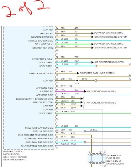

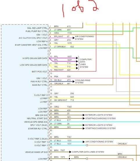

First, I attached a picture of where all the wires go from that connector. Next, are any of these codes active?

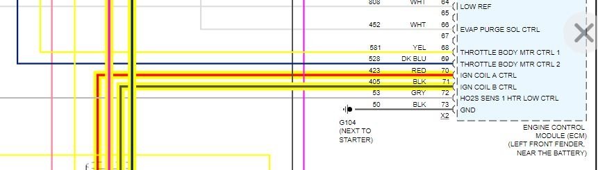

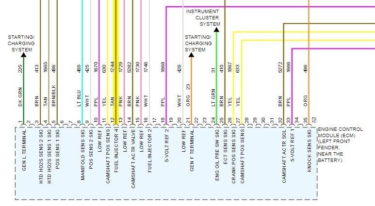

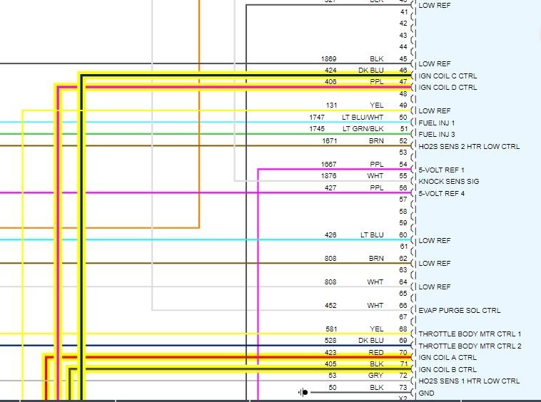

What specifically is going on with the vehicle? Also, I have no idea why the pics didn't attach. I'm going to try again. Let me know if you get them. I highlighted the wires between the ignition control module and the engine control module.

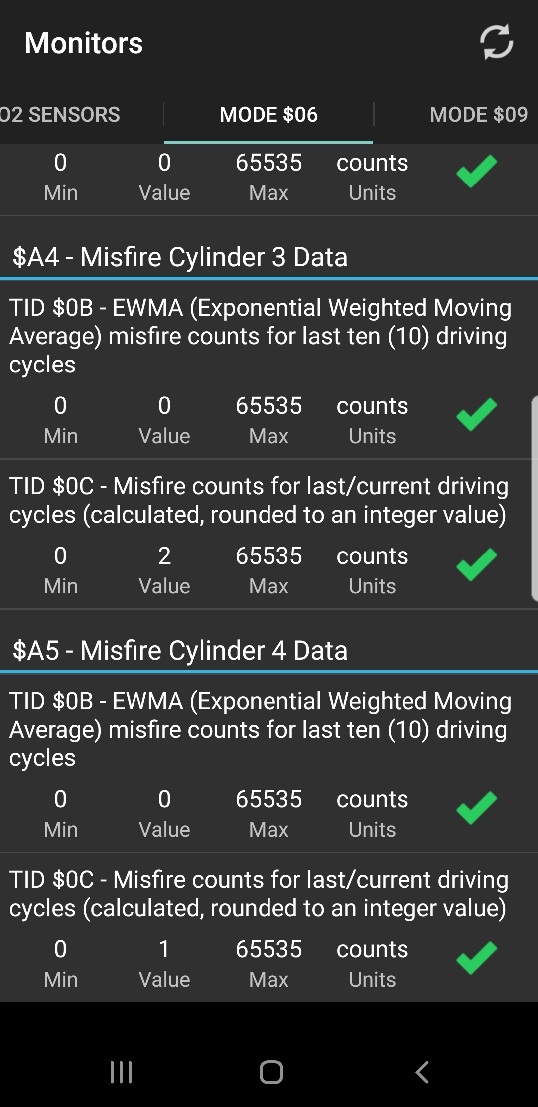

Thank you. it's a misfire fire. I have new spark plugs and coil pack, compression, good new fuel pump as well. I'm checking for short to coil pack as well as coil pack for defect.

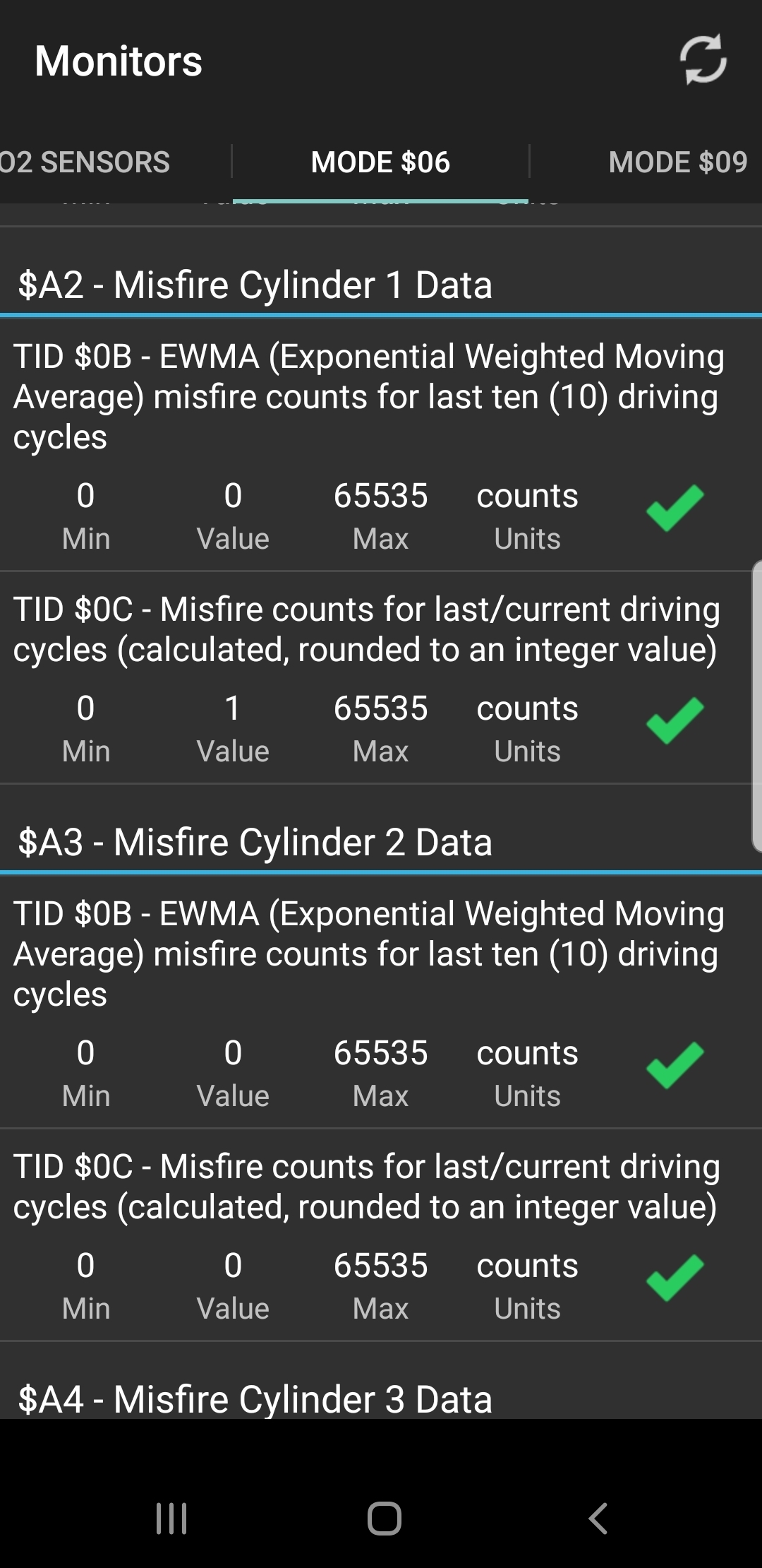

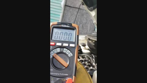

Joe the first test cracking was for Terminal G. Second crank test was for terminal F. Third crank test was for terminal E. Fourth crank test was for terminal D. All test was done with a probe on ground B and a probe on each terminal mention above. Also I attached a few pics of misfires with the crank test in mind, not a lot of misfires is present due to disconnecting ignition coil harness. Lastly air to fuel ratio reads 1.7.1 I'm not running rich no black Sut from tale pipe. If you conclude my readings are not normal. I will have a conclusion to misfire and air to fuel

Misfire pictures.
Oct 14, 2020 at 2:47 PM
The readings look okay. What is the knocking?

Test was not preformed with positive probe on each ignition coil terminals and negative probe on ground wire on harness. Test was preformed on harness only.
BOBBYPUE DOPEHI
  • 40 POSTS
Joe was this test preformed correctly. I put the DMM probe negative on the black ground wire attached to harness. Then I put the DMM positive probe, on dark blue wire on the harness. Then the car was cranked and the same steps preformed for the, black, purple, and red wire on harness?
Yes, that is correct. You want to use the ground provided. Interesting... is the check engine light even coming on?

The codes are related to the IP and air bag. There are multiple wires from the ECM and Ignition. Also, I can upload schematics, but there are a ton of them, so I need to narrow it down. Also, there are different schematics based on US and Mexico, so let me know what I can do to help.

2CP-ARCHIVES
  • 4,540 POSTS

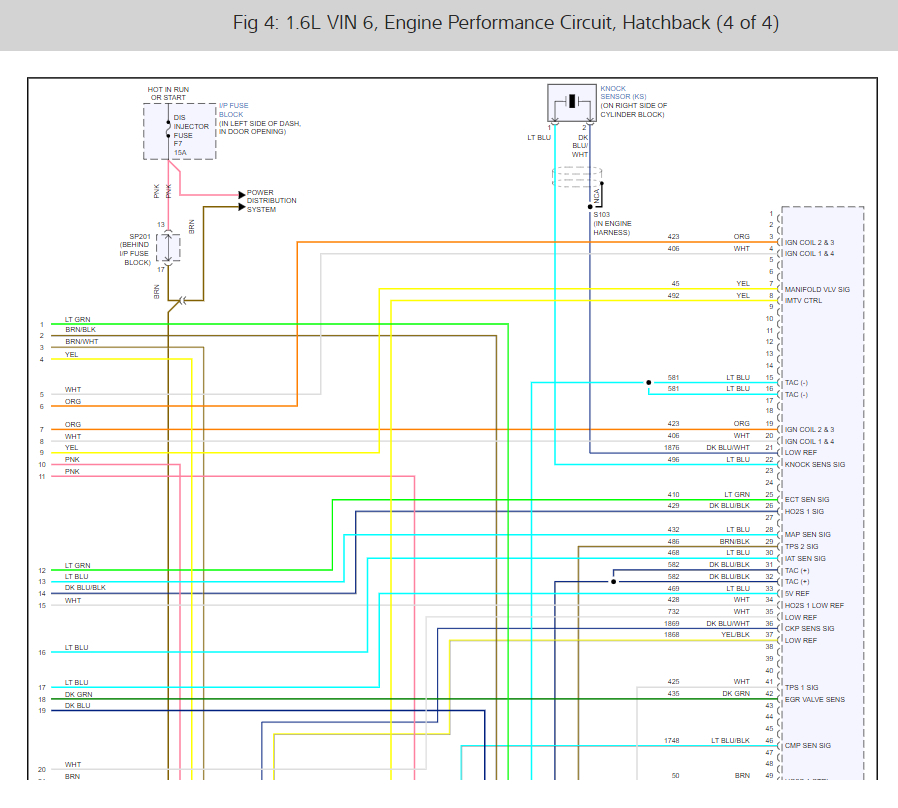

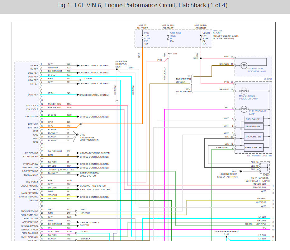

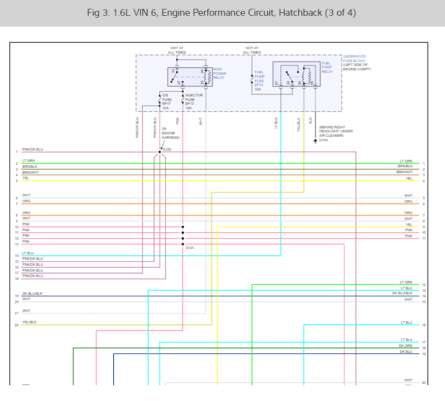

Hi! I am seeking a wiring diagram... an ECU pinout, or ecu wiring schematic for the 2008 Chevy Aveo LS sedan, Manual transmission. I have called dealers, who told me to call GM, who told me to call a dealer, who told me they can't give out wiring schematics. So, I've been getting the runaround... all I need is a pdf or jpeg of the ecu wiring. Can ya'll please help? I appreciate the time and any information.
Oct 14, 2020 at 2:47 PM (Merged)
SATURNTECH9
  • 30,869 POSTS
Here is the wiring diagrams for the engine ECU and a guide to help you check the connections.
Check out the diagrams (Below). Please let us know what happens.

Welcome back:

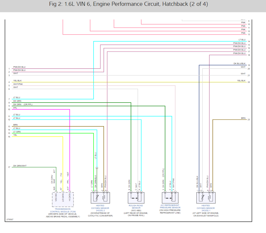

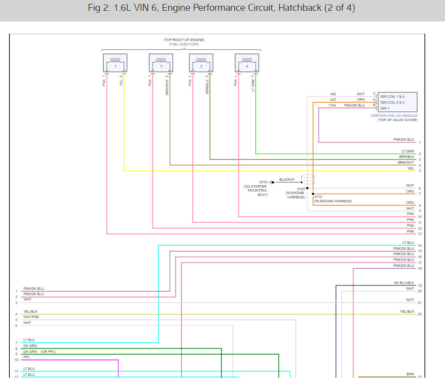

Honestly, there are so many different variations based on specific components. There isn't one that covers the entire vehicle. I would be sending hundreds.

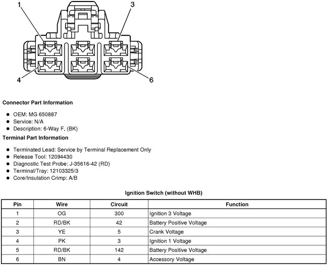

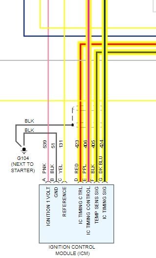

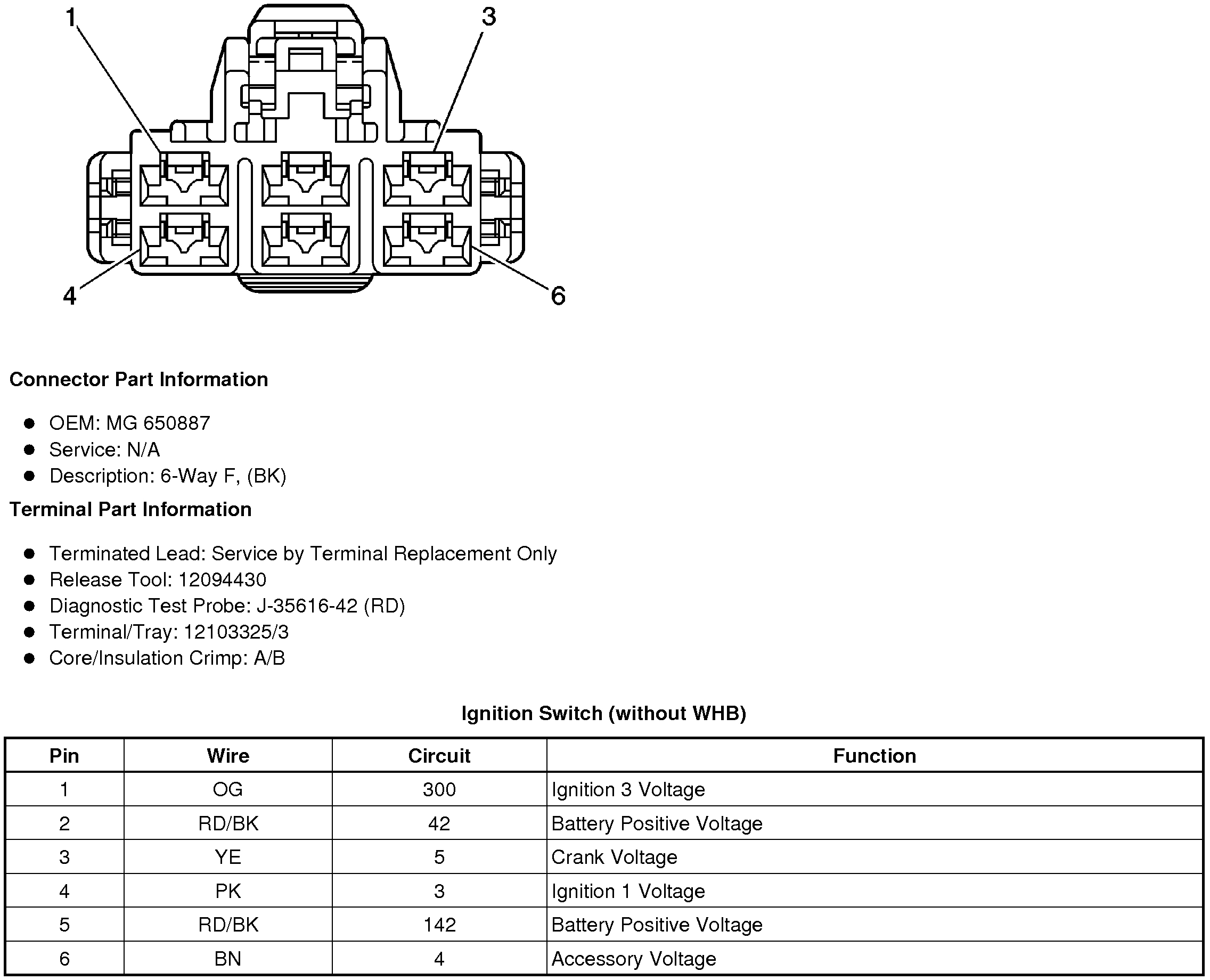

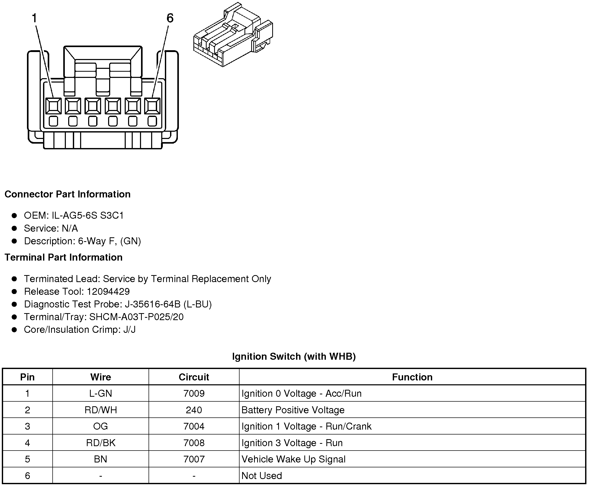

Ecm, and ignition switch wiring under dash board?

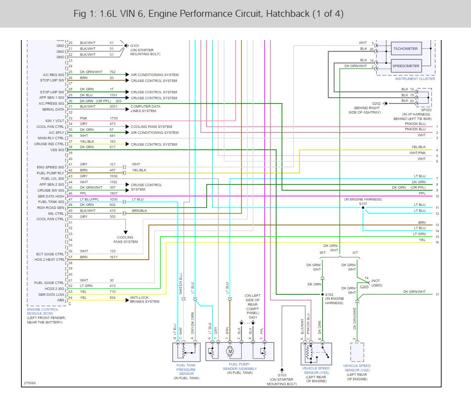

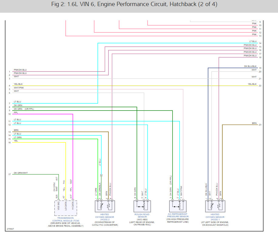

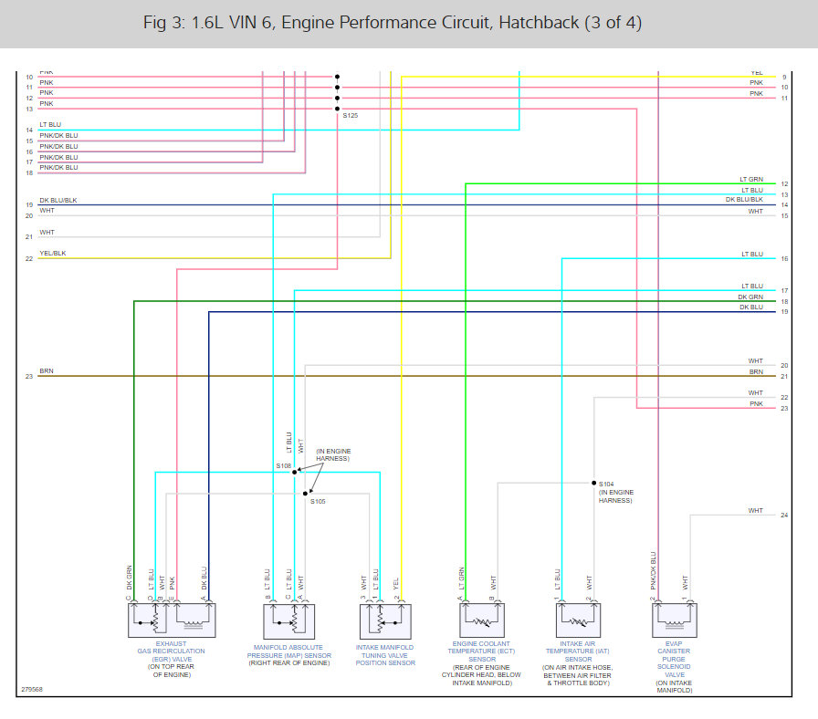

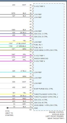

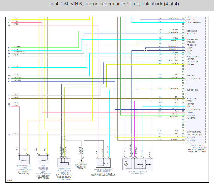

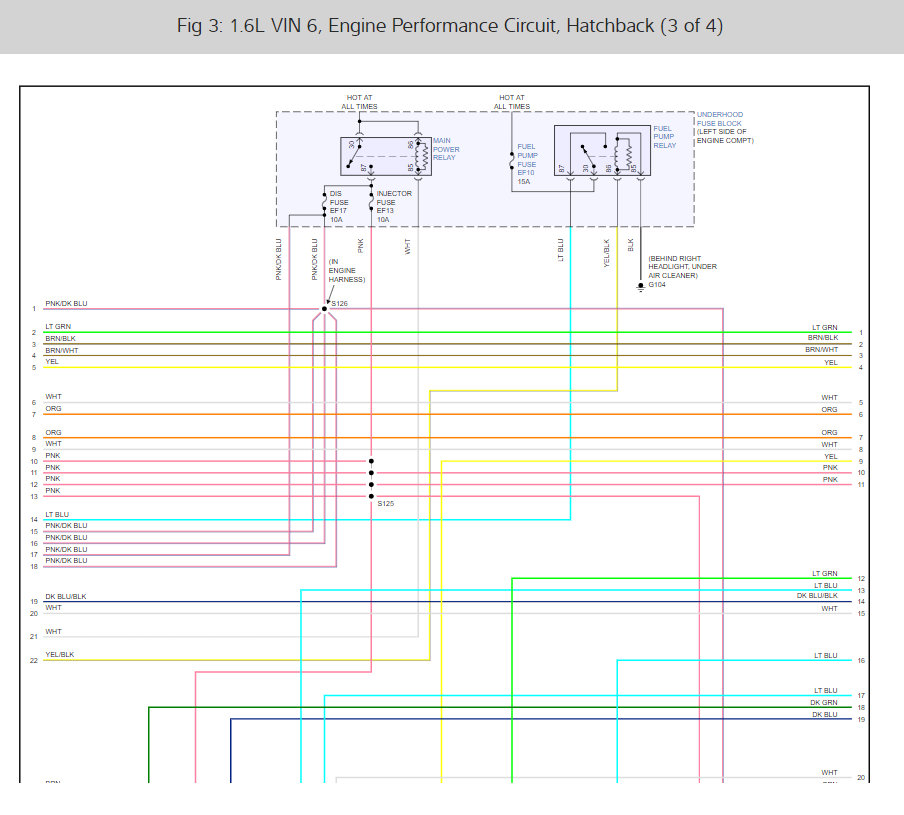

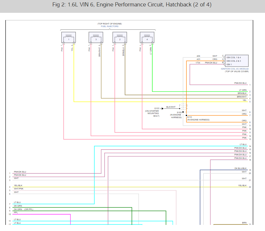

Let me know if this helps. There are multiple pics. The last 2 are the ignition pins. Note, one is for with and one without WHB. the last one is without (pic 6). Basically "with WHB" requires a CANdi interface module for the Tech 2 to communicate with. Nothing more than an industry protocol change in OBD2 interface which requires the module to work.
I hope this is helpful.
