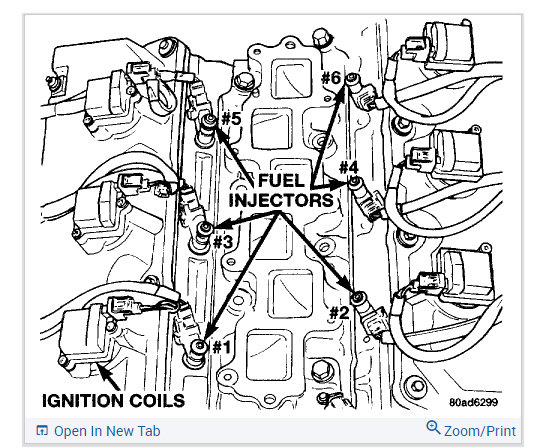

Your engine has what is called ignition coil on plugs. That means each spark plug has it's own coil. So how did they confirm that the coils are not getting spark? Did they remove one and hold it against the block and crank the engine?

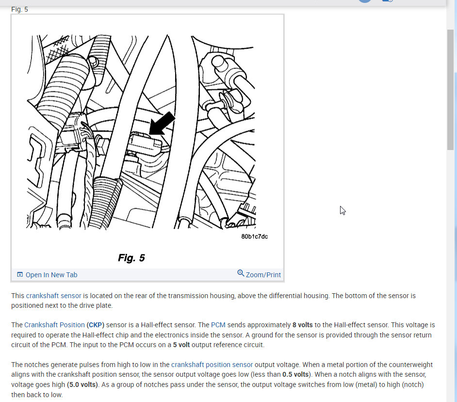

If the engine was running prior to this then we need to check and make sure they didn't unplug the crank sensor or something else related to the ignition.
Clearly these components should not cause this so we have to assume they unhooked something.
Let us know this info and we can go from there. Thanks

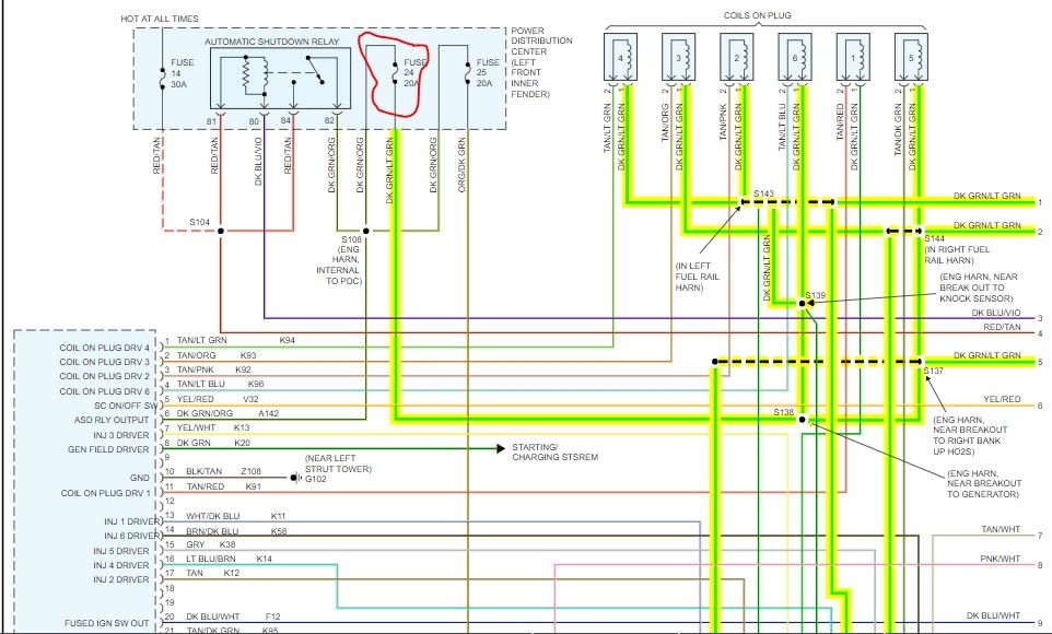

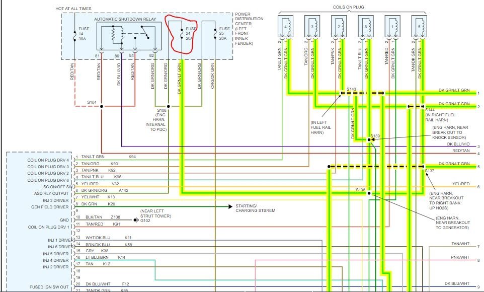

Good evening,
I attached a wiring diagram for you of the system.
Did they verify power to the fuse I circled on both sides?

Okay, did he check for power to the coils?
The fuse test was not a visual test, it is a power test.
