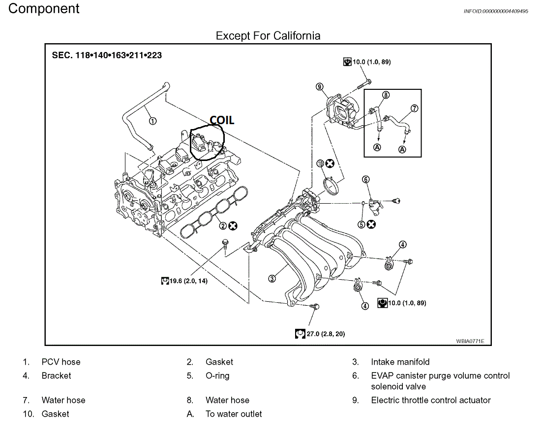

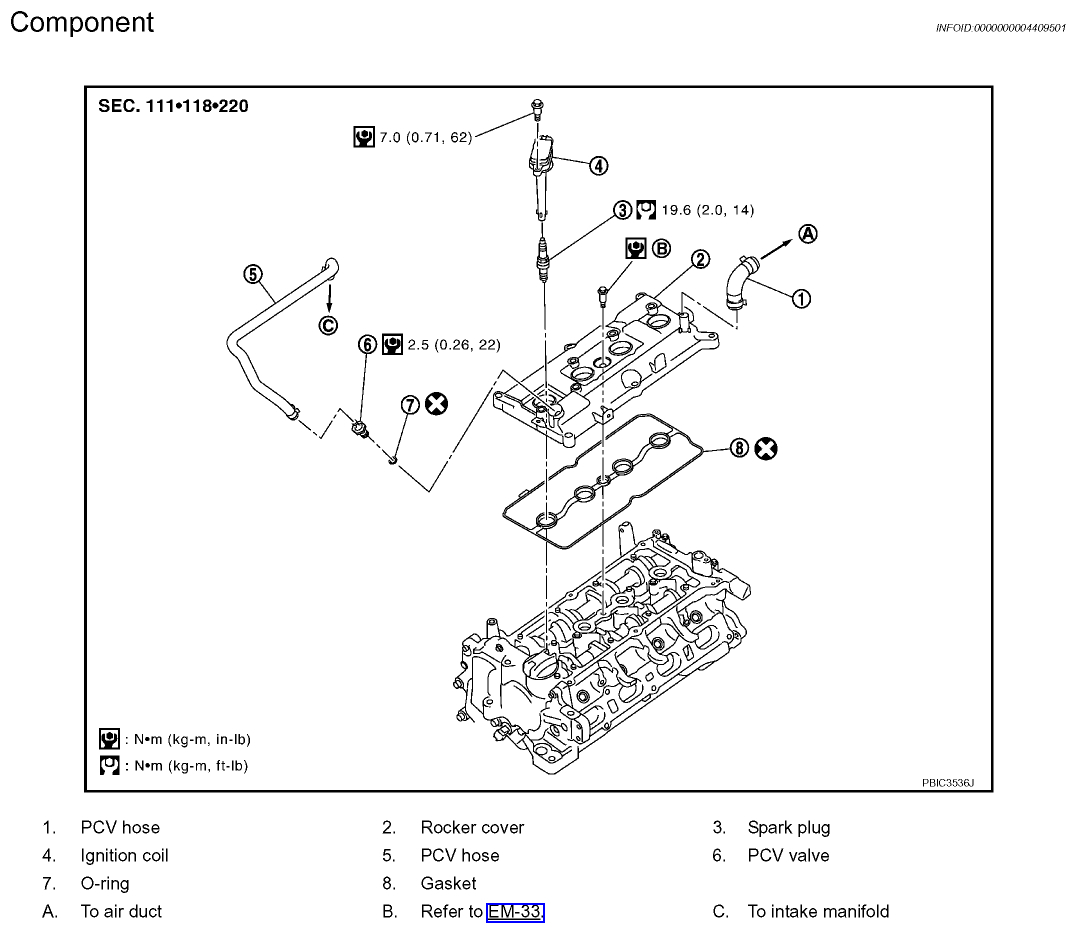

Are you able to send me pictures of instructions of where to find the location of the ignition coil?

You need to remove the intake manifold to access the coils.
