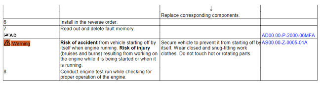

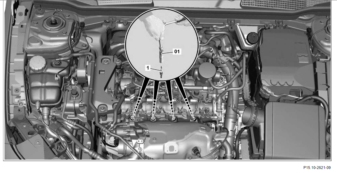

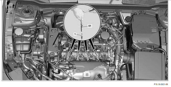

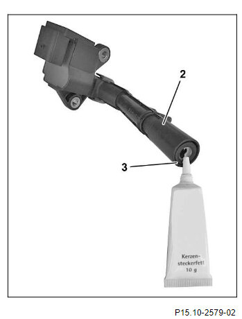

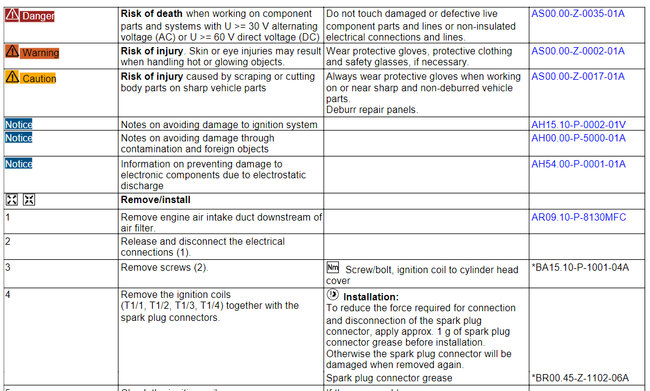

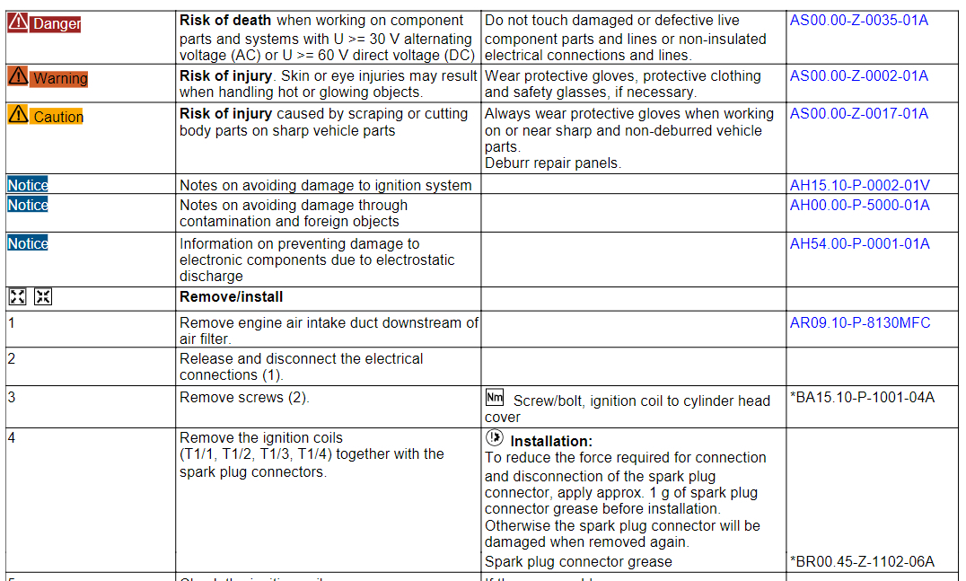

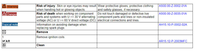

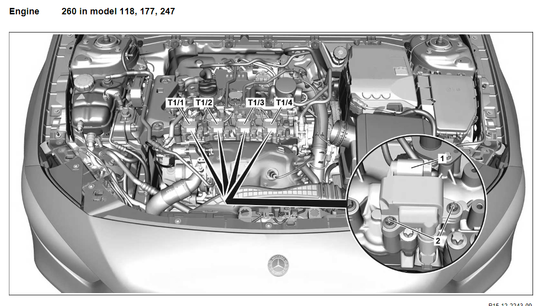

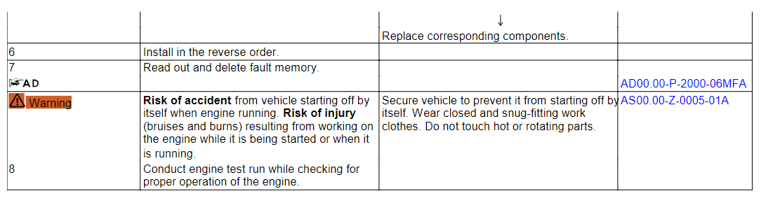

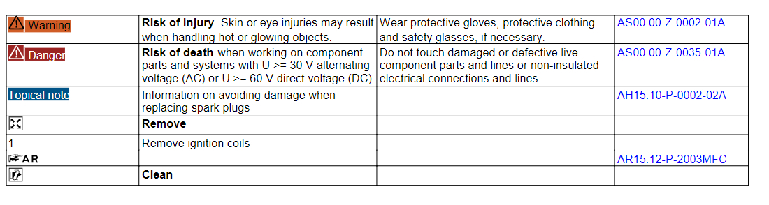

Here is how the job is done in the diagrams below: Check out the images (below). Let us know if you need anything else.
