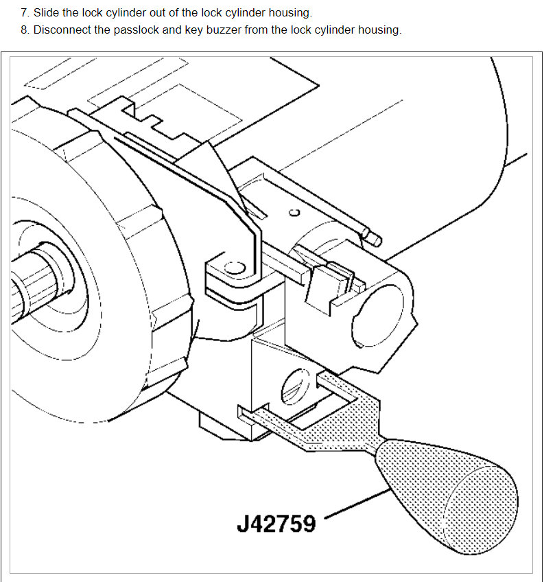

When I put my key inside the ignition the chime doesn't sound off. How can I fix this issue? do i need to replace the ignition cylinder lock or a fuse in the fuse box?
Jan 12, 2019 at 9:44 AM

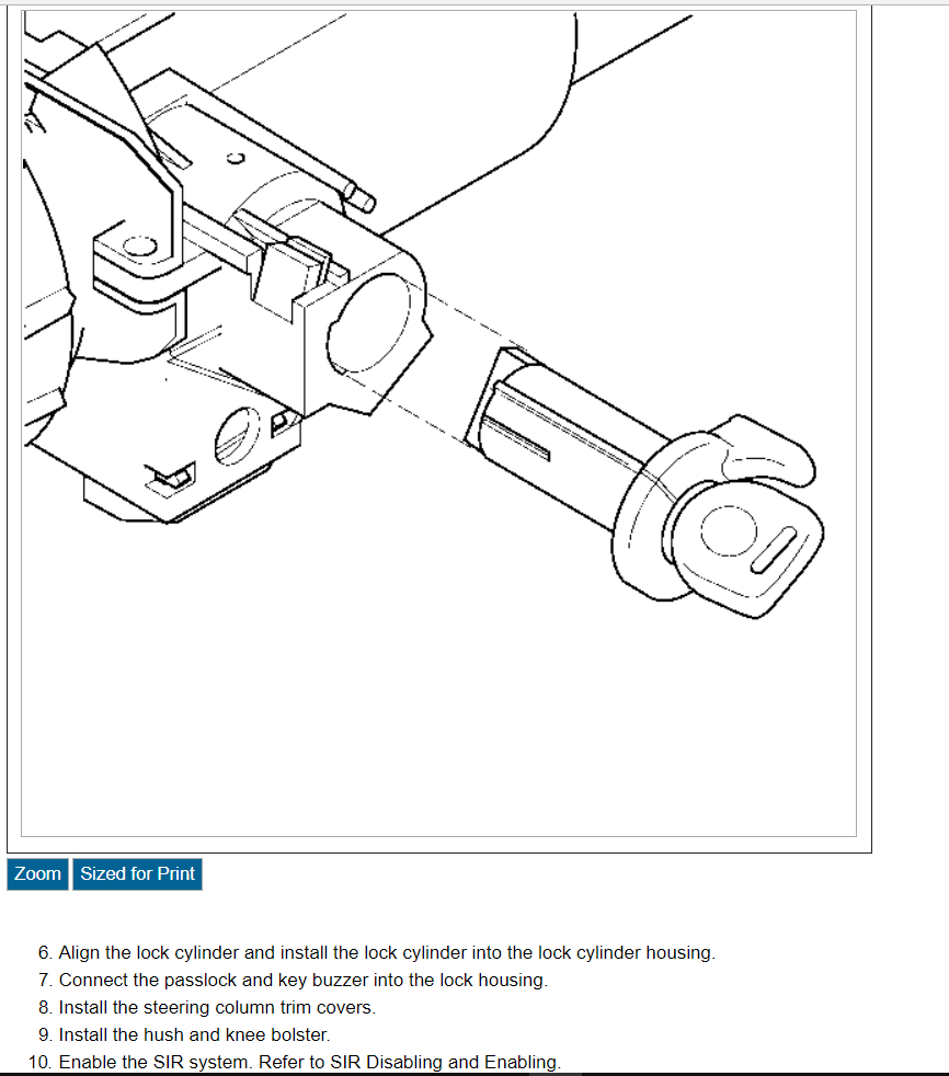

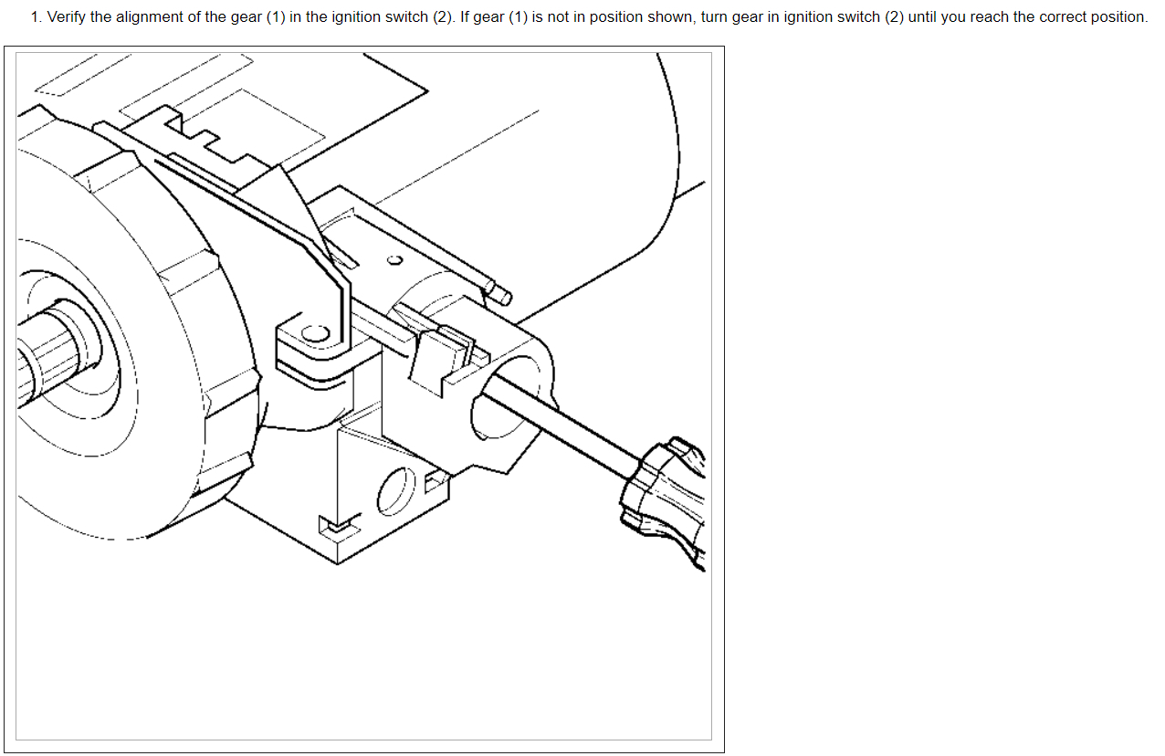

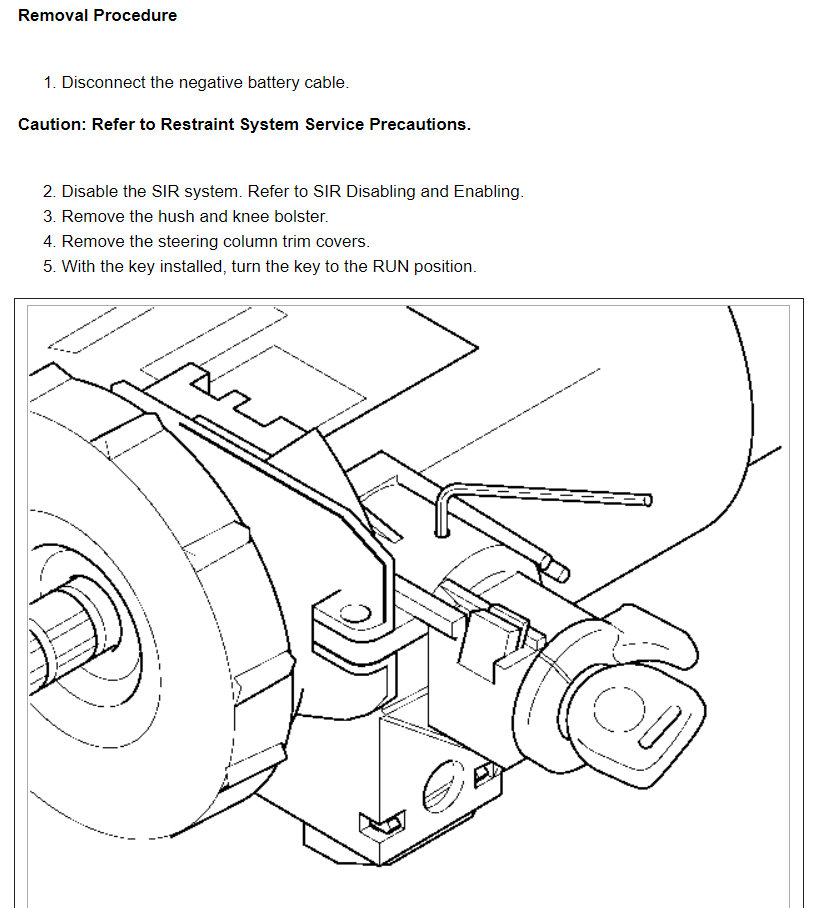

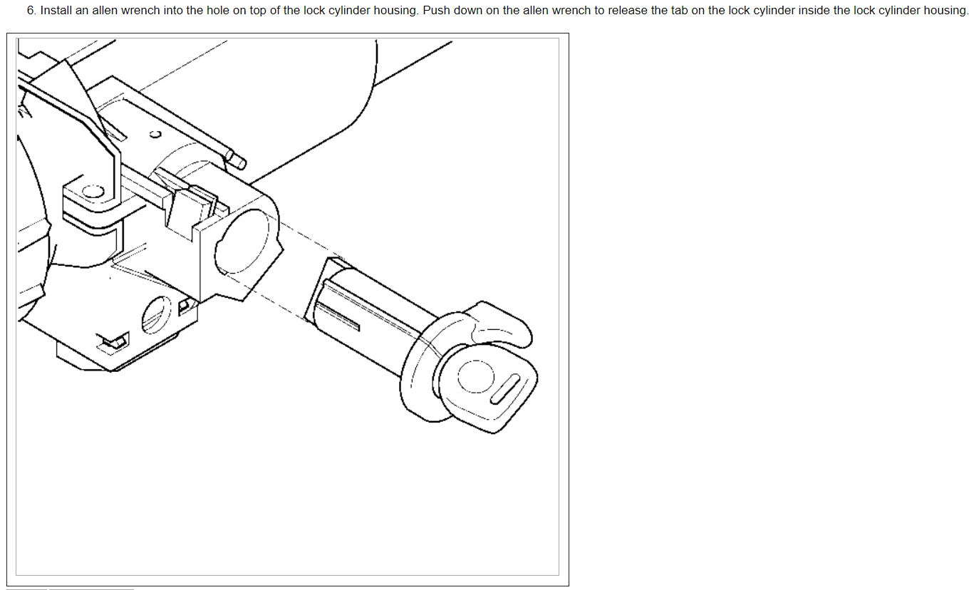

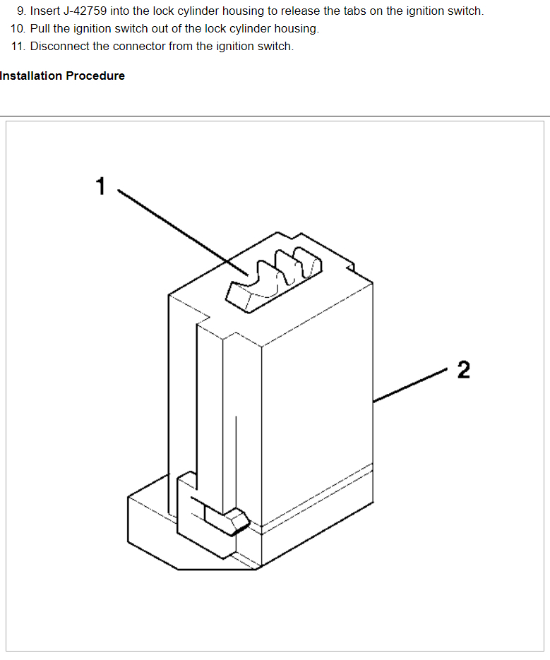

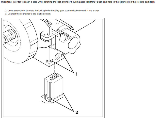

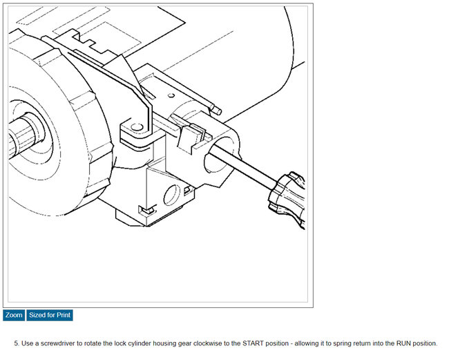

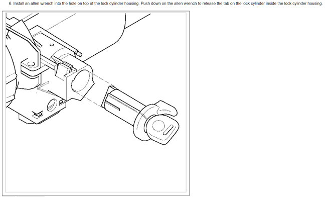

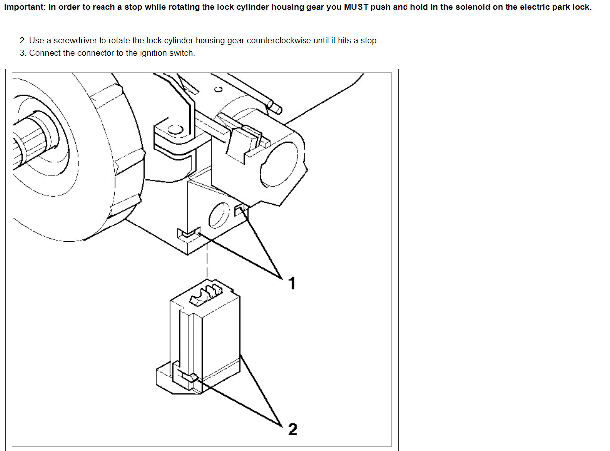

There is a small switch inside the tumbler that sounds like it broken or is getting bad connection. I would try contact cleaner inside the tumbler first and if that doesn't work here are diagrams to help you change the ignition tumbler out:
Check out the diagrams (below). Please let us know if you need anything else to get the problem fixed.
