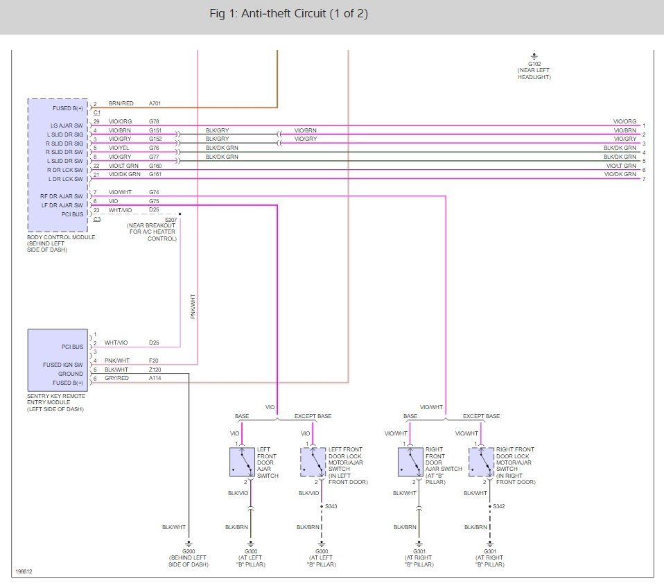

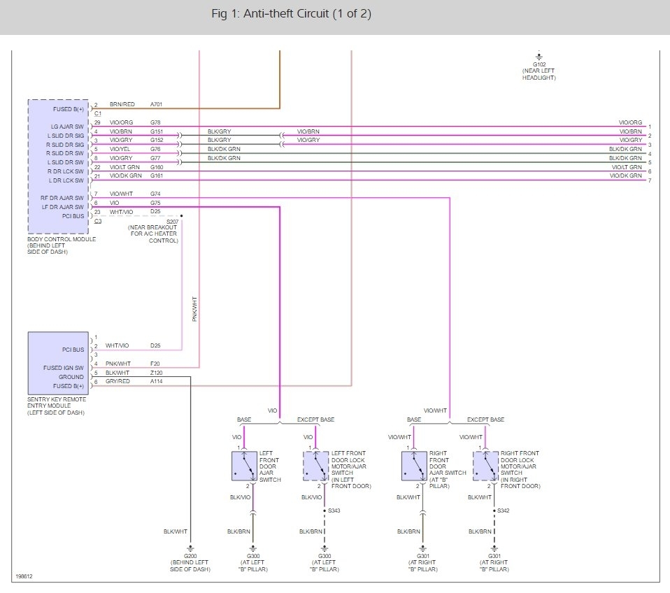

Yep these cars have a problem with the BCM module. You cant disarm it becasue it runs throughout the computer system.
Here is the wiring diagrams so you can see how the system is tied in.
Also is the alarm factory or aftermarket?
If the battery is weak it can make the alarms go off.

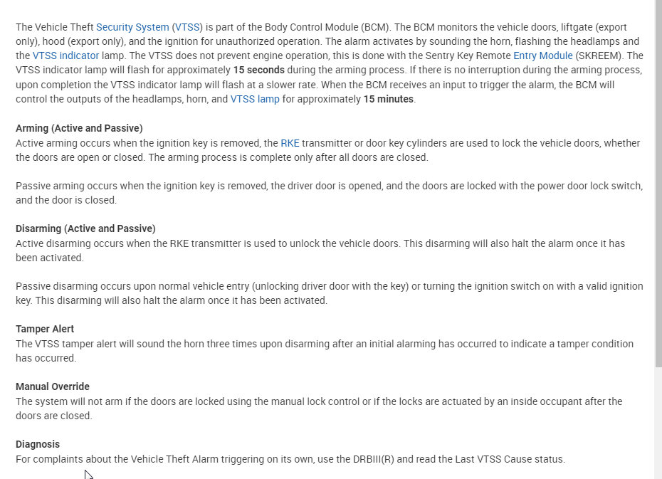

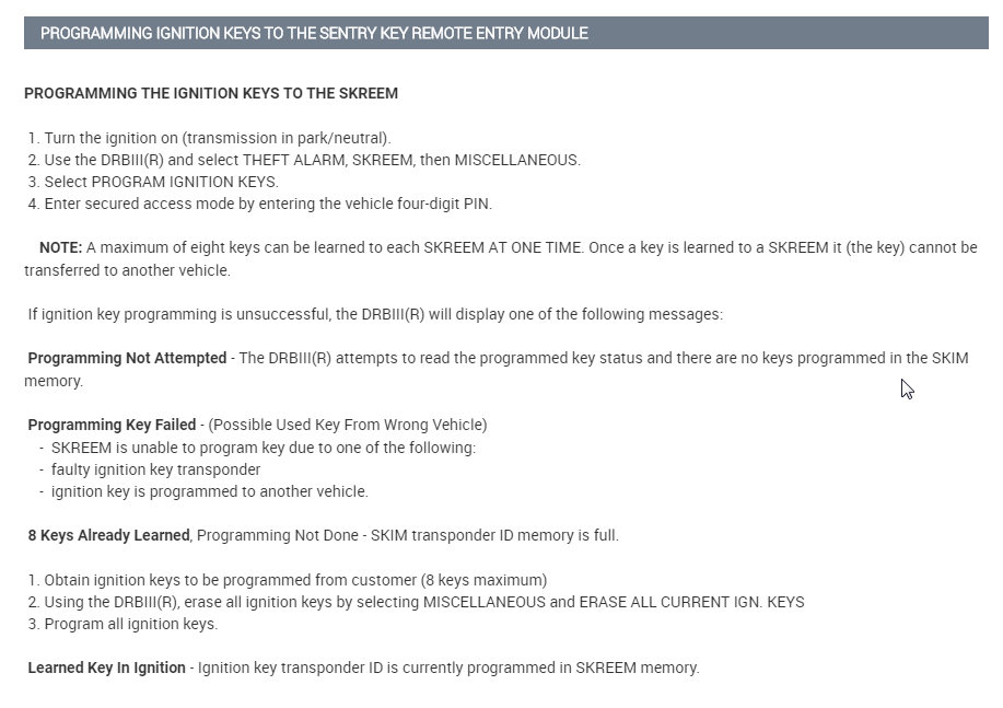

The BCM needs to receive the disarm signal in order to keep the alarm from going off. See the attached under the disarming. If you are not starting the vehicle with a valid ignition key then the alarm will not shut off. Unfortunately there is no work around that would be cheaper then getting a key that is programmed to the ignition. You can find lock smiths or other shops that have the ability to program these keys for cheaper then the dealer. Plus keys that will work can be found for less the $50.00.
I attached the information and the programming instructions that require a scan tool capable of doing it.

If the security light is ON when you try to start the engine you have one of a few issues. The key is not programmed into the system or the system itself is defective. With the light ON during the attempted stat the security system is actively disabling the starter and the fuel system.
There is no bypass, you need a factory level scan tool to talk to the anti-theft system and determine if it's the key, or the receiver that isn't operating or if it's in the BCM.
