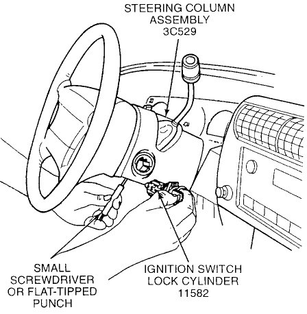

The Ford process (in the picture)starts with removing the battery ground
Then remove the lower steering column cover. Next you turn the key to the run position. As yours is broken you should be able to use the switch rod to move the switch to that same setting.

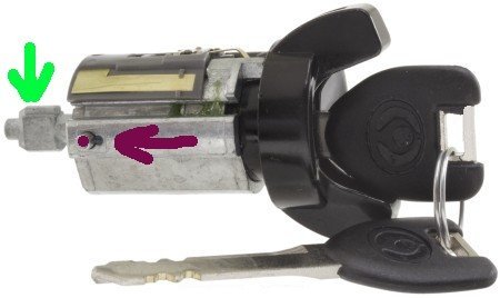

Next you use an 1/8" punch or stiff wire to push the retaining pin (purple dot and arrow) up in the hole in line with the cylinder under the column.
Then pull the cylinder straight out.
Now look at the green arrowed part. If it is broken off (which I suspect) then you will need to use tweezers or similar to remove the broken piece from inside the actuator inside the cylinder socket.
Then you reverse the process to install the new cylinder, hold the pin in while you insert it into the column and gently align the cylinder to the actuator. Be sure the pin locks in.
