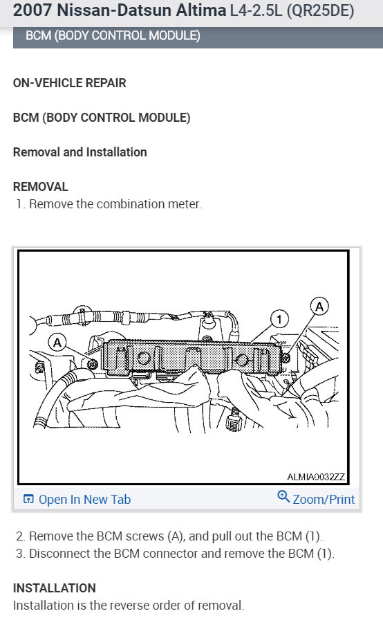

The security system runs through the BCM and it sounds like you may have corrosion on some of the terminals. I would remove the BCM connector and inspect it for water damage/corrosion. here is the location of the BCM so you can check it out. Check out the diagrams (below). Please let us know what you find. We are interested to see what it is.
